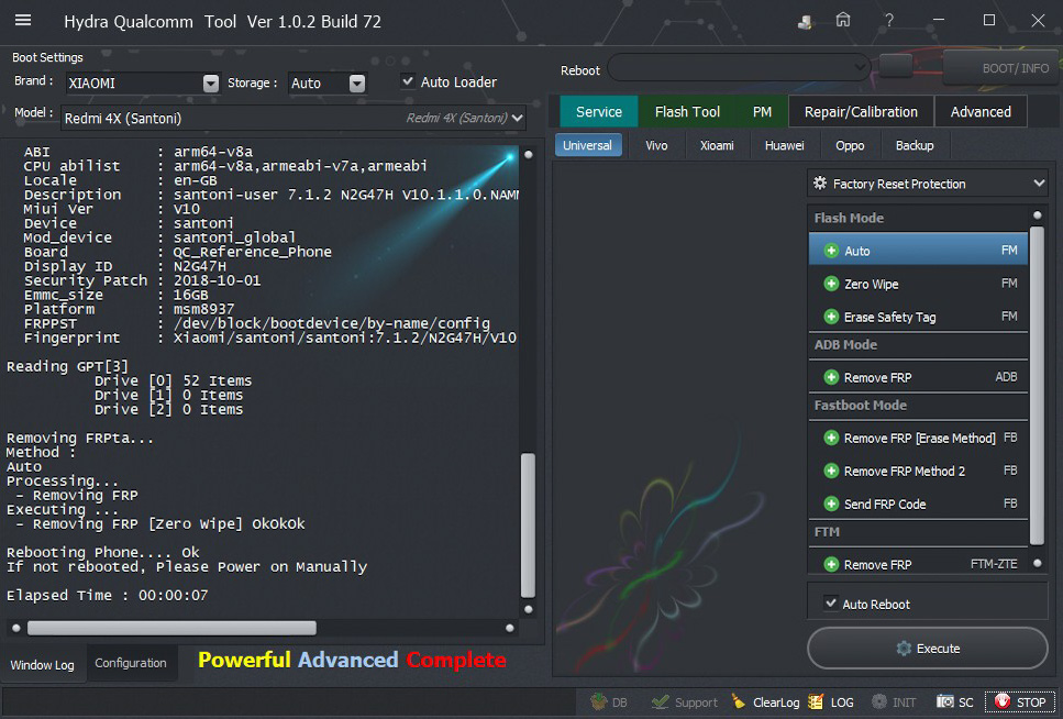

PreOperation Configuration
Brand : XIAOMI Model : Redmi 4X (Santoni) Storage : Auto
Loader: mi_1_9.mbn
Port : Auto
Connection :
FriendlyName :Qualcomm HS-USB QDLoader 9008 (COM5)
SymbolicName :\??\USB#VID_05C6&PID_9008#7&39d0cd62&0&6#{a5dcbf10-6530-11d2-901f-00c04fb951ed}
Getting device info..Ok
Device MODE : Firehose
Connecting to Firehose...
Ping.. Ok
Configuration......
Identifying Chip....
Ok
Chip Configuration :
MemoryName : eMMC
MaxXMLSizeInBytes : 4096
TargetName : 8937
Version : 1
*** STORAGE DEVICE INFO ***
Memory Type : eMMC
Block Size in Bytes : 512
Page Size : 512
Manufacturer ID : 21
Serial Number : 667655057
Firmware Version : 7
Product Name : QE13MB
Physical Partitions : 3
Total Logical Blocks:
Drive [0] 30535680[14.561 GB]
Drive [1] 8192[4 MB]
Drive [2] 8192[4 MB]
Protocol : Universal
Running : Ok
Phone Information.....
Brand : Xiaomi
Vendor : Xiaomi
Model : Redmi 4X
SDK : 25
Release : 7.1.2
ABI : arm64-v8a
Locale : en-GB
Description : santoni-user 7.1.2 N2G47H V10.1.1.0.NAMMIFI release-keys
Miui Ver : V10
Device : santoni
Mod_device : santoni_global
Board : QC_Reference_Phone
Display ID : N2G47H
Security Patch : 2018-10-01
Emmc_size : 16GB
Platform : msm8937
Fingerprint : Xiaomi/santoni/santoni:7.1.2/N2G47H/V10.1.1.0.NAMMIFI:user/release-keys
Reading GPT[3]
Drive [0] 52 Items
Drive [1] 0 Items
Drive [2] 0 Items
Removing FRPta...
Method :
Auto
Processing...
- Removing FRP
Executing ...
- Removing FRP [Zero Wipe] OkOkOk
Rebooting Phone.... Ok
If not rebooted, Please Power on Manually
Elapsed Time : 00:00:07
