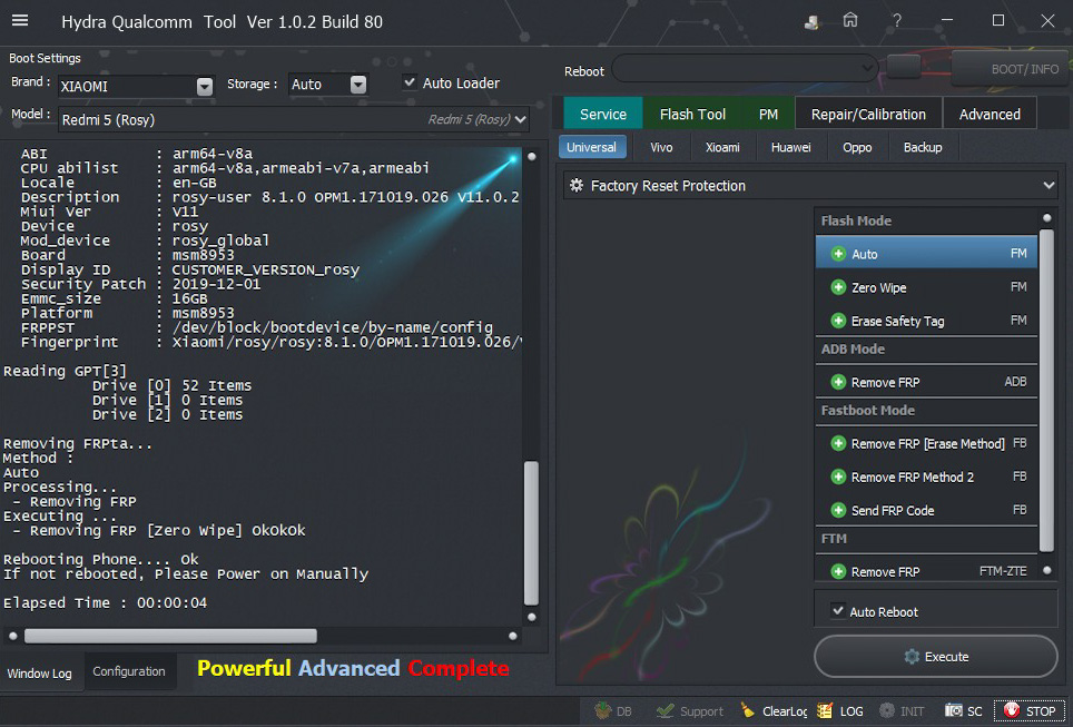

Xiaomi Redmi 5 (Rosy) FRP Zero Wipe successfully done by Hydra Tool
1. Run Hydra Qualcomm Module and choose "Sosc"
2. Select Brand and Module
3. Go to Service-->Universal
4. Choose "Factory Reset Protection" drop down menu
5. Choose "Auto" using Flash Mode.
5. Execute and connect the device to the computer with data cable
6. wait until the process is completed.
BRPreOperation Configuration
Brand : XIAOMI Model : Redmi 5 (Rosy) Storage : Auto
Loader: Xiaomi_Redmi_5-Rose_8953_ddr.mbn
Port : Auto
Connection :
FriendlyName :Qualcomm HS-USB QDLoader 9008 (COM51)
SymbolicName :\??\USB#VID_05C6&PID_9008#5&201b4142&0&2#{a5dcbf10-6530-11d2-901f-00c04fb951ed}
Getting device info..Ok
Device MODE : Firehose
Connecting to Firehose...
Ping.. Ok
Configuration......
Identifying Chip....
Ok
Chip Configuration :
MemoryName : eMMC
MaxXMLSizeInBytes : 4096
TargetName : 8953
Version : 1
*** STORAGE DEVICE INFO ***
Memory Type : eMMC
Block Size in Bytes : 512
Page Size : 512
Manufacturer ID : 21
Serial Number : 184079975
Firmware Version : 1
Product Name : GD6BMB
Physical Partitions : 3
Total Logical Blocks:
Drive [0] 61071360[29.121 GB]
Drive [1] 8192[4 MB]
Drive [2] 8192[4 MB]
Protocol : Universal
Running : Ok
Phone Information.....
Brand : Xiaomi
Vendor : Xiaomi
Model : Redmi 5
SDK : 27
Release : 8.1.0
ABI : arm64-v8a
Locale : en-GB
Description : rosy-user 8.1.0 OPM1.171019.026 V11.0.2.0.ODAMIXM release-keys
Miui Ver : V11
Device : rosy
Mod_device : rosy_global
Board : msm8953
Display ID : CUSTOMER_VERSION_rosy
Security Patch : 2019-12-01
Emmc_size : 16GB
Platform : msm8953
Fingerprint : Xiaomi/rosy/rosy:8.1.0/OPM1.171019.026/V11.0.2.0.ODAMIXM:user/release-keys
Reading GPT[3]
Drive [0] 52 Items
Drive [1] 0 Items
Drive [2] 0 Items
Removing FRPta...
Method :
Auto
Processing...
- Removing FRP
Executing ...
- Removing FRP [Zero Wipe] OkOkOk
Rebooting Phone.... Ok
If not rebooted, Please Power on Manually
Elapsed Time : 00:00:04
