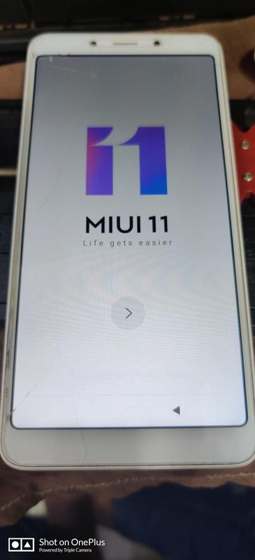

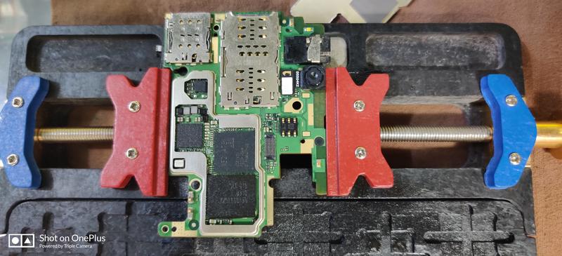

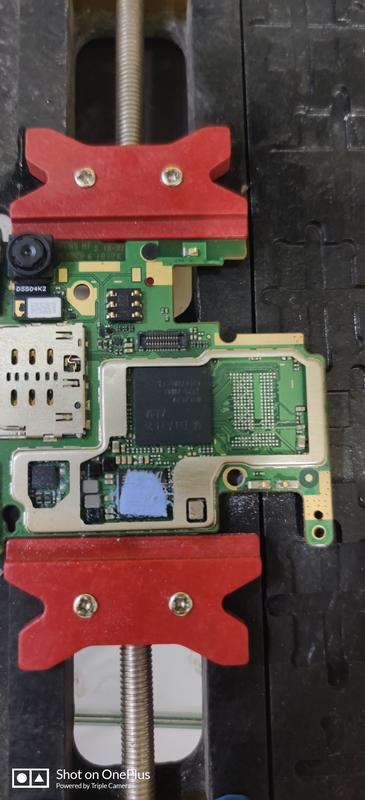

Xiaomi Redmi 6(cereus)Dead/EMMC Change/reprogramming Done By UFIBOX EMMC Tool

Dead MICRON EMMC Changed To [Samsung] QE63MB
