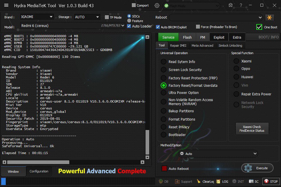

Xiaomi Redmi 6 (Cereus) Factory reset or format user data remove dy Hydra Tool
1. Run Hydra MTK module.
2. Choose Brand and Module.
3. Go to "Service"-->"Tool" Tab.
4. Choose "Factory Reset / Format user data"
5. Choose "Auto" from "Method / Option" drop down menu..
6. Click "Execute" button
7. connect device to the computer with USB Data cable
8. Wait until the process is completed.
Xiaomi-Redmi-6-Cereus-Factory-reset-or-format-user-data-remove-dy-Hydra-Tool-edited.jpg
FriendlyName :MediaTek USB Port (COM83)
Device :5&28e4b4e4&0&3
SymbolicName :\??\USB#VID_0E8D&PID_0003#5&28e4b4e4&0&3#{a5dcbf10-6530-11d2-901f-00c04fb951ed}
Handshaking...Ok
Identifying Hardware ID.....
Reading Device hardware info..
hw code : 0766MT6765 [6765]
hw subcode : 8A00
hw version : CA00
sw version : 0000
Target config : E7
SB : 01 (True)
SLA : 02 (True)
DAA : 04 (True)
Exploiting Device...
Exploit Sent..
Successfully Exploited...
Handshaking...Ok
hw subcode : 8A00
hw version : CA00
sw version : 0000
Target config : 00
SB : 00 (False)
SLA : 00 (False)
DAA : 00 (False)
FUSEID : 00000000
SECURE VERSION : 05
BL VERSION : FE
NORMAL BOOT
Preparing Download Agent..
DA : 6765_Xiaomi_wb.bin
Ver : MTK_AllInOne_DA_v3.3001.2020/03/17.ÉIIç10:04_497508
Init : Loader [1]
Sending : Accepted
Identifying Protocol...
Protocol : New
Synchronization...SYNC
Mode : brom
Preloader Initialization...
Parsing preloader_cereus.bin
Init : Accepted
Execute Secondary Loader
Init : Loader [2]
Executing : SYNC
UNIQUE ID : 140F3E7EAD1F98AC088B7DB84C108472
eMMC CID : 150100474436424D42018FD19ABC55E3 - GD6BMB
DA Speed : high-speed
Reading System Info
Brand : xiaomi
Vendor : Xiaomi
Model : Redmi 6
SDK : 27
Release : 8.1.0
ABI : armeabi-v7a
Locale : en-GB
Description : cereus-user 8.1.0 O11019 V10.3.6.0.OCGMIXM release-keys
Miui Ver : V10
Device : cereus
Mod_device : cereus_global
Display ID : O11019
Security Patch : 2019-08-01
Fingerprint : xiaomi/cereus/cereus:8.1.0/O11019/V10.3.6.0.OCGMIXM:user/release-keys
StorageType : mtp
Userdata State : Encrypted
Autobackup Partitions
-> Renaming Preloader.... preloader_cereus.bin
Creating Scatter file... C:\Hydra Tool\\Backup\Auto\0766_xiaomi_cereus_cereus_8.1.0_O11019_V10.3.6.0.OCGMIXM_062321120810\MT6765_Android_scatter.txt
-frp[0x05588000]1024 KB ->frp.bin...Ok
-nvdata[0x07688000]64 MB ->nvdata.bin...Ok
-protect1[0x0D688000]8 MB ->protect1.bin...Ok
-protect2[0x0DE88000]9.469 MB ->protect2.bin...Ok
-persist[0x0F000000]64 MB ->persist.bin...Ok
-nvram[0x1BE80000]64 MB ->nvram.bin...Ok
Done!!!
Reading System Info
Brand : xiaomi
Vendor : Xiaomi
Model : Redmi 6
SDK : 27
Release : 8.1.0
ABI : armeabi-v7a
Locale : en-GB
Miui Ver : V10
Device : cereus
Display ID : O11019
StorageType : mtp
Operation : Auto
Processing...
Safeformat Universal... Ok
Elapsed Time : 00:01:15
