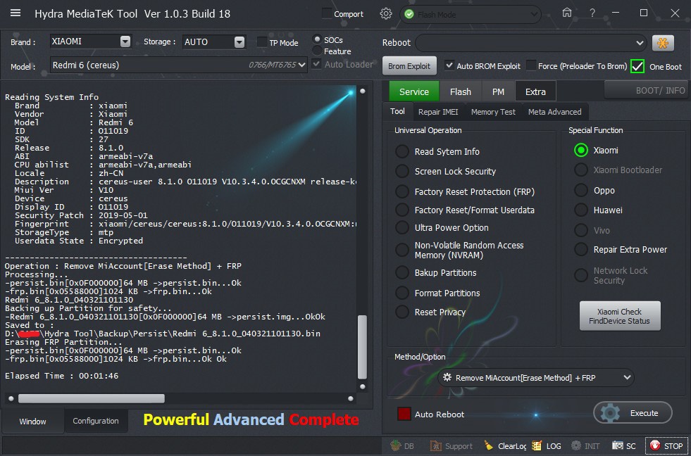

Xiaomi Redmi 6 Cereus Removing Mi Account and FRP with Erase method successfully done by Hydra
BR=====================================
FriendlyName :MediaTek USB Port_V1632 (COM10)
SymbolicName :\??\USB#VID_0E8D&PID_0003#6&eda1dea&0&4#{a5dcbf10-6530-11d2-901f-00c04fb951ed}
Handshaking...Ok
Identifying Hardware ID.....
BROM CPUID : 0766MT6765[6765]
getMTKPayloadExploit : 0766
#Executing Exploit..
#SUCCESS..
Handshaking...Ok
FUSEID : 00000000
SECURE VERSION : 05
BL VERSION : FE
BR Secured : E0
Preparing Download Agent..
DA : 6765.bin
Ver : MTK_AllInOne_DA_v3.3001.2020-11-03.22:07_536568
Init : Loader [1]
Sending : Accepted
Identifying Protocol...
Protocol : New
Synchronization...SYNC
Mode : brom
Preloader Initialization...
Parsing preloader_cereus.bin
Init : Accepted
Execute Secondary Loader
Init : Loader [2]
Executing : SYNC
UNIQUE ID : 5ABF57F52DDCB06CF9E4305ED22C54CF
ERAM Size : 0x000000000003A000 -232 KB
eMMC CID : 150100474436424D42017249071C55C7 - GD6BMB
DA Speed : high-speed
Reading System Info
Brand : xiaomi
Vendor : Xiaomi
Model : Redmi 6
SDK : 27
Release : 8.1.0
ABI : armeabi-v7a
Locale : zh-CN
Description : cereus-user 8.1.0 O11019 V10.3.4.0.OCGCNXM release-keys
Miui Ver : V10
Device : cereus
Display ID : O11019
Security Patch : 2019-05-01
Fingerprint : xiaomi/cereus/cereus:8.1.0/O11019/V10.3.4.0.OCGCNXM:user/release-keys
StorageType : mtp
Userdata State : Encrypted
Autobackup Partitions
-> Renaming Preloader.... preloader_cereus.bin
Creating Scatter file... D:\JAFF\Hydra Tool\\Backup\Auto\0766_xiaomi_cereus_cereus_8.1.0_O11019_V10.3.4.0.OCGCNXM_040321101026\MT6765_Android_scatter.txt
-frp[0x05588000]1024 KB ->frp.bin...Ok
-nvdata[0x07688000]64 MB ->nvdata.bin...Ok
-persist[0x0F000000]64 MB ->persist.bin...Ok
-nvram[0x1BE80000]64 MB ->nvram.bin...Ok
Done!!!
D:\****\Hydra Tool\\Backup\Auto\0766_xiaomi_cereus_cereus_8.1.0_O11019_V10.3.4.0.OCGCNXM_040321101026
Reading System Info
Brand : xiaomi
Vendor : Xiaomi
Model : Redmi 6
SDK : 27
Release : 8.1.0
ABI : armeabi-v7a
Locale : zh-CN
Miui Ver : V10
Device : cereus
Display ID : O11019
StorageType : mtp
Operation : Remove MiAccount[Erase Method] + FRP
Processing...
-persist.bin[0x0F000000]64 MB ->persist.bin...Ok
-frp.bin[0x05588000]1024 KB ->frp.bin...Ok
Redmi 6_8.1.0_040321101130
Backing up Partition for safety...
-Redmi 6_8.1.0_040321101130[0x0F000000]64 MB ->persist.img...OkOk
Saved to :
D:\*****\Hydra Tool\Backup\Persist\Redmi 6_8.1.0_040321101130.bin
Erasing FRP Partition...
-frp.bin[0x05588000]1024 KB ->frp.bin...Ok Ok
Elapsed Time : 00:01:46
