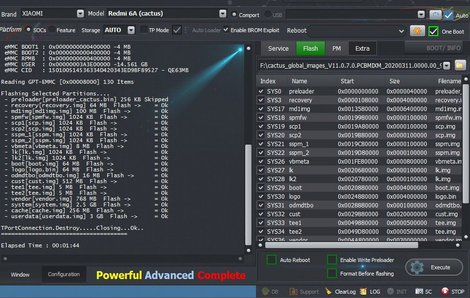

Xiaomi Redmi 6A (Cactus) successfully flashed by Hydra Tool
1. Run Hydra MTK Module and Sosc.
2. Choose Brand and Module.
3. Go to "Flash Tool" Tab.
4. Choose Flash file and its location.
5. Click on "Execute"
6. connect device to the computer with USB Data cable
7. Wait until the process is completed.
Xiaomi-Redmi-6-A-Cactus-writing-flash-file-successfully-done-by-Hydra-Tool-edited-edited.jpg
