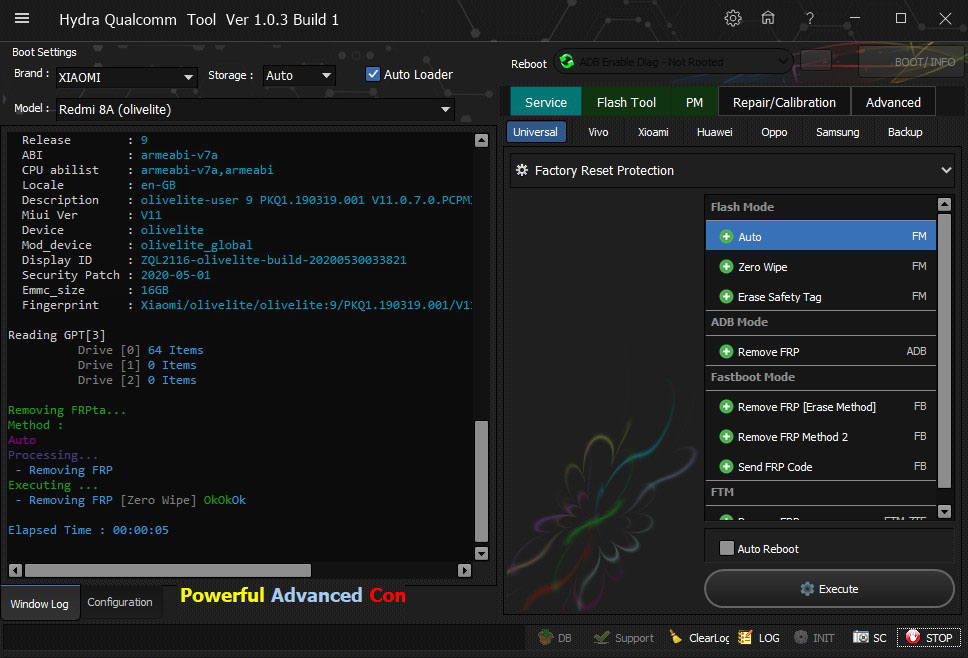

Xiaomi Redmi 8A (Olivelite) FRP removed successfully done by Hydra Tool
1. Run Hydra Qualcomm Module.
2. Choose Brand and Module.
3. Go to "Service"–>"Universal" Tab.
4. Choose "Factory reset protection" from drop down menu.
5. Choose "Auto" flash Mode.
6. Tick "Auto reboot"
7. Disassemble the cellphone (Device)
8. Click "Execute" button
9. Connect Two Test Point using Twister or Short it.
10. connect device to the computer with USB Data cable
11. Wait until the process is completed.
