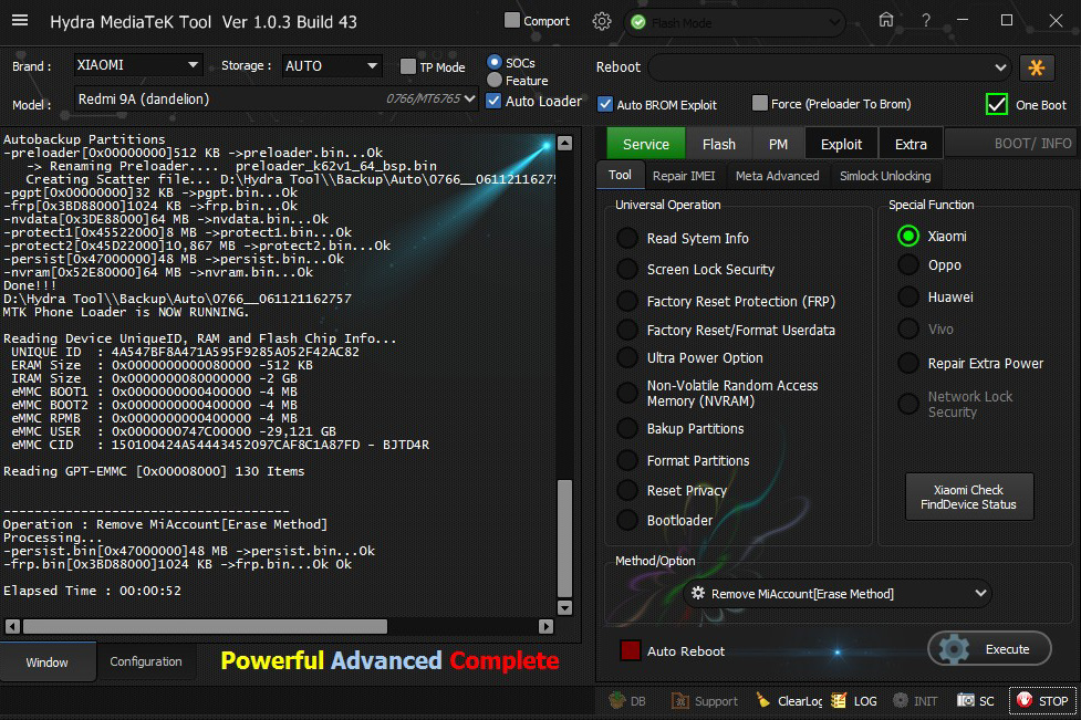

Hydra Xiaomi Redmi 9A (dandelion) removed Mi Account Erased Method done by Hydra Tool
550
1. Run Hydra MTK Module and Sosc.
2. Choose Brand and Module.
3. Go to "Service"-->"Tool" Tab.
4. Choose "Xiaomi".
5. Click on "Remove Mi Account (Erased Method)" from drop down menu.
6. Click "Execute" button
7. connect device to the computer with USB Data cable
8. Wait until the process is completed.
Xiaomi-Redmi-9-A-dandelion-removed-Mi-Account-Erased-Method-done-by-Hydra-Tool-edited.jpg
FriendlyName :MediaTek USB Port_V1632 (COM94)
Device :5&8639f5&0&2
SymbolicName :\??\USB#VID_0E8D&PID_0003#5&8639f5&0&2#{a5dcbf10-6530-11d2-901f-00c04fb951ed}
Handshaking...Ok
Identifying Hardware ID.....
Reading Device hardware info..
hw code : 0766MT6765 [6765]
hw subcode : 8A00
hw version : CA00
sw version : 0000
Target config : E7
SB : 01 (True)
SLA : 02 (True)
DAA : 04 (True)
Exploiting Device...
Exploit Sent..
Successfully Exploited...
Handshaking...Ok
hw subcode : 8A00
hw version : CA00
sw version : 0000
Target config : 00
SB : 00 (False)
SLA : 00 (False)
DAA : 00 (False)
FUSEID : 00000000
SECURE VERSION : 05
BL VERSION : FE
NORMAL BOOT
Preparing Download Agent..
DA : 6765_Xiaomi_wb.bin
Ver : MTK_AllInOne_DA_v3.3001.2020/03/17.上午10:04_497508
Init : Loader [1]
Sending : Accepted
Identifying Protocol...
Protocol : New
Synchronization...[ERROR]- NOT SYNC
Reasons why it fails due to the following"
1. Harware problem/issues
2. If you did Testpoint Kindly check the parts you Touch/TP
3. Powershortage, try to connect Battery
4. Check or replace usb cable and plug directly to your pc usb port.
SYNC
Mode : brom
Preloader Initialization...
Parsing preloader_redmi9a_Hydra_V2.bin
Init : Accepted
Execute Secondary Loader
Init : Loader [2]
Executing : SYNC
UNIQUE ID : 4A547BF8A471A595F9285A052F42AC82
IRAM Size : 0x0000000080000000 -2 GB
eMMC USER : 0x0000000747C00000 -29,121 GB
eMMC CID : 150100424A54443452097CAF8C1A87FD - BJTD4R
DA Speed : high-speed
Autobackup Partitions
-> Renaming Preloader.... preloader_k62v1_64_bsp.bin
Creating Scatter file... D:\Hydra Tool\\Backup\Auto\0766__061121162757\MT6765_Android_scatter.txt
-frp[0x3BD88000]1024 KB ->frp.bin...Ok
-nvdata[0x3DE88000]64 MB ->nvdata.bin...Ok
-protect1[0x45522000]8 MB ->protect1.bin...Ok
-protect2[0x45D22000]10,867 MB ->protect2.bin...Ok
-persist[0x47000000]48 MB ->persist.bin...Ok
-nvram[0x52E80000]64 MB ->nvram.bin...Ok
Done!!!
Operation : Remove MiAccount[Erase Method]
Processing...
-persist.bin[0x47000000]48 MB ->persist.bin...Ok
-frp.bin[0x3BD88000]1024 KB ->frp.bin...Ok Ok
Elapsed Time : 00:00:52
