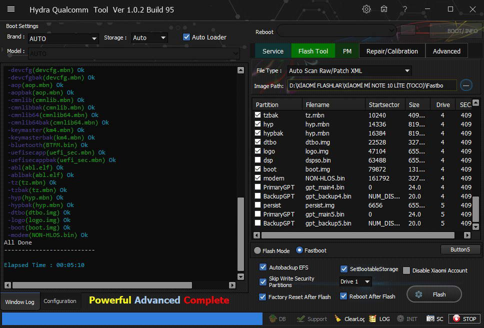

Xiaomi Redmi Note 10 Lite (TOCO) selected partition flashed by Hydra Too
1. Run Hydra Qualcomm Tool
2. Go to "Flash" Tab
3. Choose Flash file from "Image Path"
4. choose "Flash Mode"
5. Untick "Skip write security partition" if you do not want to write it.
6. Click on "Execute"
7. Connect Device with Computer using USB Data Cable
8. Wait until the flashing process is completed.
9. Done
