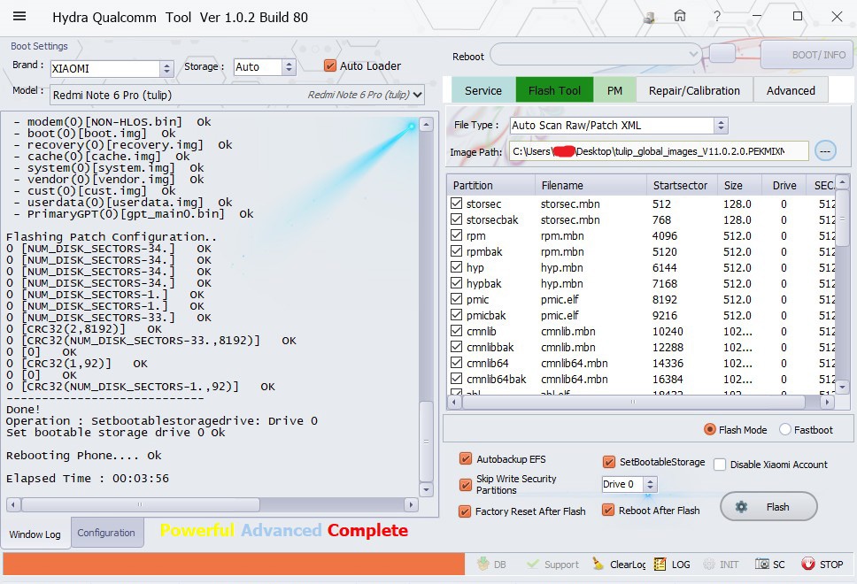

Xiaomi Redmi Note 6 Pro (Tulip) flashing successfully done by Hydra Tool
1. Run Hydra Qualcomm Module and Sosc.
2. Choose Brand and Module.
3. Go to "Flash Tool" Tab.
4. Choose Flash file and its location.
5. Click on "Flash"
6. connect device to the computer with USB Data cable
7. Wait until the process is completed.
FriendlyName :Qualcomm HS-USB QDLoader 9008 (COM47)
SymbolicName :\??\USB#VID_05C6&PID_9008#6&e7c094f&0&2#{a5dcbf10-6530-11d2-901f-00c04fb951ed}
Driver Ver :12/17/2018,2.1.3.5
Getting device info......
Serial No.: 0xA204C6F0
MSM ID : 0x000CC0E1,
PBL Ver : 00000000
PK HASH : A7B8B82545A98ECA23D6E9105FB46456
8D1B5828264903441BDEF0CD57E3C370
Firehose Loader[mi_2_9.elf]
SaharaBoot... Ok
Sending ...............................Ok
Connecting to Firehose...
Ping...... Ok
Configuration......
Identifying Chip....
Ok
Chip Configuration :
MemoryName : eMMC
MaxXMLSizeInBytes : 4096
TargetName : MSM8996
Version : 1
DateTime : Aug 2 2018 - 22:27:53
*** STORAGE DEVICE INFO ***
Memory Type : eMMC
Block Size in Bytes : 512
Page Size : 512
Manufacturer ID : 69
Serial Number : 728747581
Firmware Version : 3977066805590111797
Product Name : DA4064
Physical Partitions : 4
Total Logical Blocks:
Drive [0] 122142720[58,242 GB]
Drive [1] 8192[4 MB]
Drive [2] 8192[4 MB]
Drive [3] 32768[16 MB]
Protocol : Universal
Running : Ok
Reading GPT[4]
Drive [0] 64 Items
Drive [1] 0 Items
Drive [2] 0 Items
Drive [3]
Backup Security partitions...
Reading Security Items....
> modemst1
> modemst2
> fsg
C:\Hydra Tool\Backup\Security_Backup\___Security_050221125507.sec
Backup Security Success....
- storsec(0)[storsec.mbn] Ok
- storsecbak(0)[storsec.mbn] Ok
- rpm(0)[rpm.mbn] Ok
- rpmbak(0)[rpm.mbn] Ok
- hyp(0)[hyp.mbn] Ok
- hypbak(0)[hyp.mbn] Ok
- pmic(0)[pmic.elf] Ok
- pmicbak(0)[pmic.elf] Ok
- cmnlib(0)[cmnlib.mbn] Ok
- cmnlibbak(0)[cmnlib.mbn] Ok
- cmnlib64(0)[cmnlib64.mbn] Ok
- cmnlib64bak(0)[cmnlib64.mbn] Ok
- abl(0)[abl.elf] Ok
- ablbak(0)[abl.elf] Ok
- devcfgbak(0)[devcfg.mbn] Ok
- devcfg(0)[devcfg.mbn] Ok
- tz(0)[tz.mbn] Ok
- tzbak(0)[tz.mbn] Ok
- mdtpsecapp(0)[mdtpsecapp.mbn] Ok
- mdtpsecappbak(0)[mdtpsecapp.mbn] Ok
- keymaster(0)[keymaster64.mbn] Ok
- keymasterbak(0)[keymaster64.mbn] Ok
- bluetooth(0)[BTFM.bin] Ok
- xbl(0)[xbl.elf] Ok
- xblbak(0)[xbl.elf] Ok
- misc(0)[misc.img] Ok
- dsp(0)[dspso.bin] Ok
- mdtp(0)[mdtp.img] Ok
- splash(0)[splash.img] Ok
- modem(0)[NON-HLOS.bin] Ok
- boot(0)[boot.img] Ok
- cache(0)[cache.img] Ok
- system(0)[system.img] Ok
- vendor(0)[vendor.img] Ok
- cust(0)[cust.img] Ok
0 [NUM_DISK_SECTORS-34.] OK
0 [NUM_DISK_SECTORS-1.] OK
0 [NUM_DISK_SECTORS-33.] OK
0 [CRC32(2,8192)] OK
0 [CRC32(NUM_DISK_SECTORS-33.,8192)] OK
0 [0] OK
0 [CRC32(1,92)] OK
0 [0] OK
Done!
Rebooting Phone.... Ok
Elapsed Time : 00:03:56
