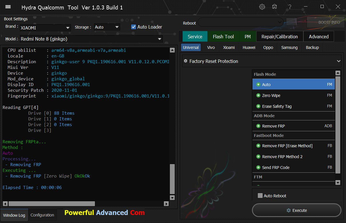

Xiaomi Redmi Note 8 (Ginkgo) FRP successfully removed by Hydra Tool
1. Run Hydra Qualcomm Module.
2. Choose Brand and Module.
3. Go to "Service"–>"Univesal" Tab.
4. Choose "Factory reset protection" from drop down menu.
5. Choose "Auto" from flash Mode.
6. Tick "Auto Reboot"
7. Disassemble the cellphone (Device) and find test points
8. Click "Execute" button
9. Connect Two Test Point using Twister or Short it.
10. connect device to computer with the help of data cable.
11. Wait until the operation is completed.
