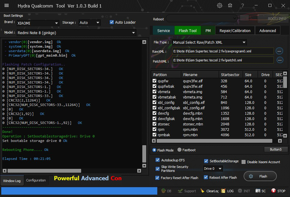

Xiaomi Redmi Note 8 (Ginkgo) successfully flashed by Hydra Tool
1. Run Hydra Qualcomm Tool
2. Choose "Brand" and "Module"
3. Choose "Flash Tab"
4. Choose "Image Path" and "IMage Type" and load it from its location.
5. Choose "Flash Mode"
6. choose "Skip write security partition"
7. Choose "Factory Reset after flash" and "Reboot after flash"
8. Click "Flash"
9. Connect device to the computer using USB Data Cable.
10. Wait until the operation is completed.
8. Click "Flash"
