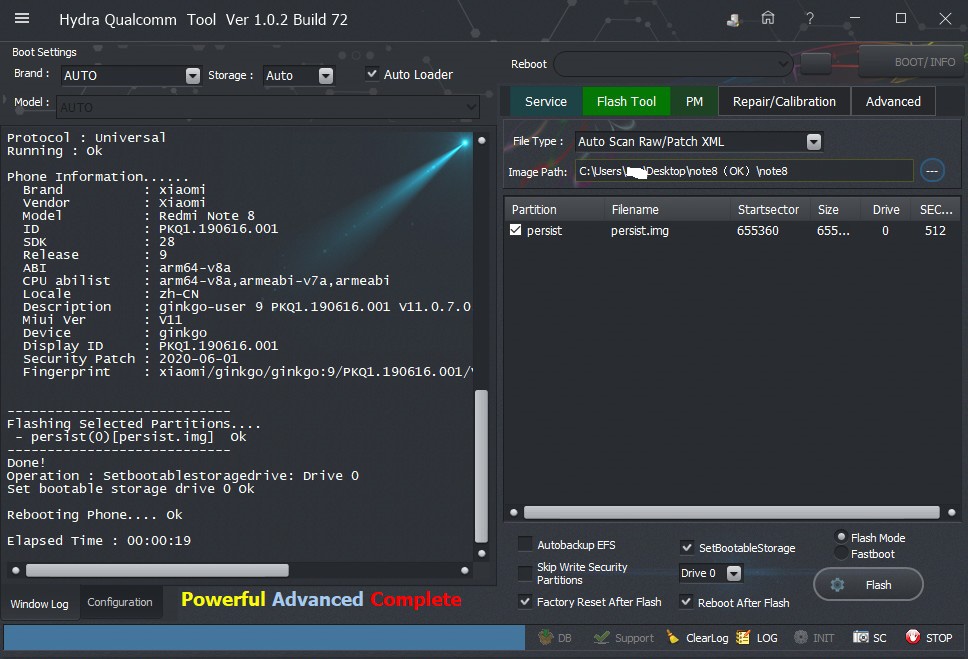

Hydra Xiaomi Redmi Note 8 Presist.img successfully flashed to repair cellphone by Hydra Tool
550
Xiaomi-Redmi-Note-8-Presist-img-successfully-flashed-to-repair-cellphone-by-Hydra-Tool.jpg
FriendlyName :Qualcomm HS-USB QDLoader 9008 (COM3)
SymbolicName :\??\USB#VID_05C6&PID_9008#6&34ced5b7&0&8#{a5dcbf10-6530-11d2-901f-00c04fb951ed}
Getting device info..Ok
Device MODE : Firehose
Connecting to Firehose...
Ping..................... Ok
Configuration.........
Identifying Chip....
Ok
Chip Configuration :
MemoryName : eMMC
MaxXMLSizeInBytes : 4096
TargetName :
Version : 1
DateTime : Jul 3 2019 - 22:23:56
*** STORAGE DEVICE INFO ***
Memory Type : eMMC
Block Size in Bytes : 512
Page Size : 512
Manufacturer ID : 144
Serial Number : 2700719544
Firmware Version : 909127728
Product Name : hC8aP>
Physical Partitions : 4
Total Logical Blocks:
Drive [1] 8192[4 MB]
Drive [2] 8192[4 MB]
Drive [3] 32768[16 MB]
Protocol : Universal
Running : Ok
Phone Information......
Brand : xiaomi
Vendor : Xiaomi
Model : Redmi Note 8
SDK : 28
Release : 9
ABI : arm64-v8a
Locale : zh-CN
Description : ginkgo-user 9 PKQ1.190616.001 V11.0.7.0.PCOCNXM release-keys
Miui Ver : V11
Device : ginkgo
Display ID : PKQ1.190616.001
Security Patch : 2020-06-01
Fingerprint : xiaomi/ginkgo/ginkgo:9/PKQ1.190616.001/V11.0.7.0.PCOCNXM:user/release-keys
- persist(0)[persist.img] Ok
Done!
Rebooting Phone.... Ok
Elapsed Time : 00:00:19
