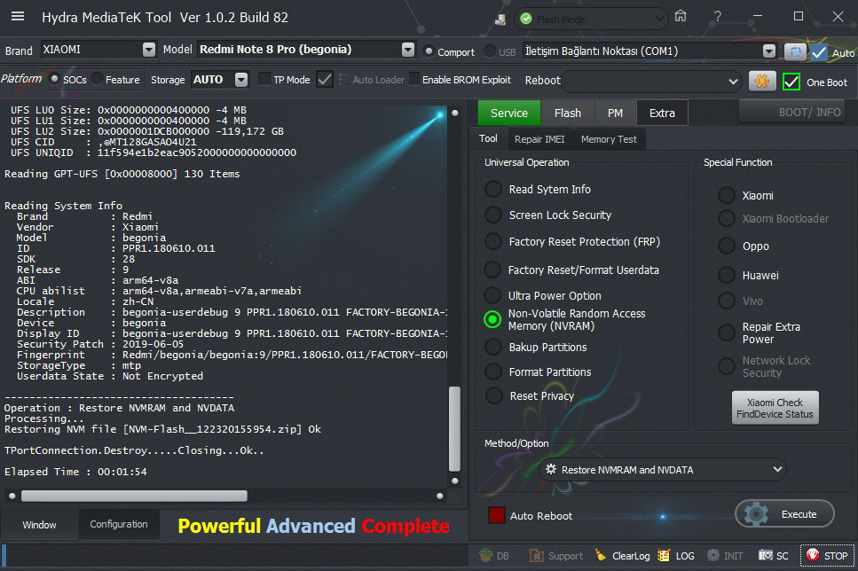

Hydra Xiaomi Redmi Note 8 Pro (begonia) restoring NVRAM successfully done by Hydra Tool
550
Xiaomi-Redmi-Note-8-Pro-begonia-restoring-NVRAM-successfully-done-by-Hydra-Tool-edited.jpg
Brand : XIAOMI Model : Redmi Note 8 Pro (begonia) Connection : Flash Mode
Connection
-Please wait...
-Connect Phone...
-Found...
-PreLoader...[COM21]
TPortConnection.Create...(COM21)..Opening...Ok
Handshaking...Ok
Identifying Hardware ID.....
BROM CPUID : 0813MT6785[6785]
Handshaking...
FUSEID : 00000000
SECURE VERSION : FF
BL VERSION : 03
BR Secured : 07
Preparing Download Agent..
DA : Xiaomi_RedmiNote8Pro_6785.bin
Ver : MTK_AllInOne_DA_v3.3001.2019/12/14.17:56_491164
Init : Loader [1]
Sending : Accepted
Identifying Protocol...
Protocol : New
Synchronization...SYNC
Mode : preloader
Execute Secondary Loader
Init : Loader [2]
Executing : SYNC
Sending Certifificate
UNIQUE ID : 3EB48342C2CE6986174CAE47DB5427A0
IRAM Size : 0x0000000180000000 -6 GB
UFS LU0 Size: 0x0000000000400000 -4 MB
UFS LU1 Size: 0x0000000000400000 -4 MB
UFS LU2 Size: 0x0000001DCB000000 -119,172 GB
UFS CID : ,OMT128GASAO4U21
UFS UNIQID : 11f594e1b2eac9052000000000000000
DA Speed : high-speed
Reading GPT-UFS [0x00008000] 130 Items
Reading System Info
Brand : Redmi
Vendor : Xiaomi
Model : begonia
SDK : 28
Release : 9
ABI : arm64-v8a
Locale : zh-CN
Description : begonia-userdebug 9 PPR1.180610.011 FACTORY-BEGONIA-1101 test-keys
Device : begonia
Display ID : begonia-userdebug 9 PPR1.180610.011 FACTORY-BEGONIA-1101 test-keys
Security Patch : 2019-06-05
Fingerprint : Redmi/begonia/begonia:9/PPR1.180610.011/FACTORY-BEGONIA-1101:userdebug/test-keys
StorageType : mtp
Autobackup Partitions
-> Renaming Preloader....
-frp[0x05888000]1024 KB ->frp.bin...Ok
-nvdata[0x08188000]64 MB ->nvdata.bin...Ok
-persist[0x0E188000]70,469 MB ->persist.bin...Ok
-nvram[0x17580000]64 MB ->nvram.bin...Ok
Done!!!
D:\Hydra Tool\\Backup\Auto\Redmi_begonia_0813--9_begonia-userdebug 9 PPR1.180610.011 FACTORY-BEGONIA-1101 test-keys_180221174801
Reading System Info
Brand : Redmi
Vendor : Xiaomi
Model : begonia
SDK : 28
Release : 9
ABI : arm64-v8a
Locale : zh-CN
Device : begonia
StorageType : mtp
Operation : Restore NVMRAM and NVDATA
Processing...
Restoring NVM file [NVM-Flash__122320155954.zip] Ok
Elapsed Time : 00:01:54
