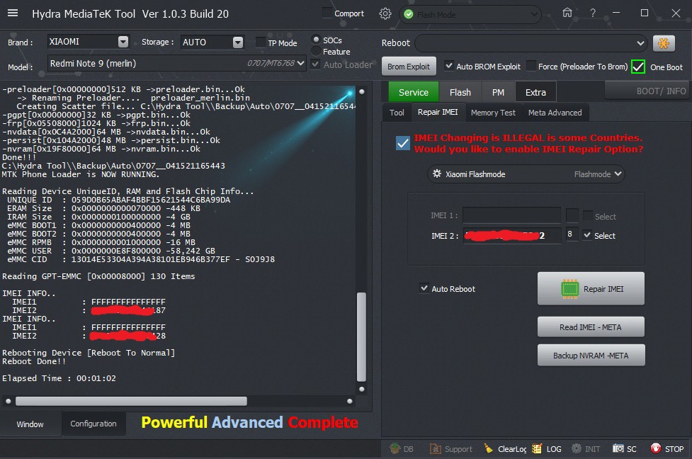

Hydra Xiaomi Redmi Note 9 Merlin IMEI repaird successfully done by Hydra Tool
550
***IMEI REPAIR FUNCTION****
Xiaomi Flashmode
FriendlyName :MediaTek USB Port (COM14)
SymbolicName :\??\USB#VID_0E8D&PID_0003#5&2dadc828&0&2#{a5dcbf10-6530-11d2-901f-00c04fb951ed}
Handshaking...Ok
Identifying Hardware ID.....
BROM CPUID : 0707MT6768[6768]
getMTKPayloadExploit : 0707
#Executing Exploit..
#SUCCESS..
Handshaking...Ok
FUSEID : 00000000
SECURE VERSION : 05
BL VERSION : FE
BR Secured : E0
Preparing Download Agent..
DA : MT6768_Xiaomi_New.bin
Ver : MTK_AllInOne_DA_v3.3001.2020/07/07.10:10_513994
Init : Loader [1]
Sending : Accepted
Identifying Protocol...
Protocol : New
Synchronization...SYNC
Mode : brom
Preloader Initialization...
Parsing preloader_merlin.bin
Init : Accepted
Execute Secondary Loader
Init : Loader [2]
Executing : SYNC
UNIQUE ID : 059D0B65ABAF4BBF15621544C6BA99DA
eMMC USER : 0x0000000E8F800000 -58,242 GB
eMMC CID : 13014E53304A394A38101EB946B377EF - S0J9J8
DA Speed : high-speed
Autobackup Partitions
-> Renaming Preloader.... preloader_merlin.bin
Creating Scatter file... C:\Hydra Tool\\Backup\Auto\0707__041521165443\MT6768_Android_scatter.txt
-frp[0x05508000]1024 KB ->frp.bin...Ok
-nvdata[0x0C4A2000]64 MB ->nvdata.bin...Ok
-persist[0x104A2000]48 MB ->persist.bin...Ok
-nvram[0x19F80000]64 MB ->nvram.bin...Ok
Done!!!
IMEI INFO..
IMEI1 : FFFFFFFFFFFFFFF
IMEI2 : **************87
IMEI INFO..
IMEI2 : **************28
Reboot Done!!
Elapsed Time : 00:01:02
