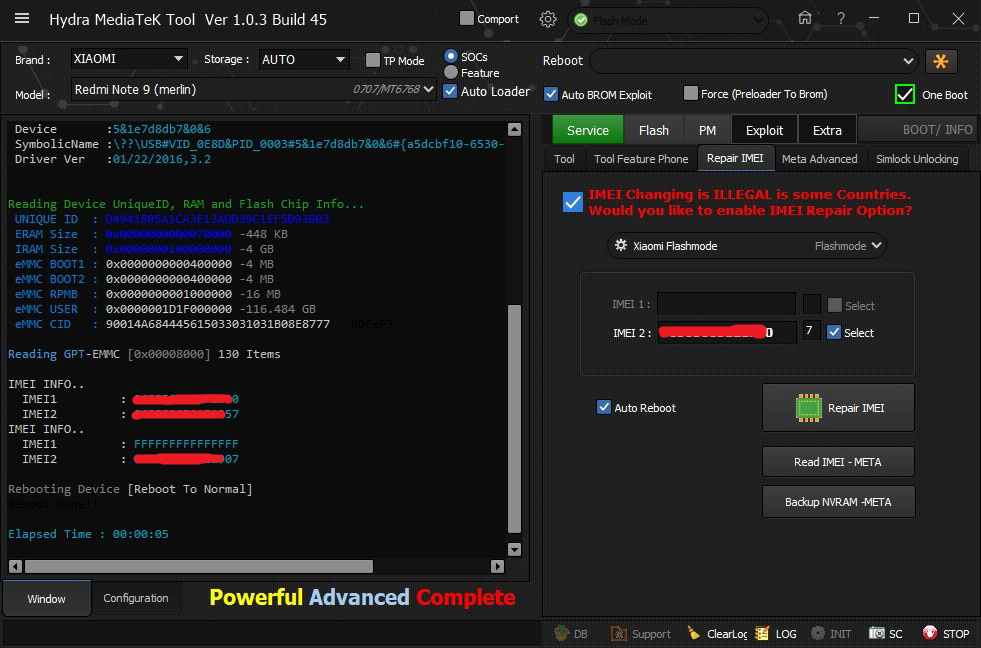

Xiaomi Redmi Note 9 (merlin) Second IMEI successfully removed by Hydra Tool
1. Run Hydra MTK module and SOSc.
2. Choose Brand and Module as auto.
3. Go to "Service"--> "IMEI" Tab.
4. Tick "Changing IMEI changing is illegal........."
5. Choose "Xiaomi Flash mode" from drop down menu
6. Tick "IMEI 2"
7. Type IMEI as written as battery housing.
8. connect device to the computer with USB Data cable
9. Wait until the process is completed
