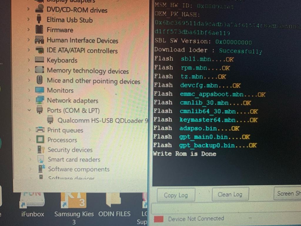

when u flash succes by halabtool phone go fastboot? even not show anythink on screen ?
this is not coz lx1 or lx2,
1 flash by halab, check device menager if phone is in fastboot, dont replug cable or batery
okay. i try now ...

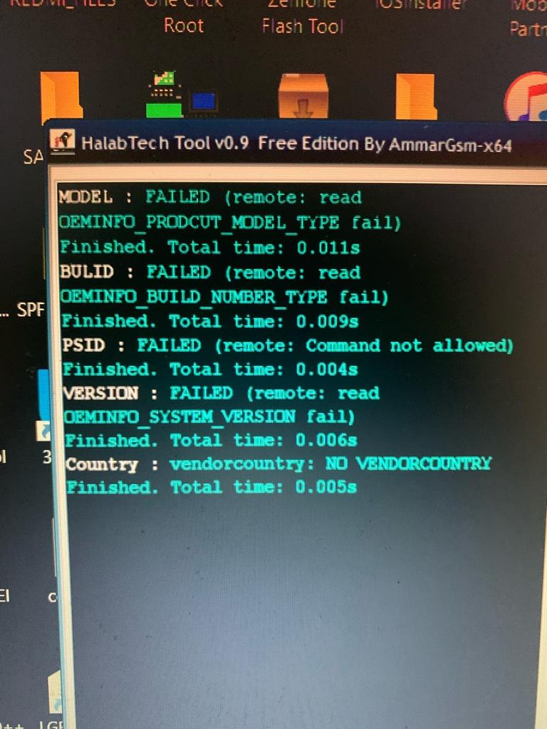

see is done by halabtech tool....but still 9008
any option?

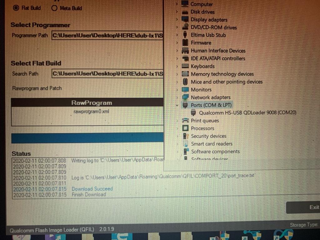

it seem to be good news ! finally successfully done by QFIL, and i don’t know what happen here.
been flashing for several days ....

Franky38
Moderator
Jul 28, 2018
2,584
2,623
Good, I see both the logs and captures and in the first screenshot that the model dub-lx2 and you are flashing with firmware dub-lx1 serious error, you have to do it first boad software of dub-lx2 and then firmware dub-lx2 update .app, with preloader and customization, you put it in sd card or otg and in upgrade mode. It is also very important to have a site to download firmware, if not in this work you are annoyed is a tip.

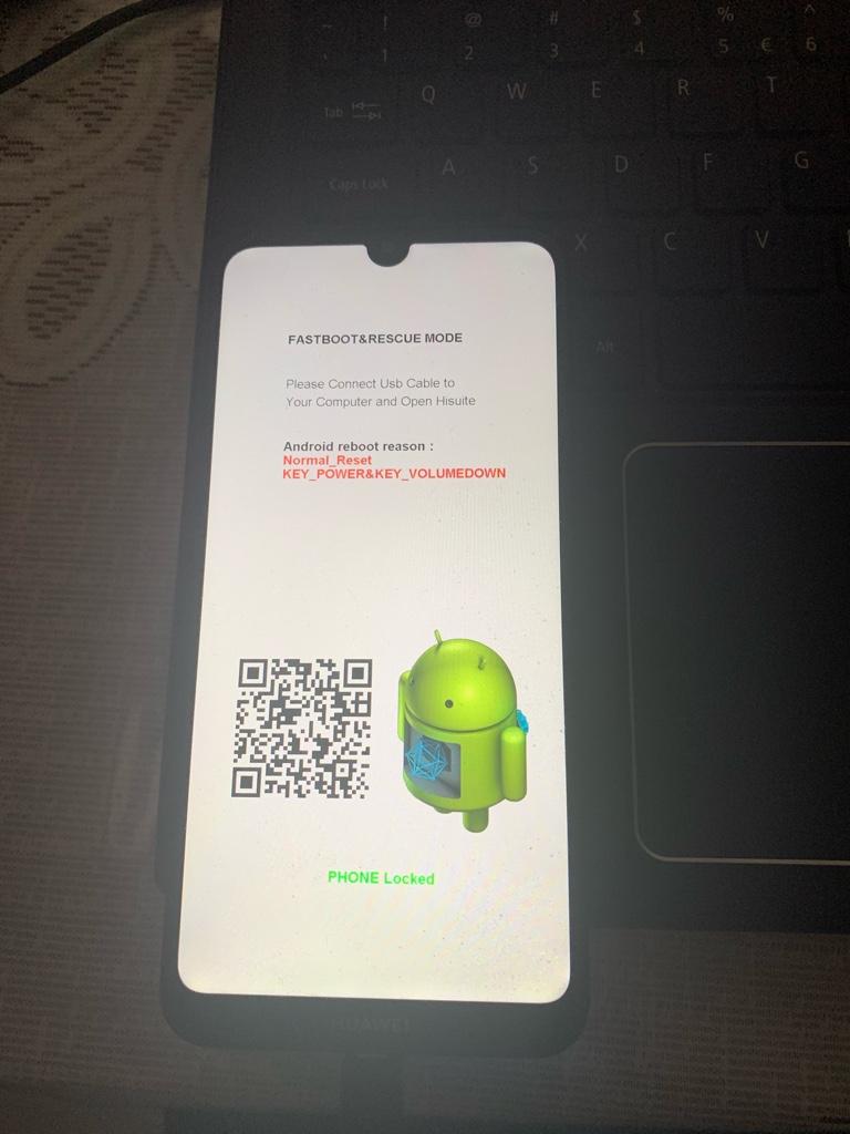

finally the phone was able to boot up as normal . thank you very much.

Franky38
Moderator
Jul 28, 2018
2,584
2,623
Good, I am glad that you have revived the huawei, that means that the forum community works, connect it to the internet or wifi and update or force the update because that fund is not the original, when you update you will have the huawei fully repaired and it will work at The normality.
