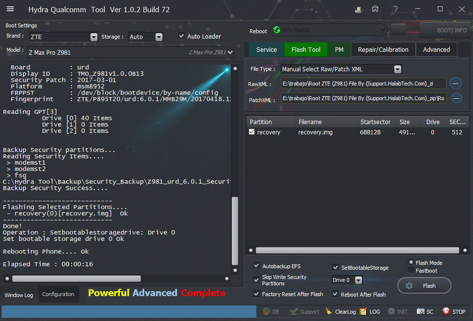

Hydra ZTE Z Max Pro Z981 Recovery Image successfully flashed by Hydra Tool
548
FriendlyName :Qualcomm HS-USB QDLoader 9008 (COM8)
SymbolicName :\??\USB#VID_05C6&PID_9008#6&3b3da89d&0&4#{a5dcbf10-6530-11d2-901f-00c04fb951ed}
Getting device info.....
Serial No.: 0x0219912B
MSM ID : 0x009720E1, MSM8609-Qualcomm Snapdragon 210
PBL Ver : 00000000
PK HASH : 06E90D11F17C6237F0297B33613530F0
0A9ECA807551A6BD86EAF34EA2CF981F
Firehose Loader[ZTE_1_9.mbn]
SaharaBoot... Ok
Sending ................Ok
Connecting to Firehose...
Ping... Ok
Configuration......
Identifying Chip....
Ok
Chip Configuration :
MemoryName : eMMC
MaxXMLSizeInBytes : 4096
TargetName : 8952
Version : 1
Protocol : Universal
Running : Ok
Phone Information.....
Brand : ZTE
Vendor : ZTE
Model : Z981
SDK : 23
Release : 6.0.1
ABI : arm64-v8a
Locale : en-US
Description : P895T20-user 6.0.1 MMB29M 20170418.114928 release-keys
Device : urd
Board : urd
Display ID : TMO_Z981V1.0.0B13
Security Patch : 2017-03-01
Platform : msm8952
Fingerprint : ZTE/P895T20/urd:6.0.1/MMB29M/20170418.114928:user/release-keys
Reading GPT[3]
Drive [0] 40 Items
Drive [1] 0 Items
Drive [2] 0 Items
Backup Security partitions...
Reading Security Items....
> modemst1
> modemst2
> fsg
C:\Hydra Tool\Backup\Security_Backup\Z981_urd_6.0.1_Security_020221211656.sec
Backup Security Success....
Done!
Rebooting Phone.... Ok
Elapsed Time : 00:00:16
