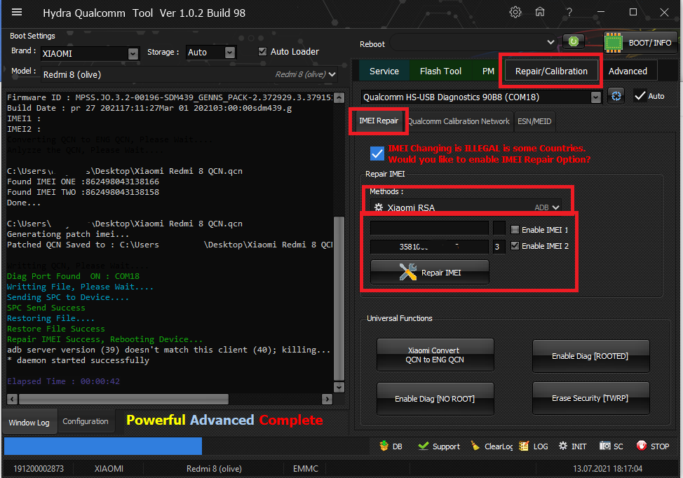

Xiaomi Redmi 8 olive IMEI Repair, All MIUI and Android versions are supported.
Without Unlock Bootloader
Without Root

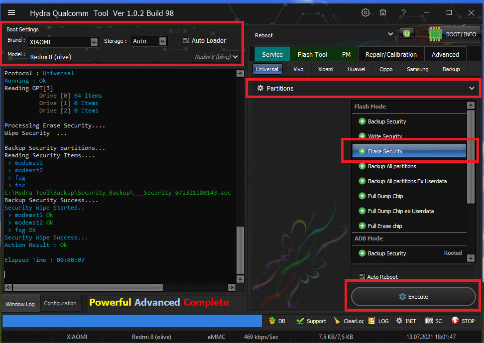

  1. Run Qualcomm Module, Select Brand and Model
  2. Put your device EDL Mode by Testpoint
  3. From Service -> Partitions Tab Select Erase Security
  4. Power on device Enable Diag by Dial code *#*#717717#*#*
  5. Go to Repair Tab, Select Xiaomi RSA Method
  6. Fill IMEI 2 only and Repair
Note : Only 2nd imei supported this device.
Erase Security by EDL Mode :
Repair IMEI LOG :

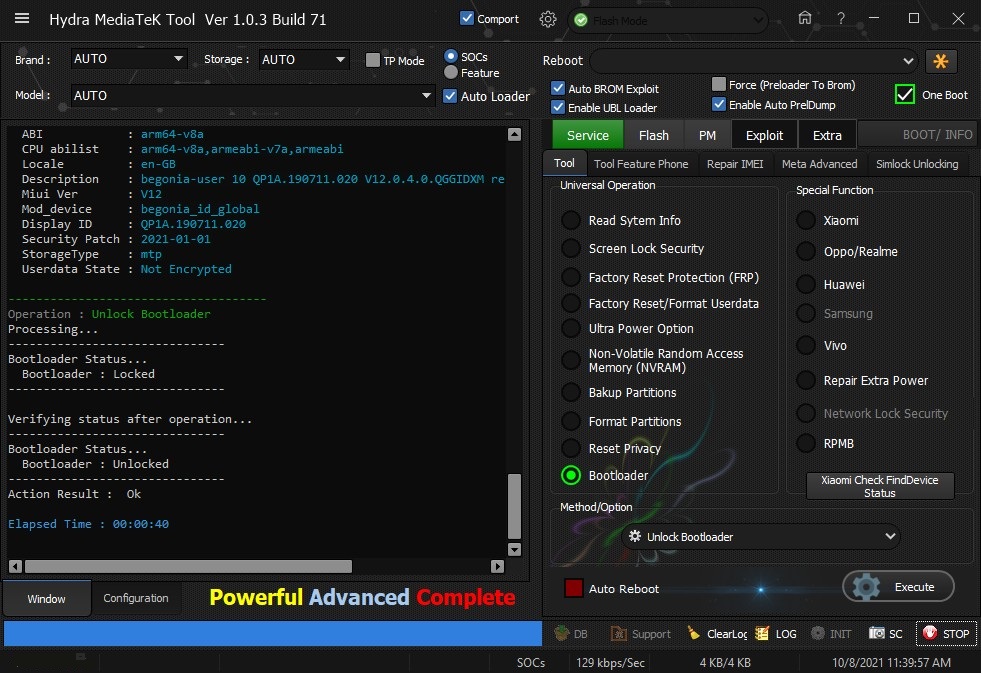

sero408
Sep 26, 2021
893
94
türkiye
Xiaomi Redmi Note 8 Pro Bootloader Unlock Instant by Hydra
without wait 7 days

Operation : Unlock Bootloader
Processing...
Bootloader Status...
Bootloader : Locked
Verifying status after operation...
Bootloader : Unlocked
Action Result :Ok
Elapsed Time : 00:00:40

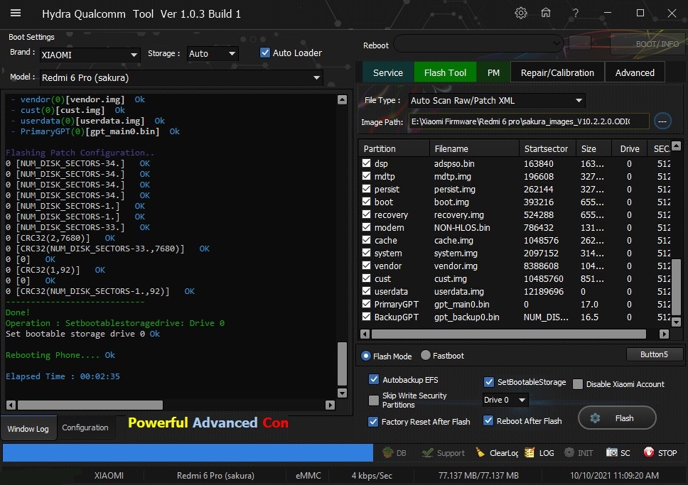

sero408
Sep 26, 2021
893
94
türkiye
Xioami Redmi 6 Edl Flashıng With by Hydra
Quote:

Memory Type : eMMC
Block Size in Bytes : 512
Page Size : 512
Manufacturer ID : 144
Serial Number : 3281161589
Firmware Version : 162
Product Name : HCG8a4
Physical titions : 3
Total Logical Blocks:
Drive [0] 122142720 [58.242 GB]
Drive [1] 8192 [4 MB]
Drive [2] 8192 [4 MB]
Protocol : Universal
Running : Ok
Phone Information .....
Brand : xiaomi
Vendor : Xiaomi
Model : Redmi 6 Pro
SDK : 28
Release : 9
ABI : arm64-v8a
Locale : zh-CN
Description : ******-user 9 PKQ1.180917.001 V12.0.1.0.PDICNXM release-keys
Miui Ver : V12
Device : ******
Display ID : ZQL1715-******-build-20200728120204
Security Patch : 2020-07-01
Emmc_size : 16GB
Fingerprint : xiaomi/******/******:9/PKQ1.180917.001/V12.0.1.0.PDICNXM:user/release-keys
Reading GPT[3]
Drive [0] 60 Items
Drive [1] 0 Items
Drive [2] 0 Items
Backup Security titions...
Reading Security Items....
> modemst1
> modemst2
> fsg
> fsc
C:UsersThiha MobileDesktopHydraTool_Fullpackage_05-16-2021_ps_hydratoolBackupSecurity_BackupRedmi 6 Pro__9_Security_101021110652.sec
Backup Security Success....
Flashing Selected titions....
- sec (0)b [sec.dat] b0 Ok
- config (0)b [config.bin] b0 Ok
- lksecapp (0)b [lksecapp.mbn] b0 Ok
- lksecappbak (0)b [lksecapp.mbn] b0 Ok
- devcfg (0)b [devcfg.mbn] b0 Ok
- devcfgbak (0)b [devcfg.mbn] b0 Ok
- apdp (0)b [dummy.img] b0 Ok
- msadp (0)b [dummy.img] b0 Ok
- sbl1 (0)b [sbl1.mbn] b0 Ok
- sbl1bak (0)b [sbl1.mbn] b0 Ok
- rpm (0)b [rpm.mbn] b0 Ok
- rpmbak (0)b [rpm.mbn] b0 Ok
- cmnlib (0)b [cmnlib_30.mbn] b0 Ok
- cmnlibbak (0)b [cmnlib_30.mbn] b0 Ok
- cmnlib64 (0)b [cmnlib64_30.mbn] b0 Ok
- cmnlib64bak (0)b [cmnlib64_30.mbn] b0 Ok
- keymaster (0)b [keymaster64.mbn] b0 Ok
- keymasterbak (0)b [keymaster64.mbn] b0 Ok
- misc (0)b [misc.img] b0 Ok
- aboot (0)b [emmc_appsboot.mbn] b0 Ok
- abootbak (0)b [emmc_appsboot.mbn] b0 Ok
- tz (0)b [tz.mbn] b0 Ok
- tzbak (0)b [tz.mbn] b0 Ok
- splash (0)b [splash.img] b0 Ok
- dsp (0)b [adspso.bin] b0 Ok
- mdtp (0)b [mdtp.img] b0 Ok
- persist (0)b [persist.img] b0 Ok
- boot (0)b [boot.img] b0 Ok
- recovery (0)b [recovery.img] b0 Ok
- modem (0)b [NON-HLOS.bin] b0 Ok
- cache (0)b [cache.img] b0 Ok
- system (0)b [system.img] b0 Ok
- vendor (0)b [vendor.img] b0 Ok
- cust (0)b [cust.img] b0 Ok
- userdata (0)b [userdata.img] b0 Ok
- PrimaryGPT (0)b [gpt_main0.bin] b0 Ok
0 [NUM_DISK_SECTORS-34.] OK
0 [NUM_DISK_SECTORS-1.] OK
0 [NUM_DISK_SECTORS-33.] OK
0 [CRC32(2,7680)] OK
0 [CRC32(NUM_DISK_SECTORS-33.,7680)] OK
0 [0] OK
0 [CRC32(1,92)] OK
0 [0] OK
Done!
Rebooting Phone.... Ok
Elapsed Time : 00:02:35

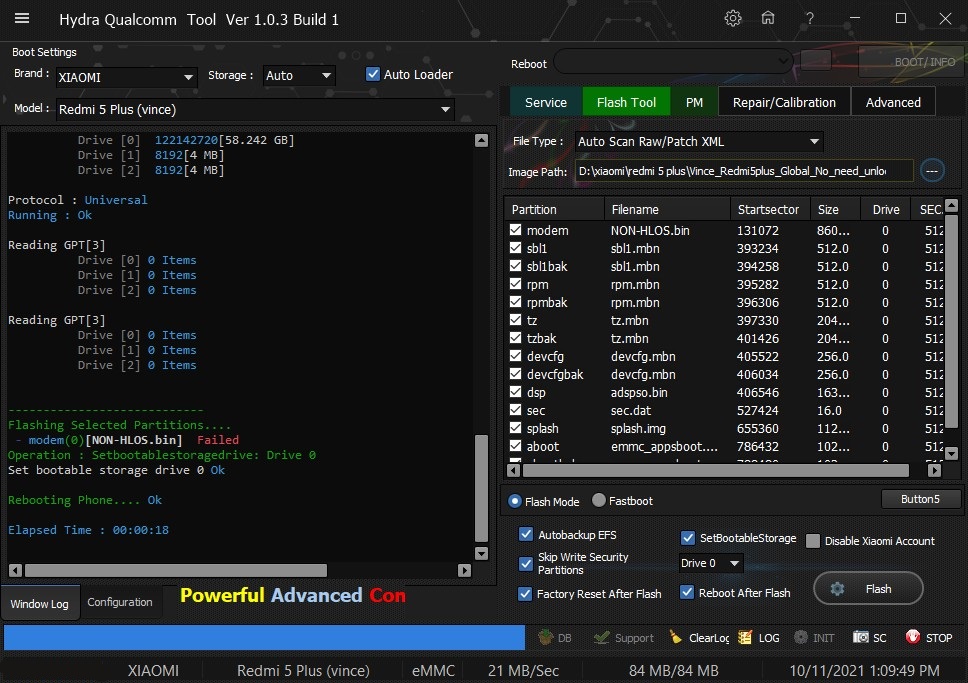

Xioami Redmi 5 Plus (Vince) Edl Flash With by Hydra
Quote:
Searching for Qualcomm 9008 Device... Found
FriendlyName : Qualcomm HS-USB QDLoader 9008 (COM26)
SymbolicName :??USB#VID_05C6&PID_9008#5&2956bf20&0&3#{a5dcbf10-6530-11d2-901f-00c04fb951ed}
Driver Ver : 02/05/2018,3.0.0.0
Getting device info .. . ...
Serial No.: 0x3F11B7B0
HW_ID : 000460E100000000
MSM ID : 0x000460E1, MSM8953-Qualcomm Snapdragon 625
MODEL_ID : 0x0000
OEM_ID : 0x0000 - QUALCOMM
PBL Ver : 00000000
PK HASH : 57158eaf1814d78fd2b3105ece4db18a817a08ac664a5782a9 25f3ff8403d39a
Firehose Loader [mi_3_1.mbn]
Header Type : OLD
TargetMSM : 8953
Tag : _peek
Version : 3
Code_size : 288
Signature_size : 256
fhVendor : XIAOMI
Vendor : QUALCOMM
OEM_ID : 0000
MODEL_ID : 0000
SW_ID : 0000000000000003
APP_ID :
pk_hash : 57158eaf1814d78fd2b3105ece4db18a817a08ac664a5782a9 25f3ff8403d39a
OEM_VERSION : c3-bsp-builder-job001.bj
IMAGE_VARIANT : JAADANAZA
QC_VERSION : BOOT.BF.3.3-00221
SaharaBoot... Ok
Sending ..................b Okb0
Connecting to Firehose...
Ping ... Ok
Configuration......
Identifying Chip....
Ok
Chip Configuration :
MemoryName : eMMC
MaxXMLSizeInBytes : 4096
TargetName : 8953
Version : 1
*** STORAGE DEVICE INFO ***
Memory Type : eMMC
Page Size : 512
Serial Number : 877091852
Running : Ok
Reading GPT[3]
Drive [0] 0 Items
Drive [1] 0 Items
Drive [2] 0 Items
Reading GPT[3]
Drive [0] 0 Items
Drive [1] 0 Items
Drive [2] 0 Items
- modem (0)b [NON-HLOS.bin] 0b0 Failed
Elapsed Time : 00:00:18

Xioami Redmi Note 9 (Merlin) Bootloader Unlock With by Hydra
Searching for MTK Device... Found
Port Identification : Flashmode BROM
FriendlyName : MediaTek USB Port_V1633 (COM3)
Device : 6&6aaf50d&0&4
SymbolicName :??USB#VID_0E8D&PID_0003#6&6aaf50d&0&4#{a5dcbf10-6530-11d2-901f-00c04fb951ed}
Driver Ver : 01/22/2015,3.0.1504.0
Opened handle..
Handshaking... Ok
Identifying Hardware ID.....
Reading Device hardware info..
hw code : 0707 MT6768 [6768]
hw subcode : 8A00
hw version : CA00
sw version : 0000
Target config : E7
SBC : 01 (True)
SLA : 02 (True)
DAA : 04 (True)
SWJTAG : 06 (True)
EPP : 00 (False)
CERT : 00 (False)
MEMREAD : 20 (True)
MEMWRITE : 40 (True)
CMD_C8 : 80 (True)
Exploiting Device...
Exploit Sent..
Successfully Exploited...
Handshaking... Ok
C:Hydra ToolBackupPreloader_dumpprel.tmp
Handshaking...
hw subcode : 8A00
hw version : CA00
sw version : 0000
Target config : 00
SBC : 00 (False)
SLA : 00 (False)
DAA : 00 (False)
SWJTAG : 00 (False)
EPP : 00 (False)
CERT : 00 (False)
MEMREAD : 00 (False)
MEMWRITE : 00 (False)
CMD_C8 : 00 (False)
MEID : E7E928F47DDFF925D9334FE7A5186E53
Stage 1.. [Size:256504]
Sending : Please wait.. Accepted
Identifying Protocol...
Protocol : New
Synchronization... SYNC
Preloader Initialization...
sing prel.tmp
Init : Accepted
Executing : SYNC
UNIQUE ID : BE2A97BBFF84596B740241C1866A268E
eMMC USER : 0x0000001D1F000000 -116,484 GB
eMMC CID : 13014E47314A395339100853CA6C7765 - G1J9S9
Executing : ACCEPTED...
Reading GPT -EMMC [0x00008000] 130 Items
UNIQUE ID : 0 BE2A97BBFF84596B740241C1866A268E
ERAM Size : 0 0x0000000000070000 -448 KB
IRAM Size : 0 0x0000000100000000 -4 GB
Processing...
Bootloader : Locked
Action Result : Ok
Elapsed Time : 00:00:34

Redmi 9C (angelica) Unlock Bootloader With by Hydra
FriendlyName : MediaTek USB Port (COM26)
Device : 5&6f73c6d&0&3
SymbolicName :??USB#VID_0E8D&PID_0003#5&6f73c6d&0&3#{a5dcbf10-6530-11d2-901f-00c04fb951ed}
Opened handle..
UNIQUE ID : 8204F711E2EBC59A9FBA5720D554F508
ERAM Size : 0x0000000000038000 -224 KB
eMMC CID : 150100434A54443452041C564C24976F - CJTD4R
Processing...
Bootloader : Locked
Action Result : Ok
Elapsed Time : 00:00:03
