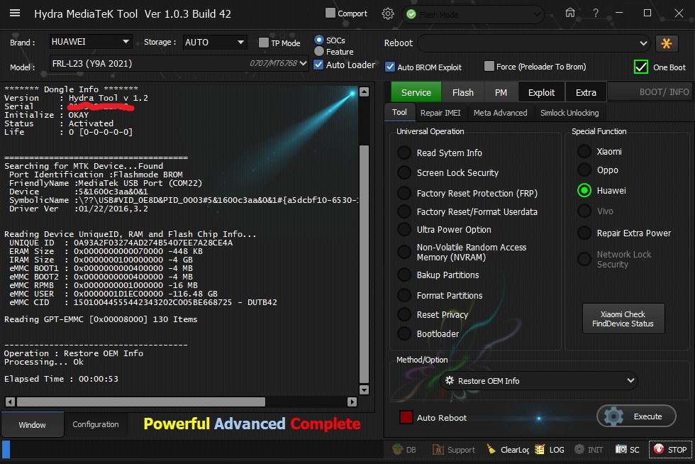

Huawei FRL-L23 (Y9A 2021) Restore OEM info successfully done by HYDRA TooL
1. Run MTK Hydra Tool.
2. Choose "Brand" and "Module".
3. Go to "Service"--> "Tool"
4. Choose "Huawei"
5. Chose "Restore OEM Info" from "Method/ Option" drop down option.
6. Click "Execute".
7. Connect Device to computer using USB Data Cable.
8. Wait until the operation is completed.
Huawei-FRL-L23-Y9-A-2021-Restore-OEM-info-successfully-done-by-HYDRA-Too-L-edited.jpg
FriendlyName :MediaTek USB Port (COM22)
Device :5&1600c3aa&0&1
SymbolicName :\??\USB#VID_0E8D&PID_0003#5&1600c3aa&0&1#{a5dcbf10-6530-11d2-901f-00c04fb951ed}
Driver Ver :01/22/2016,3.2
UNIQUE ID : 0A93A2F03274AD274B5407EE7A28CE4A
eMMC USER : 0x0000001D1EC00000 -116.48 GB
eMMC CID : 15010044555442343202C005BE668725 - DUTB42
Operation : Restore OEM Info
Processing... Ok
Elapsed Time : 00:00:53
