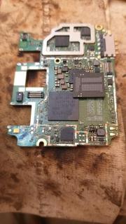

Coolpad 8297l-100 dead recover done with remove emmc and programming

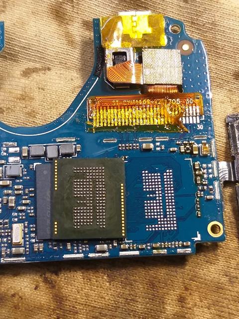

Htc 516w dead recover done with emmc change
Skhynix to samsung

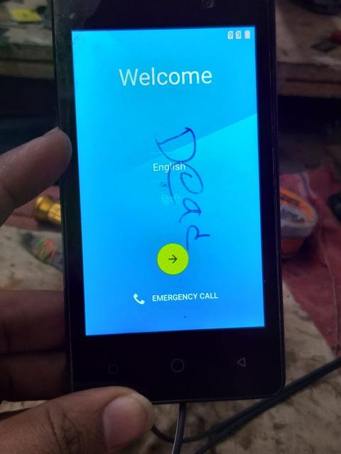

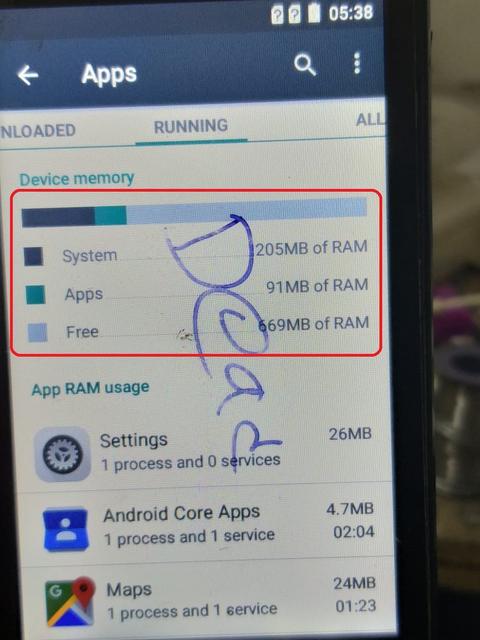

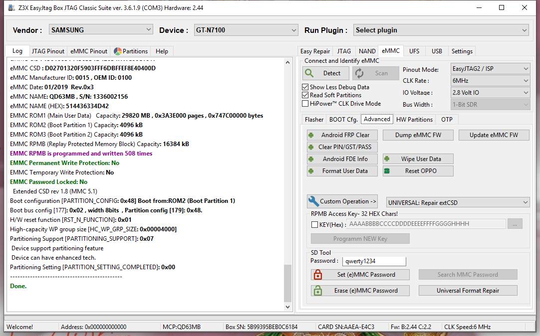

Intex Aqua Power 4G Stuck On android Recovered Done
Emmc Repair Only
Log
Successfully Alive SEt
Reactions: sohang kumar

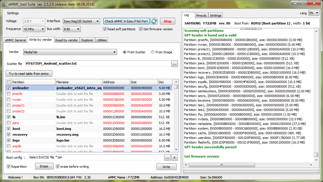

Micromax Q413 Dead After Format With CM2 Recover Done With Easy Jtag
Setting interface to EasyJtag2/E-Socket
Setting bus width to 8 Bit
Setting frequence to 42 MHz
EMMC Device Information :
EMMC CID: 150100524531424D4207B415C6B56357
EMMC CSD: D02701320F5903FFF6DBFFEF8E40400D
EMMC Manufacture : SAMSUNG , EMMC NAME: RE1BMB , HEX: 524531424D42 , S/N: B415C6B5 , rev. 0x07
EMMC Manufacture ID: 0x15 , OEM ID: 0x00 , Device Type: BGA (Discrete embedded) , Date: 6/2016
EMMC ROM 1 (Main User Data) Capacity: 14910 MB (0003A3E00000)
EMMC ROM 2/3 (Boot Partition 1/2) Capacity: 4096 KB (000000400000)
EMMC RPMB (Replay Protected Memory Block) Capacity: 4096 KB (000000400000) Counter: 0 , Response: Clean
EMMC Permanent Write Protection: No
EMMC Temporary Write Protection: No
Extended CSD Information :
Extended CSD rev: 1.8 (MMC 5.1)
Boot configuration [PARTITION_CONFIG]: 0x48 , Boot from: ROM2 (Boot partition 1)
Boot Bus Config: 0x00 , width 1bit
H/W Reset Function [RST_N_FUNCTION]: 0x01, RST_n signal is permanently enabled
Supported partition features [PARTITIONING_SUPPORT]: 0x07
Device supports partitioning features
Device can have enhanced technological features in partitions and user data area
Device can have extended partitions attribute
Partition Settings [PARTITION_SETTING_COMPLETED]: 0x00
Backup saved: RE1BMB_B415C6B5_20190705_195832.extcsd
EMMC Init completed.
Scanning soft partitions
GPT header is found and is valid
Partition: proinfo, [000000080000 - 000000380000], size: 000000300000 (3.00 MB)
Partition: nvram, [000000380000 - 000000880000], size: 000000500000 (5.00 MB)
Partition: protect1, [000000880000 - 000001280000], size: 000000A00000 (10.0 MB)
Partition: protect2, [000001280000 - 000001C80000], size: 000000A00000 (10.0 MB)
Partition: lk, [000001C80000 - 000001D00000], size: 000000080000 (512. KB)
Partition: para, [000001D00000 - 000001D80000], size: 000000080000 (512. KB)
Partition: boot, [000001D80000 - 000002D80000], size: 000001000000 (16.0 MB)
Partition: recovery, [000002D80000 - 000003D80000], size: 000001000000 (16.0 MB)
Partition: logo, [000003D80000 - 000004580000], size: 000000800000 (8.00 MB)
Partition: expdb, [000004580000 - 000004F80000], size: 000000A00000 (10.0 MB)
Partition: seccfg, [000004F80000 - 000005000000], size: 000000080000 (512. KB)
Partition: oemkeystore, [000005000000 - 000005200000], size: 000000200000 (2.00 MB)
Partition: secro, [000005200000 - 000005800000], size: 000000600000 (6.00 MB)
Partition: keystore, [000005800000 - 000006000000], size: 000000800000 (8.00 MB)
Partition: tee1, [000006000000 - 000006500000], size: 000000500000 (5.00 MB)
Partition: tee2, [000006500000 - 000006A00000], size: 000000500000 (5.00 MB)
Partition: frp, [000006A00000 - 000006B00000], size: 000000100000 (1.00 MB)
Partition: nvdata, [000006B00000 - 000008B00000], size: 000002000000 (32.0 MB)
Partition: metadata, [000008B00000 - 00000B000000], size: 000002500000 (37.0 MB)
Partition: system, [00000B000000 - 00008B000000], size: 000080000000 (2.00 GB)
Partition: cache, [00008B000000 - 000093000000], size: 000008000000 (128. MB)
Partition: userdata, [000093000000 - 0003A2D80000], size: 00030FD80000 (12.2 GB)
Partition: flashinfo, [0003A2D80000 - 0003A3D80000], size: 000001000000 (16.0 MB)
GPT header successfully parsed
Get firmware version
Firmware info not found
Operation: Preloader parser
preloader_p7511.bin
Found 4 supported eMMC CID:
name = 'HAG2e' hex = 0x484147326505 [SKHYNIX]
eNAND_H26M52103FMR/16GB @FBGA169
eNAND_H9TQ17A8GTMCUR-KTM/16GB @BGA221
eNAND_H9TQ17A8GTMCUR-KUM/16GB @BGA221
eNAND_H9TQ17ABJTMCUR-KTM/16GB @BGA221
eNAND_H9TQ17ABJTMCUR-KUM/16GB @BGA221
name = 'Q823MB' hex = 0x513832334D42 [SAMSUNG]
KMQ820013M-B419/16GB @BGA221
name = '016G70' hex = 0x303136473730 [TOSHIBA]
eSD_THGBMFG7C1LBAIL/16GB @FBGA153
name = 'Q72SMB' hex = 0x513732534D42 [SAMSUNG]
KMQ72000SM-B316/8GB @BGA221+LPDDR3 8Gb
Backup saved: RE1BMB_B415C6B5_20190705_195946.extcsd
Backup saved: RE1BMB_B415C6B5_20190705_195956.extcsd
Opening file: MT6735M_Android_scatter.txt
The new format of scatter
config_version: V1.1.2

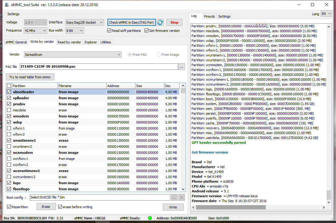

platform: MT6735M
preloader_p7511.bin
The size of the last section has been updated
preloader_top6735m_35gu_l1.bin
Found 3 supported eMMC CID:
name = 'R31BAB' hex = 0x523331424142 [SAMSUNG]
name = 'RE1BMB' hex = 0x524531424D42 [SAMSUNG]
Backup saved: RE1BMB_B415C6B5_20190705_200113.extcsd
platform: MT6735M
Backup saved: RE1BMB_B415C6B5_20190705_200123.extcsd
Operation: Write by vendor (MediaTek)
Creating GPT-partitioninig
Writing PrimaryGPT at address: 000000000000
Writing BackupGPT at address: 0003A3DFBE00
GPT-partitioning done
Partition name: preloader
Filename: preloader_top6735m_35gu_l1.bin , Offset: 000000000000 , filesize: 124376 bytes
eMMC switching to ROM2
Erasing partition...
Writing partition...
Done writing partition. Write speed: 1494.59 KB/s
Partition name: lk
Filename: lk.bin , Offset: 000001C80000 , filesize: 415186 bytes
eMMC switching to ROM1
Done writing partition. Write speed: 5116.36 KB/s
Partition name: boot
Filename: boot.img , Offset: 000001D80000 , filesize: 7073792 bytes
Done writing partition. Write speed: 10484.50 KB/s
Partition name: recovery
Filename: recovery.img , Offset: 000002D80000 , filesize: 7811072 bytes
Done writing partition. Write speed: 19297.58 KB/s
Partition name: logo
Filename: logo.bin , Offset: 000003D80000 , filesize: 1292810 bytes
Done writing partition. Write speed: 12599.11 KB/s
Partition name: secro
Filename: secro.img , Offset: 000005200000 , filesize: 135168 bytes
Done writing partition. Write speed: 4225.20 KB/s
Partition name: tee1
Filename: trustzone.bin , Offset: 000006000000 , filesize: 60416 bytes
Done writing partition. Write speed: 3878.59 KB/s
Partition name: tee2
Filename: trustzone.bin , Offset: 000006500000 , filesize: 60416 bytes
Done writing partition. Write speed: 3754.97 KB/s
Partition name: system
Filename: system.img , Offset: 00000B000000 , filesize: 2112320076 bytes
Sparse image found v.1.0 Total chunks: 2436
Done writing partition. Write speed: 17803.44 KB/s
Partition name: cache
Filename: cache.img , Offset: 0000AB000000 , filesize: 6348948 bytes
Sparse image found v.1.0 Total chunks: 10
Done writing partition. Write speed: 19297.69 KB/s
Partition name: userdata
Filename: userdata.img , Offset: 0000B3000000 , filesize: 20808176 bytes
Sparse image found v.1.0 Total chunks: 39
Done writing partition. Write speed: 15871.71 KB/s
Writing DL_Info...
Writing DL_Info done
Writing eMMC Register ...
Reg: 179 Value: 0x48
Reg: 177 Value: 0x00
Reg: 162 Value: 0x01
All done time: [00:02:35:703]
Backup saved: RE1BMB_B415C6B5_20190705_200446.extcsd
Partition: system, [00000B000000 - 0000AB000000], size: 0000A0000000 (2.50 GB)
Partition: cache, [0000AB000000 - 0000B3000000], size: 000008000000 (128. MB)
Partition: userdata, [0000B3000000 - 0003A2D7BE00], size: 0002EFD7BE00 (11.7 GB)
Partition: flashinfo, [0003A2D7BE00 - 0003A3D7BE00], size: 000001000000 (16.0 MB)

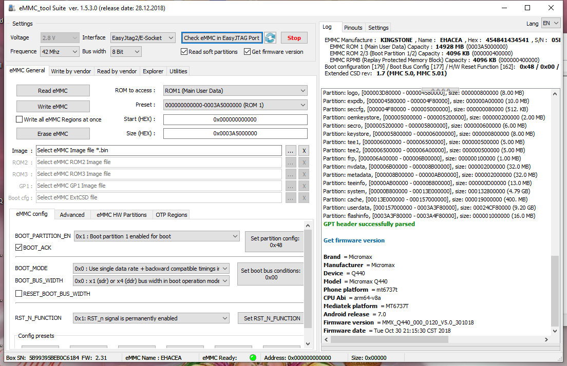

Brand = Micromax
Manufacturer = Micromax
Device = Q413
Model = Micromax Q413
Phone platform = mt6735m
CPU Abi = armeabi-v7a
Mediatek platform = MT6735
Android release = 5.1
Firmware version = MMX_Q413_SW_V2.0.6_HW_V2.0.0_20160401
Firmware date = Thu Mar 10 03:19:30 CST 2016

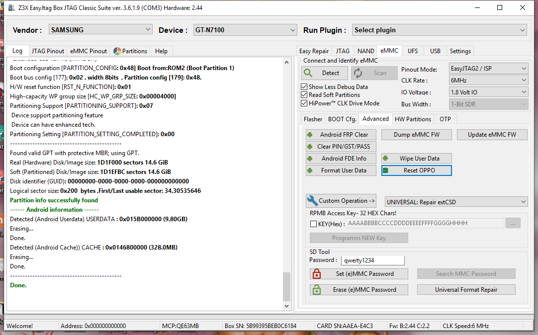

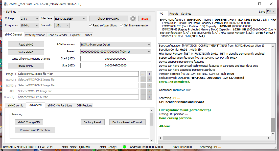

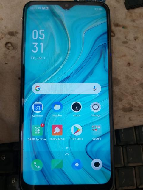

another oppo a3s done wipe userdata and clear frp very fast in seconds and jobdone
Checking security ...
Z3X EasyJtag Software ver. 3.6.1.2
Loading eMMC GEN2 Firmware... IO: 2800 mV
Box S/N: 417A1E88471829FA, ,FW Ver.: 02.44
CMD Pullup Level:2120 mV
CMD Active Level:2685 mV
Box IO Level:2800 mV
CLK Rate:1000 kHz
Bus Width:1bit,SDR
HiPower mode is off!
---------- eMMC Device Information ----------
eMMC CID : 150100514536334D4203AE34DEA48523
eMMC CSD : D02701320F5903FFF6DBFFEF8E40400D
eMMC Manufacturer ID: 0015 , OEM ID: 0100
eMMC Date: 08/2018 Rev.0x3
eMMC NAME: QE63MB , S/N: 2922700452
eMMC NAME (HEX): 514536334D42
IC Name: Samsung , KMQE60013M-B318/16GB @BGA221
EMMC ROM1 (Main User Data) Capacity: 14910 MB , 0x1D1F000 pages , 0x3A3E00000 bytes
EMMC ROM2 (Boot Partition 1) Capacity: 4096 kB
EMMC ROM3 (Boot Partition 2) Capacity: 4096 kB
EMMC RPMB (Replay Protected Memory Block) Capacity: 4096 kB
EMMC RPMB is programmed and written 16175 times
EMMC Password Locked: No
Extended CSD rev 1.8 (MMC 5.1)
Boot configuration [PARTITION_CONFIG: 0x38] Boot from:ROM1 (Main User Area)
Boot bus config [177]: 0x00 , width 1bit , Partition config [179]: 0x38.
H/W reset function [RST_N_FUNCTION]: 0x01
High-capacity WP group size [HC_WP_GRP_SIZE: 0x00004000]
Partitioning Support [PARTITIONING_SUPPORT]: 0x07
Device support partitioning feature
Device can have enhanced tech.
Partitioning Setting [PARTITION_SETTING_COMPLETED]: 0x00
Partition table scan:
GPT: present
Found valid GPT with protective MBR; using GPT.
Real (Hardware) Disk/Image size: 1D1F000 sectors 14.6 GiB
Soft (Partitioned) Disk/Image size: 1D1EFBC sectors 14.6 GiB
Logical sector size: 0x200 bytes
Disk identifier (GUID): 98101B32-BBE2-4BF2-A06E-2BB33D000C20
First usable sector: 34
Last usable sector: 30535646
Partition info successfully found
------ Android information ------
Detected LINUX(Android) CACHE : 0x001FB00000 (256.0MB)
Erasing...
Done.
Detected LINUX(Android) USERDATA : 0x0158000000 (9.184GB)
Erasing...
Done.
Done.
Running:Format FRP Partition...
CMD Pullup Level:2121 mV
CMD Active Level:2684 mV

ferouzkassim
Oct 11, 2018
51
34
Uganda
ferouz_kassim
ANOTHER OPO A3S DONE
Warning: CMD Pullup Level (343 mV) too low , check cables etc.!
CMD Active Level:2662 mV
CLK Rate:1000 kHz
Bus Width:1bit,SDR
eMMC CID : 150100514536334D42060704D3ADA55D
eMMC Date: 10/2018 Rev.0x6
eMMC NAME: QE63MB , S/N: 117756845
EMMC RPMB is programmed and written 70189 times
Backup saved: QE63MB_ 117756845_20190730_1300.extcsd
Card Supported Command sets [S_CMD_SET: 0x01]
HPI Features [HPI_FEATURE: 0x01]:
implementation based on CMD13
Background operations support [BKOPS_SUPPORT: 0x01]
Max Packet Read Cmd [MAX_PACKED_READS: 0x3f]
Max Packet Write Cmd [MAX_PACKED_WRITES: 0x3f]
Data TAG support [DATA_TAG_SUPPORT: 0x01]
Data TAG Unit Size [TAG_UNIT_SIZE: 0x02]
Tag Resources Size [TAG_RES_SIZE: 0x00]
Context Management Capabilities [CONTEXT_CAPABILITIES: 0x05]
Large Unit Size [LARGE_UNIT_SIZE_M1: 0x07]
Extended partition attribute support [EXT_SUPPORT: 0x03]
Generic CMD6 Timer [GENERIC_CMD6_TIME: 0x0a]
Power off notification [POWER_OFF_LONG_TIME: 0x3c]
Cache Size [CACHE_SIZE] is 65536 KiB
Detected LINUX(Android) SYSTEM : 0x003F000000 (3.352GB)
Build ID: OPM1.171019.026
Release Base ID: 8.1.0
Architecture ABI: arm64-v8a
Device manufacturer: OPPO
Build Description: msm8953_64-user 8.1.0 OPM1.171019.026 eng.root.20190323.213841 release-keys
Detected USERDATA USERDATA : 0x0158000000 (9.184GB)
Unable to mount USERDATA , code : 95
Done.
Selected eMMC Interface
GPT: present
Erasing...
Done.
Erasing...
Done.
Done.
GPT: present
Formatting FRP...
Detected LINUX(Android) CACHE : 0x001FB00000 (256.0MB) , formatting...
Done.
Detected LINUX(Android) CONFIG : 0x002FC80000 (32.0KB) formatting...
Done.
Detected LINUX(Android) USERDATA : 0x0158000000 (9.184GB) , formatting...
Done.
Done.
Done.

SAMSUNG G532F BOOT REPAIR DONE
eMMC_tool Suite ver. 1.6.2.0 (release date: 30.06.2019)
Microsoft Windows 7 (64 bit) build 7600 (6.1.7600.16385)
Looking for EasyJTAG box...
EasyJTAG API ver. 3307
EasyJTAG Box Serial = 417A1E88471829FA
Card Serial = AAF96E71
EasyJTAG Box Firmware = 2.44
Changelog:
30.06.2019 (ver 1.6.1.0)
Fix: Bugs that have been found through your crash report
Failed to connect to the server
Setting interface to EasyJtag2/ISP
Setting bus width to 1 Bit
Setting frequence to 1 MHz
CMD Pullup Level: 2806 mV
CMD Active Level: 2800 mV
EMMC CID: 90014A48384734759201C38364F935E3
EMMC CSD: D02701320F5903FFFFFFFFE78A40002B
EMMC Manufacture : SKHYNIX , EMMC NAME: H8G4u , HEX: 483847347500 , S/N: C38364F9 , rev. 0x01
EMMC Manufacture ID: 0x90 , OEM ID: 0x4A , Device Type: BGA (Discrete embedded) , Date: 3/2018
EMMC ROM 1 (Main User Data) Capacity: 7456 MB (0001D2000000)
EMMC RPMB (Replay Protected Memory Block) Capacity: 4096 KB (000000400000) Counter: 0 , Response: Maybe not clean
Extended CSD rev: 1.7 (MMC 5.0, MMC 5.01)
Backup saved: H8G4u_C38364F9_20190809_143622.extcsd
Partition: BOTA0, [000000400000 - 000000800000], size: 000000400000 (4.00 MB)
Partition: nvram, [000000800000 - 000001000000], size: 000000800000 (8.00 MB)
Partition: lk, [000001000000 - 000001200000], size: 000000200000 (2.00 MB)
Partition: BOTA1, [000001200000 - 000001400000], size: 000000200000 (2.00 MB)
Partition: secro, [000001400000 - 000001B00000], size: 000000700000 (7.00 MB)
Partition: seccfg, [000001B00000 - 000001B80000], size: 000000080000 (512. KB)
Partition: efuse, [000001B80000 - 000001C00000], size: 000000080000 (512. KB)
Partition: tee1, [000001C00000 - 000002200000], size: 000000600000 (6.00 MB)
Partition: BOTA2, [000002200000 - 000002800000], size: 000000600000 (6.00 MB)
Partition: EFS, [000002800000 - 000003000000], size: 000000800000 (8.00 MB)
Partition: nvdata, [000003000000 - 000005000000], size: 000002000000 (32.0 MB)
Partition: PARAM, [000005000000 - 000005800000], size: 000000800000 (8.00 MB)
Partition: recovery, [000005800000 - 000006800000], size: 000001000000 (16.0 MB)
Partition: boot, [000006800000 - 000007800000], size: 000001000000 (16.0 MB)
Partition: md1img, [000007800000 - 000009800000], size: 000002000000 (32.0 MB)
Partition: md1dsp, [000009800000 - 000009C00000], size: 000000400000 (4.00 MB)
Partition: keystore, [000009C00000 - 00000A400000], size: 000000800000 (8.00 MB)
Partition: omekeystore, [00000A400000 - 00000A780000], size: 000000380000 (3.50 MB)
Partition: proinfo, [00000A780000 - 00000AA00000], size: 000000280000 (2.50 MB)
Partition: para, [00000AA00000 - 00000AA80000], size: 000000080000 (512. KB)
Partition: PERSISTENT, [00000AA80000 - 00000AB00000], size: 000000080000 (512. KB)
Partition: STEADY, [00000AB00000 - 00000AC00000], size: 000000100000 (1.00 MB)
Partition: protect1, [00000AC00000 - 00000B400000], size: 000000800000 (8.00 MB)
Partition: protect2, [00000B400000 - 00000BC00000], size: 000000800000 (8.00 MB)
Partition: RESERVE2, [00000BC00000 - 00000C000000], size: 000000400000 (4.00 MB)
Partition: system, [00000C000000 - 0000CC800000], size: 0000C0800000 (3.01 GB)
Partition: cache, [0000CC800000 - 0000E5800000], size: 000019000000 (400. MB)
Partition: hidden, [0000E5800000 - 0000E9400000], size: 000003C00000 (60.0 MB)
Partition: userdata, [0000E9400000 - 0001D1C00000], size: 0000E8800000 (3.63 GB)
Brand = samsung
Manufacturer = samsung
Device = grandpplte
Model = SM-G532F
Phone platform = mt6737t
Mediatek platform = MT6737T
Android release = 6.0.1
Firmware version = MMB29T.G532FXWU1APJ1
Firmware date = Sat Oct 1 18:25:42 KST 2016
CMD Pullup Level: 3283 mV
CMD Active Level: 2843 mV
Backup saved: H8G4u_C38364F9_20190809_153546.extcsd
Partition: NVRAM, [000000800000 - 000001000000], size: 000000800000 (8.00 MB)
Partition: LK, [000001000000 - 000001200000], size: 000000200000 (2.00 MB)
Partition: SECRO, [000001400000 - 000001B00000], size: 000000700000 (7.00 MB)
Partition: SECCFG, [000001B00000 - 000001B80000], size: 000000080000 (512. KB)
Partition: EFUSE, [000001B80000 - 000001C00000], size: 000000080000 (512. KB)
Partition: TEE1, [000001C00000 - 000002200000], size: 000000600000 (6.00 MB)
Partition: NVDATA, [000003000000 - 000005000000], size: 000002000000 (32.0 MB)
Partition: RECOVERY, [000005800000 - 000006800000], size: 000001000000 (16.0 MB)
Partition: BOOT, [000006800000 - 000007800000], size: 000001000000 (16.0 MB)
Partition: MD1IMG, [000007800000 - 000009800000], size: 000002000000 (32.0 MB)
Partition: MD1DSP, [000009800000 - 000009C00000], size: 000000400000 (4.00 MB)
Partition: KEYSTORE, [000009C00000 - 00000A400000], size: 000000800000 (8.00 MB)
Partition: OMEKEYSTORE, [00000A400000 - 00000A780000], size: 000000380000 (3.50 MB)
Partition: PROINFO, [00000A780000 - 00000AA00000], size: 000000280000 (2.50 MB)
Partition: PARA, [00000AA00000 - 00000AA80000], size: 000000080000 (512. KB)
Partition: PROTECT1, [00000AC00000 - 00000B400000], size: 000000800000 (8.00 MB)
Partition: PROTECT2, [00000B400000 - 00000BC00000], size: 000000800000 (8.00 MB)
Partition: SYSTEM, [00000C000000 - 0000CC800000], size: 0000C0800000 (3.01 GB)
Partition: CACHE, [0000CC800000 - 0000E5800000], size: 000019000000 (400. MB)
Partition: HIDDEN, [0000E5800000 - 0000E9400000], size: 000003C00000 (60.0 MB)
Partition: USERDATA, [0000E9400000 - 0001D1FFBE00], size: 0000E8BFBE00 (3.64 GB)
CMD Pullup Level: 3284 mV
CMD Active Level: 2844 mV

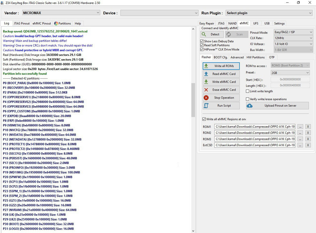

Backup saved: H8G4u_C38364F9_20190809_153604.extcsd
Operation: Writing all eMMC Regions...
Operation: Writing BootConfig ...
Done
Writing to: ROM2 , start: 0x000000000000 , size: 0x000000400000
Filename: EMMC_QN16BB_ROM2_000000000000_000000400000.bin
Done writing partition. Write speed: 59.72 KB/s
Writing to: ROM3 , start: 0x000000000000 , size: 0x000000400000
Filename: EMMC_QN16BB_ROM3_000000000000_000000400000.bin
eMMC switching to ROM3
Done writing partition. Write speed: 59.82 KB/s
Writing to: ROM1 , start: 0x000000000000 , size: 0x00000C000000
Filename: EMMC_QN16BB_ROM1_000000000000_00000C000000.bin
Done writing partition. Write speed: 119.75 KB/s
All done time: [00:29:41:413]
