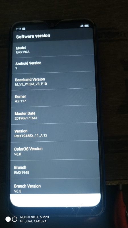

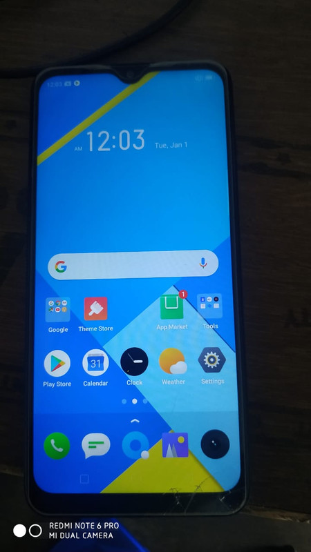

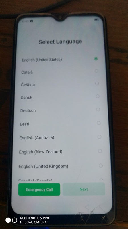

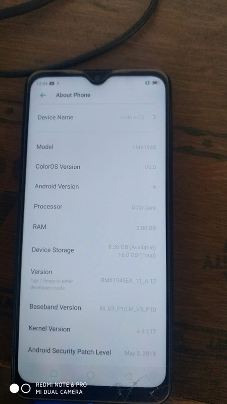

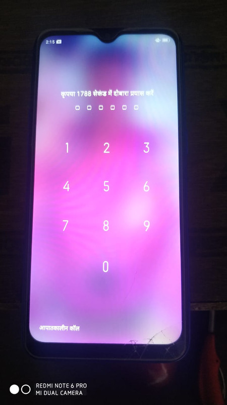

Realme C2 ( RMX1941 / RMX1945 ) Remove Userlocks + Frp Lock Done By Easy Jtag Plus

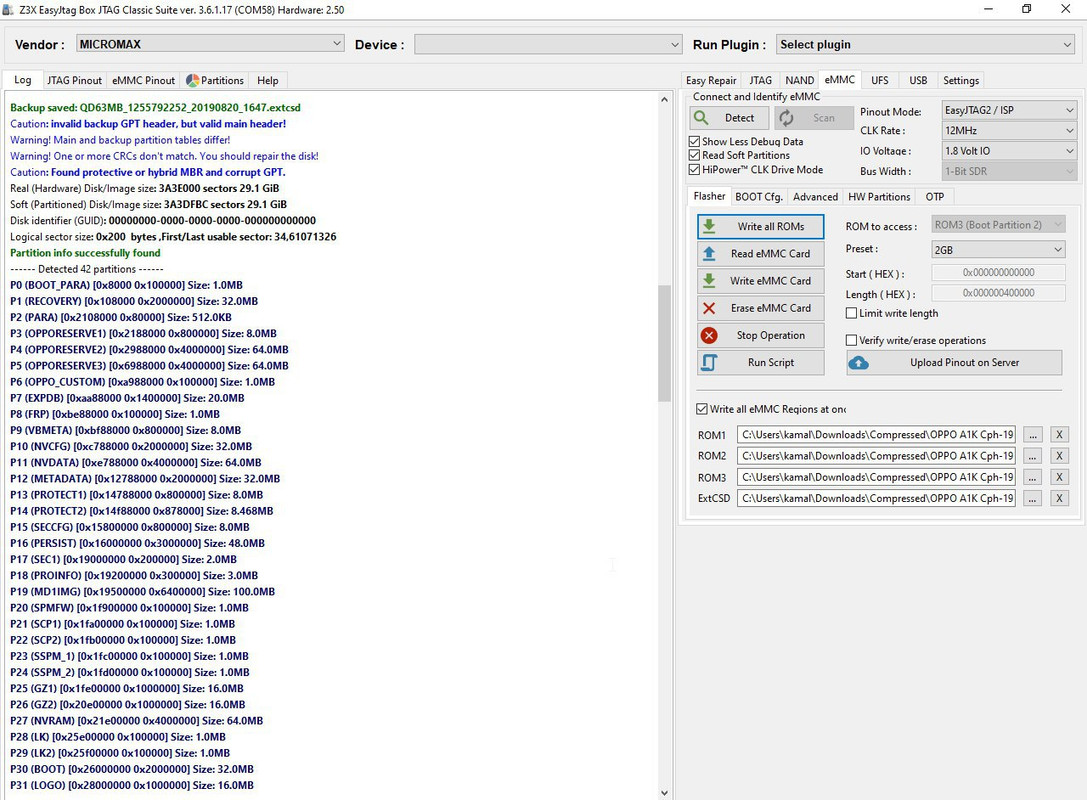

10/6/2020 8:19:18 PM> Filename: ROM2.bin
10/6/2020 8:19:18 PM> eMMC switching to ROM2
10/6/2020 8:19:18 PM> Writing partition...
10/6/2020 8:19:22 PM> Done writing partition. Write speed: 1097.85 KB/s
10/6/2020 8:19:23 PM>
10/6/2020 8:19:23 PM> Writing to: ROM1 , start: 0x000000000000 , size: 0x00003C390000
10/6/2020 8:19:23 PM> Filename: ROM1_1GB.bin
10/6/2020 8:19:23 PM> eMMC switching to ROM1
10/6/2020 8:19:23 PM> Writing partition...
10/6/2020 8:23:31 PM> Done writing partition. Write speed: 3990.29 KB/s
10/6/2020 8:23:31 PM> All done time: [00:04:12:595]
