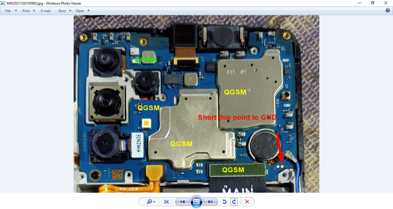

samsung A11 Android 11 Reset FRP via Qcfire
Operation : Reset FRP
Port : Qualcomm HS-USB QDLoader 9008 (COM59)
Driver Info : Qualcomm Incorporated, qcusbser.sys, 2.1.3.5
Opening Port...OK
Init Handshake Sequence...OK
Hardware ID : E1A00900 [8953] 00002000
OPK_DATA : 7A1DF77CBFBB0788FC8EA8D75792F665B38495C74C24E98E5908F89AAC71A27C
Initializing Protocol...OK
Preparing Loader...Done
Sending Loader [8953_050]...Done
Executing Loader...OK
Detecting Chip Type...OK
Hardware : 8953, EMMC, 32 GB
LU Count : 1 [0x03A3E000]
Payload Info : In: 65536 [4096], Out: 1048576, Sector Size: 512
Reading Partition Table...OK
Software : RP1A.200720.012.A115FXXU2BUH4, A115FXXU2BUH4 [Mon Aug 9 10:02:55 +07 2021]
Android Ver. : 11
Patch Level : 2021-07-01
Resetting FRP Lock......Done
Operation Finished.

Samsung m32 frp done by umt
Operation : MTK One Click
Hold VOL UP + DOWN and connect USB Cable.
Some phone may have different key combination for BROM mode.
Waiting for device in BROM mode...
Port: COM4 [MediaTek USB Port (COM4)]
Device Path: \\?\usb#vid_0e8d&pid_0003#6&226836f9&0&4#{86e0d1e0-8089-11d0-9ce4-08003e301f73}
Chipset: 0x0707, [MT6768] [Helio P65/G85 k68v1]
Hardware Info: 0x8A00, 0xCA00, 0x00
Config : [SecureBoot: True] [SLA: False] [DA Auth: True]
Preparing device...
-- Success!
Preloader saved as : preloader_k69v1_64_titan_marmot_211202_195710.bin
DA : MTK_AllInOne_DA.bin
Waiting for Phone in Flash Mode...
Connect Power Off phone within 30 secs...
Port : MediaTek USB Port (COM4)
Connected to BROM.
Sending Download Agent...
Connected to Download Agent..
Syncing with Target...
Storage : eMMC
Reading Information...
Build Date : Tue Aug 3 19:44:53 KST 2021
Build Flavor : a32xx-user
Build Desc. : a32xx-user 11 RP1A.200720.012 A325FXXU1AUH1 release-keys
Android Ver. : 11
Display ID : RP1A.200720.012.A325FXXU1AUH1
Patch Level : 2021-08-01
Platform : MT6768
Board : k69v1_64_titan_marmot
Platform : mt6768
Userdata is ENCRYPTED
Seeking FRP Data...
Resetting FRP...
- Success!
- Resetting FRP[2]...
- Success!
Disconnect Battery/Cable and Power On Phone.
[UltimateMTK Ver. 4.5]
