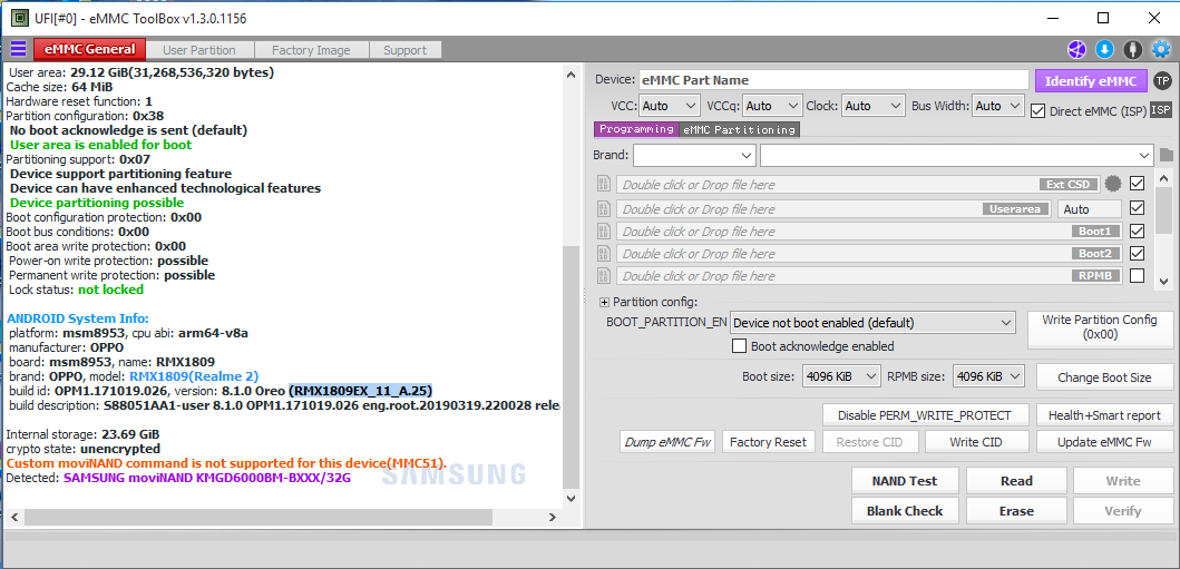

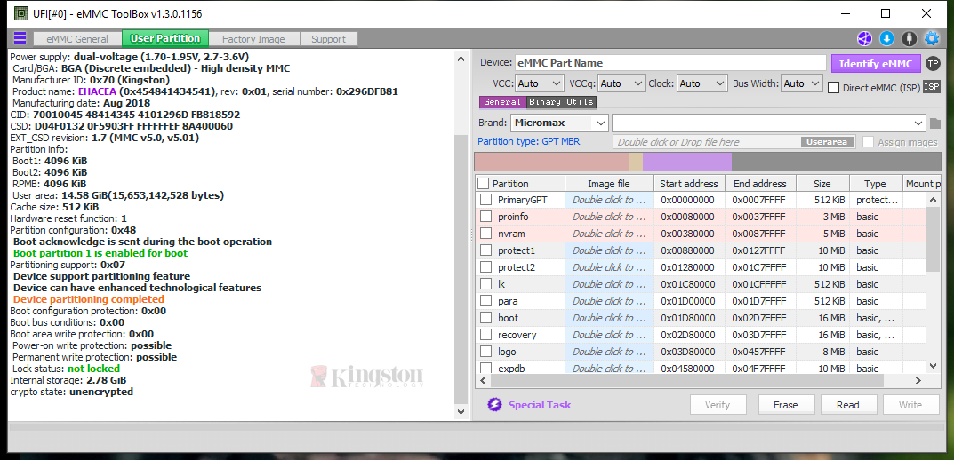

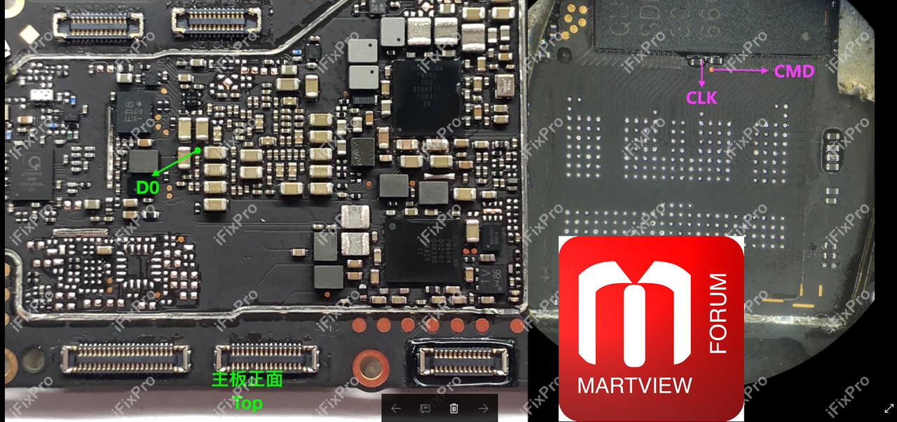

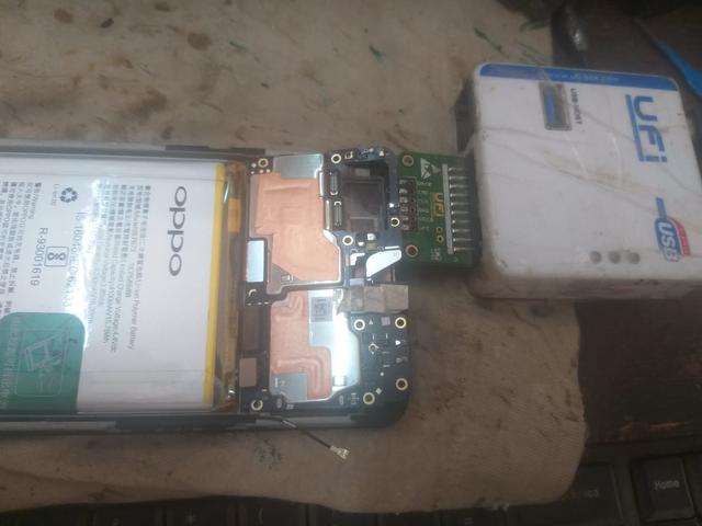

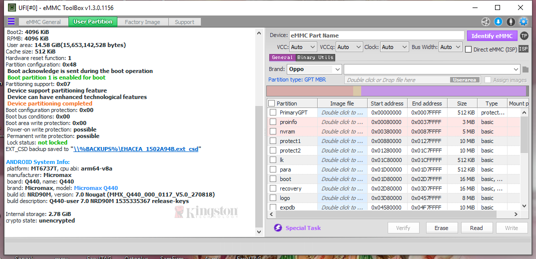

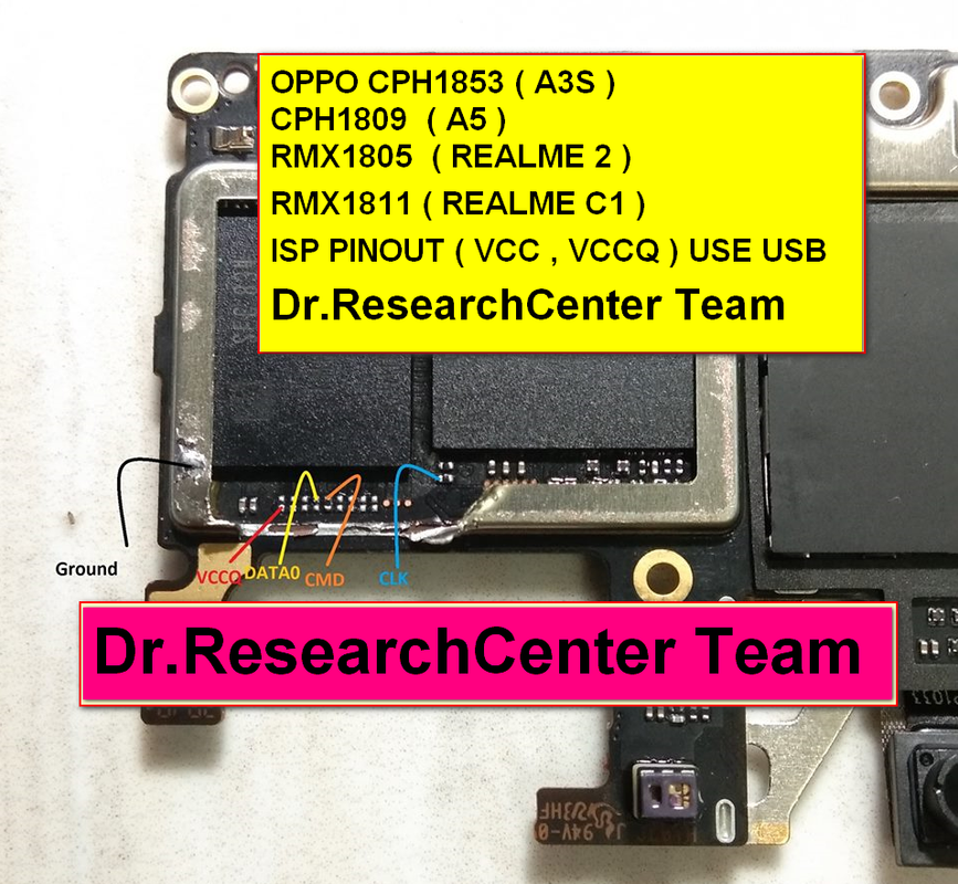

REALMI 2 PRO ( RMX1801 ) + K1 ISP PINOUT
ISP PINOUT ( VCC , VCCQ ) USE USB
not found cmd in rmx1801....plz help

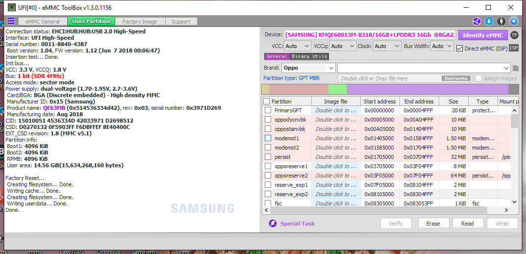

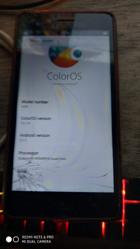

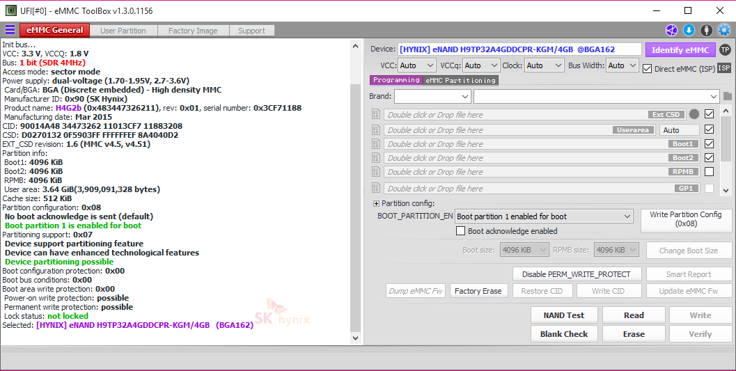

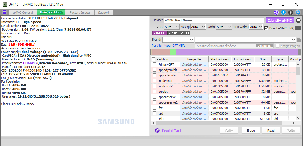

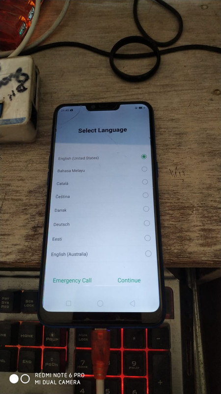

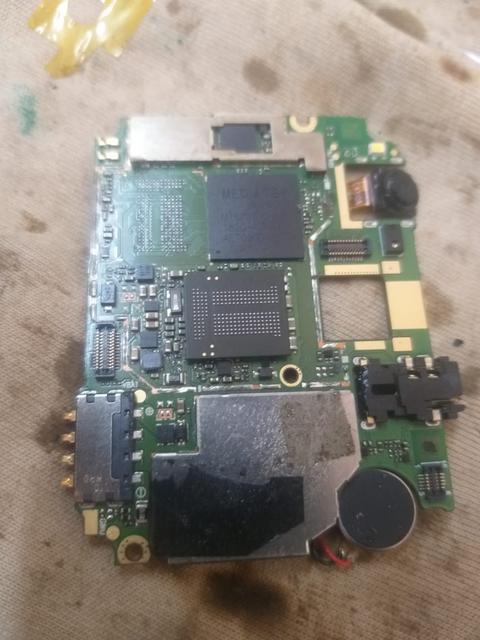

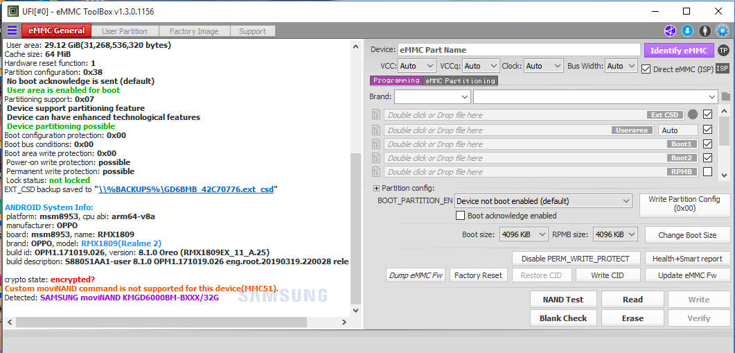

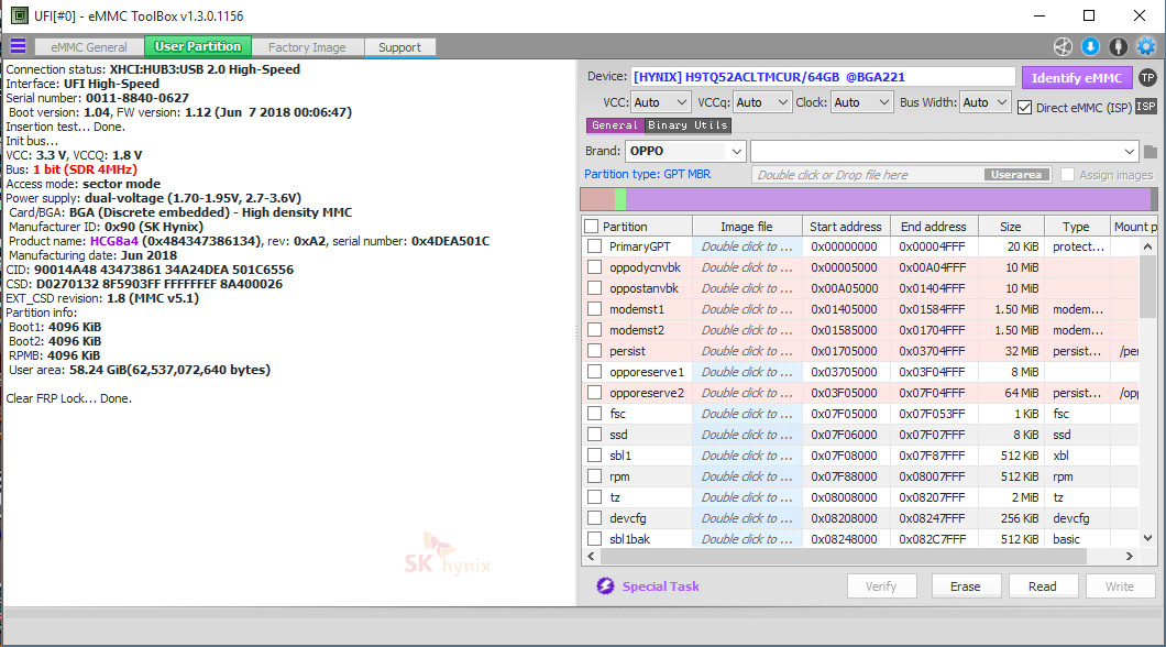

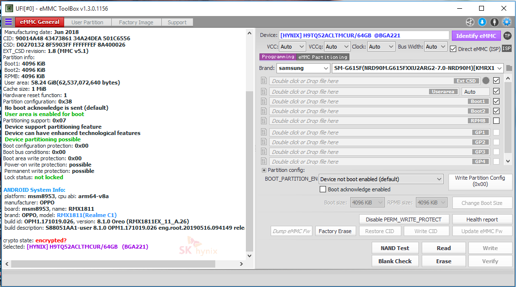

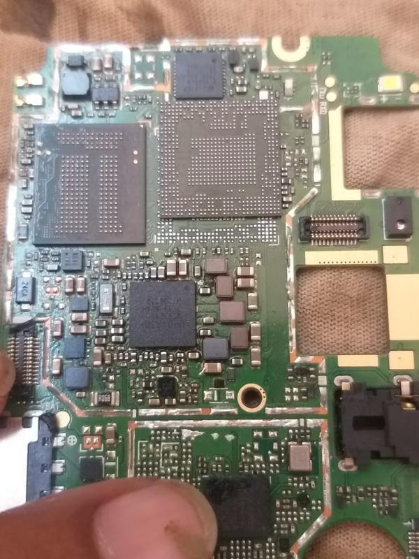

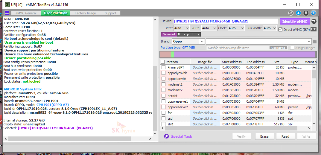

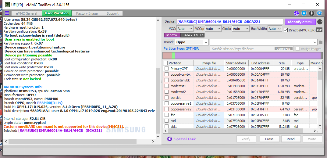

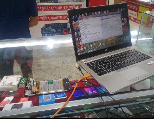

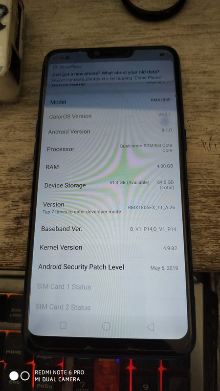

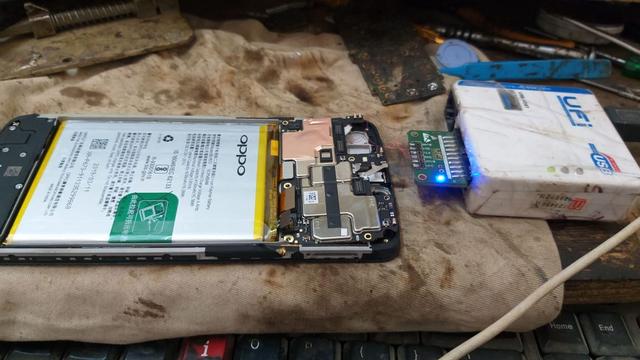

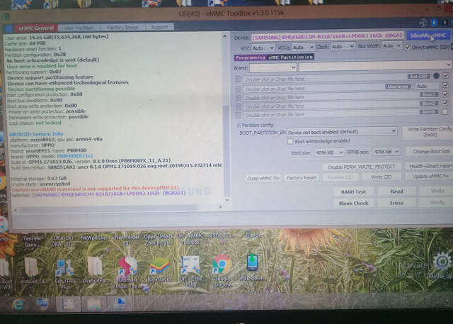

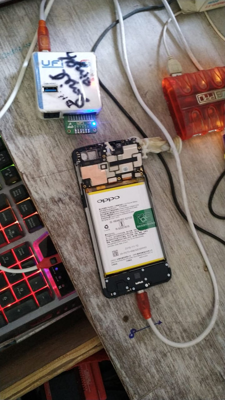

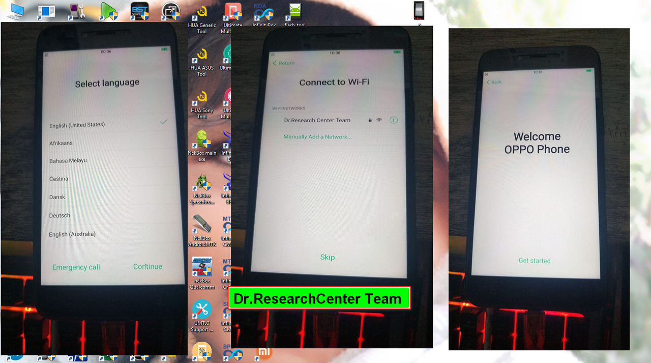

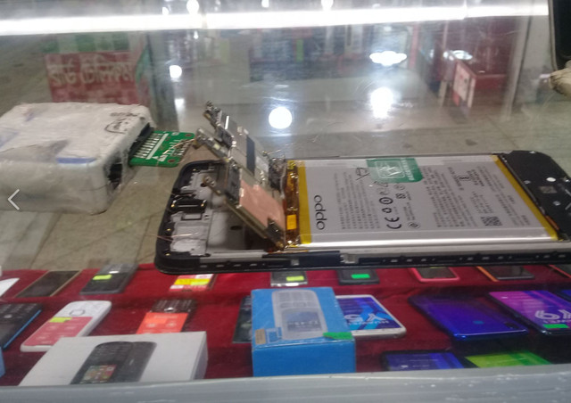

REALME 2 ( RMX1805EX )_11_A.26-8.1.0- FACTORY RESET + FRP BY UFI
1 BOARD IMAGE
2 IDENTIFY EMMC
3 FACTORY RESET ( REMOVE PIN LOCK )
4 FRP RESET LOCK..
5 ANDROID SYSTEM INFO ( FULL LOG )
6 AFTER REMOVE USER LOCKS

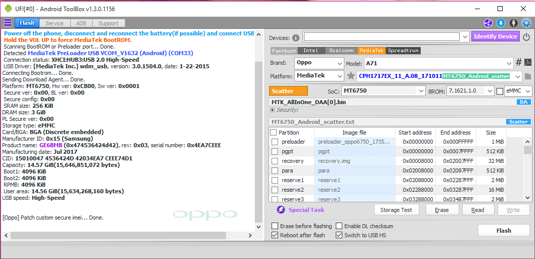

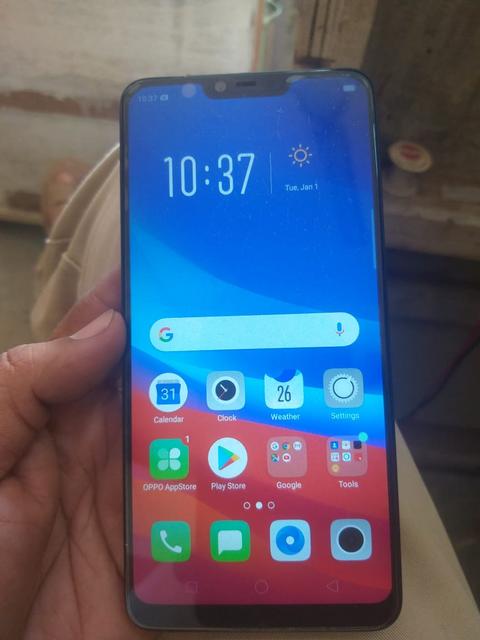

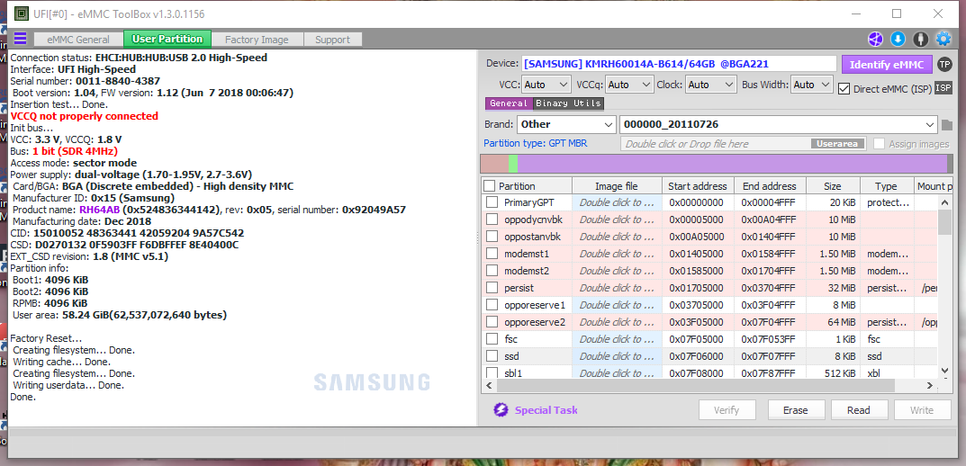

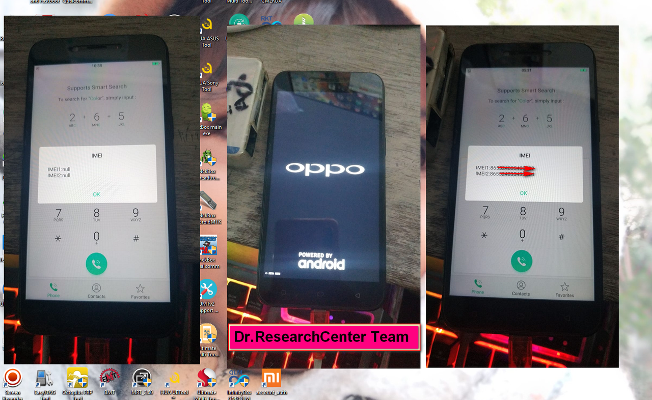

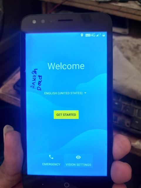

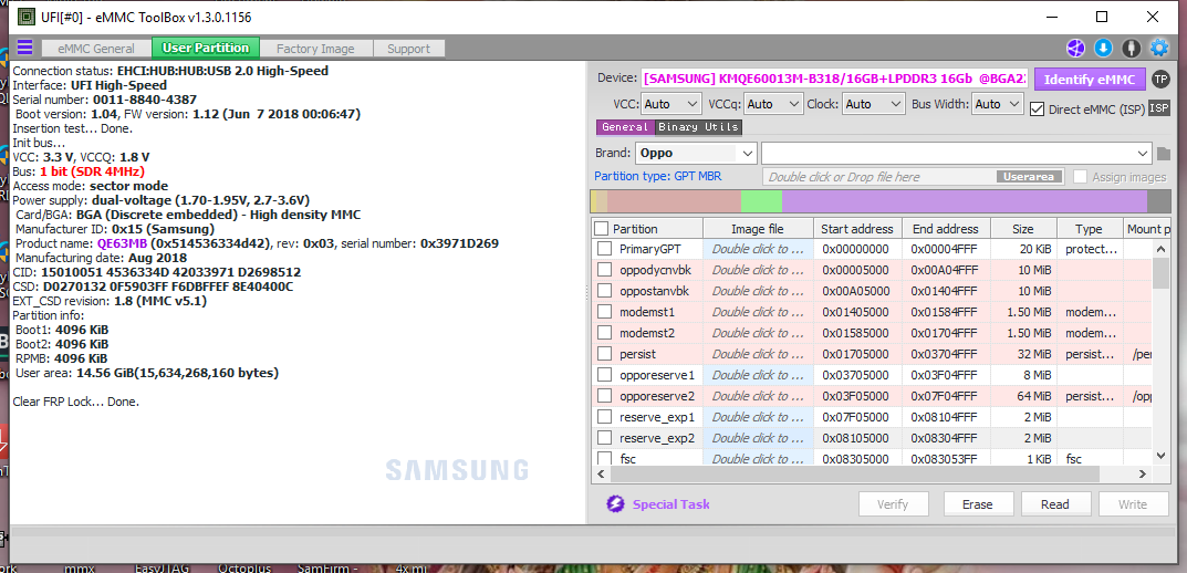

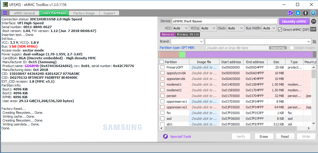

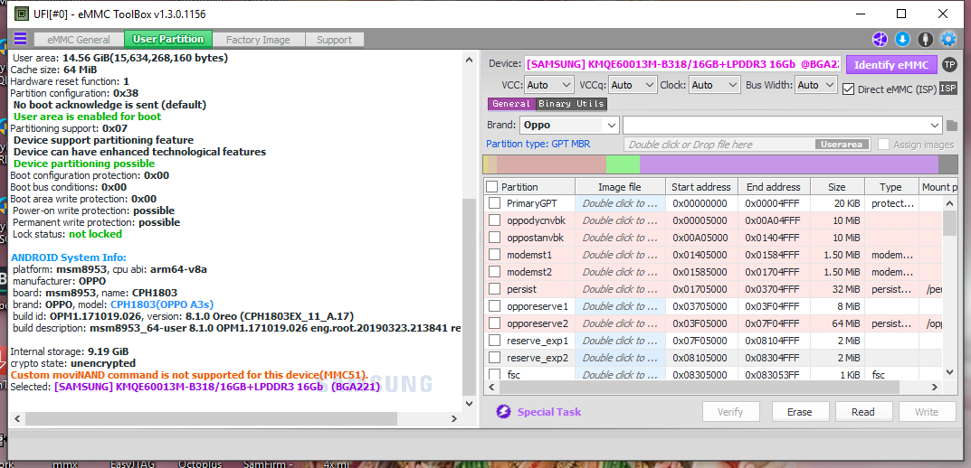

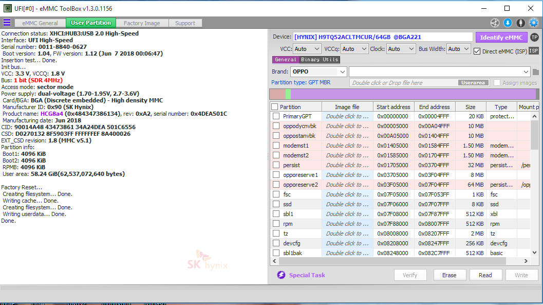

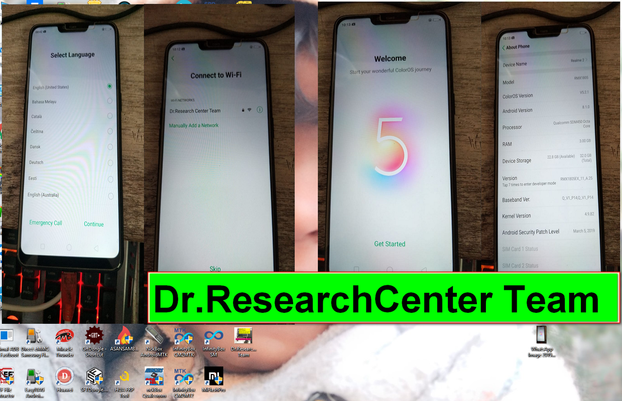

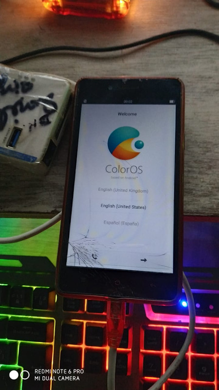

Oppo A5_CPH1809 Factory Reset Done..........//

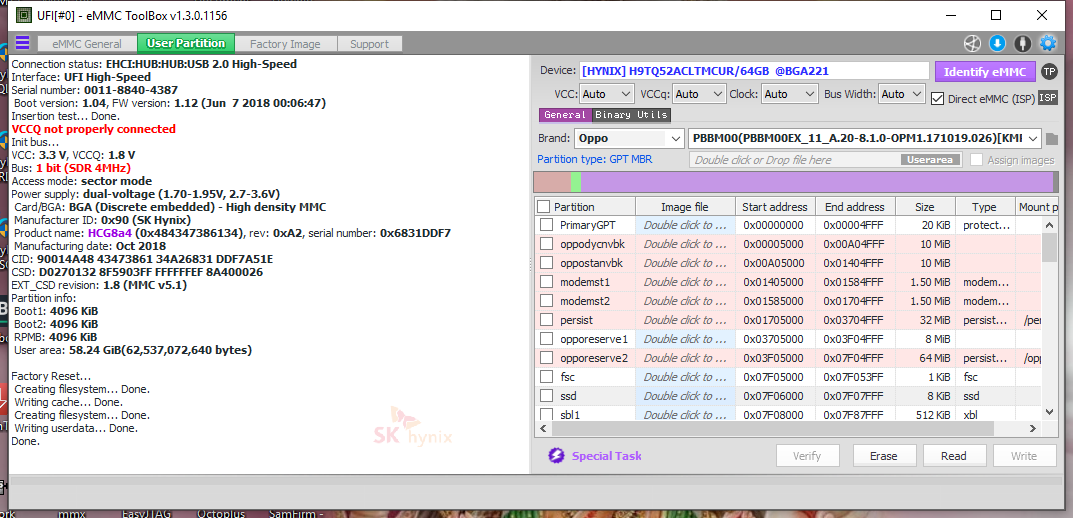

Connection status: IUSB3HUB:USB 2.0 High-Speed
Interface: UFI High-Speed
Serial number: 00x1-xxx0-xxxx
Boot version: 1.04, FW version: 1.12 (Jun 7 2018 00:06:47)
Insertion test... Done.
Init bus...
VCC: 3.3 V, VCCQ: 1.8 V
Bus: 1 bit (SDR 4MHz)
Access mode: sector mode
Product name: RD64MB (0x524436344d42), rev: 0x01, serial number: 0xCE02CC8A
Manufacturing date: Feb 2018
CID: 15010052 4436344D 4201CE02 CC8A254C
CSD: D0270132 0F5903FF F6DBFFEF 8E40400C
EXT_CSD revision: 1.8 (MMC v5.1)
Partition info:
Boot1: 4096 KiB
Boot2: 4096 KiB
RPMB: 4096 KiB
User area: 29.12 GiB(31,268,536,320 bytes)
Cache size: 64 MiB
Hardware reset function: 1
Partition configuration: 0x38
No boot acknowledge is sent (default)
User area is enabled for boot
Partitioning support: 0x07
Device support partitioning feature
Device can have enhanced technological features
Device partitioning possible
Boot configuration protection: 0x00
Boot bus conditions: 0x00
Boot area write protection: 0x00
Power-on write protection: possible
Permanent write protection: possible
Lock status: not locked
EXT_CSD backup saved to "\\%BACKUPS%\RD64MB_CE02CC8A.ext_csd"
ANDROID System Info:
platform: msm8953, cpu abi: arm64-v8a
manufacturer: OPPO
board: msm8953, name: CPH1809
brand: OPPO, model: CPH1809(OPPO A5)
build id: OPM1.171019.026, version: 8.1.0 Oreo (CPH1809EX_11_A.22)
build description: S88051AA1-user 8.1.0 OPM1.171019.026 eng.root.20190509.095130 release-keys
crypto state: encrypted?
Custom moviNAND command is not supported for this device(MMC51).
Detected: SAMSUNG moviNAND KMRD60004M-BXXX/32G
:Y: FACTORY RESET BY UFI............../
Serial number: 0x1x-8xxx-8xxx
Init bus...
Partition info:
Boot1: 4096 KiB
Boot2: 4096 KiB
RPMB: 4096 KiB
Factory Reset...
Creating filesystem... Done.
Writing cache... Done.
Writing userdata... Done.
Done.
