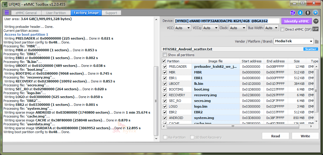

Lenovo A319 Write Flash With UFI Box
Info
BROM version[0]: 7.1625.3.0
Loading DA: MTK_AllInOne_DA.bin (6.11 MiB)
version: 3.3001.00.00, start addr: 0x40000800
Connecting to BootROM...
Power off the phone, disconnect and reconnect the battery(if possible) and connect USB cable...
Scanning BootROM or Preloader port... Done.
Detected MediaTek PreLoader USB VCOM Port (COM10)
USB Driver: [MediaTek Inc.] usbser, version: 1.1123.0.0, date: 5-30-2011
Connecting Bootrom... Done.
Sending Download Agent... Done.
Platform: MT6572_S00, Hw ver: 0xCA00, Sw ver: 0x0000
Secure ver: 0xFF, BL ver: 0x01
Secure config: 0x00
SRAM size: 128 KiB
DRAM size: 512 MiB
PL Secure ver: 0x02
Storage type: eMMC
Card/BGA: BGA (Discrete embedded)
Manufacturer ID: 0x90 (SK Hynix)
Product name: H4G2a (0x483447326111), rev: 0x01, serial number: 0x69B2A86A
Manufacturing date: May 2015
CID: 90014A48 34473261 110169B2 A86A528B
Capacity: 3.65 GiB(3,921,674,240 bytes)
Boot1: 4096 KiB
Boot2: 4096 KiB
RPMB: 4096 KiB
User area: 3.64 GiB(3,909,091,328 bytes)
USB speed: High-Speed
platform: MT6572, cpu abi: armeabi-v7a
manufacturer: LENOVO
board: A319, name: A319
brand: Lenovo, model: Lenovo A319
build id: MocorDroid4.4.2, version: 4.4.2 Lollipop (A319_ROW_DS_S319_161222)
build description: huaqin72_cwet_1a_kk-user LenovoA319 A319_ROW_DS_S319_161222 release-keys
build version: A319_ROW_DS_S319_161222
lcd: ili9806e_dsi_vdo_dijing otm8019a_dsi_vdo_dijing ili9806c_dsi_vdo_dijing
screen resolution: 800 x 480
main camera: ov5645_mipi_yuv
lens: sensordrive
front camera: gc2035_yuv hi257_yuv
audio: amp_aw8145
touch: ft6206 GT9XX
modem: HUAQIN72_CWET_1A_KK_HSPA_MASTER_0113
Write Flash
Secure config: 0x00
SRAM size: 128 KiB
DRAM size: 512 MiB
PL Secure ver: 0x02
Storage type: eMMC
Boot1: 4096 KiB
Boot2: 4096 KiB
RPMB: 4096 KiB
Verifying SoC: passed
Verifying CID: passed
Writing MBR, size: 512 bytes
Writing EBR1, size: 512 bytes
Writing UBOOT, size: 384 KiB
Writing BOOTIMG, size: 6 MiB
Writing RECOVERY, size: 4.45 MiB
Writing SEC_RO, size: 132 KiB
Writing LOGO, size: 226.02 KiB
Writing ANDROID, size: 1.46 GiB
Writing CACHE, size: 5.87 MiB
Writing USRDATA, size: 11.92 MiB
Completed in 5 mins 41.183 s

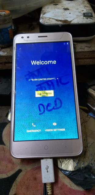

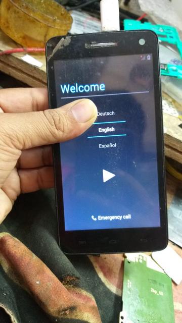

Dr.sunilsingh
Aug 2, 2018
402
816
india
[email protected]
1681209

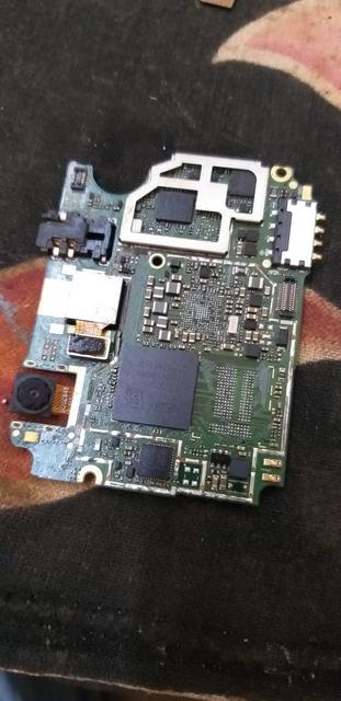

Dead Recover :G: VIVO Y31L :Y: Rog File Dead
:S: Finally Reprogramme Emmc Repaired/Dead Sucessfully By Ufi Box :S:
1 :down:Rong File Dead Ufi Log
2 Backups Read
3 Reprogramme Emmc
4 :up: Sucessfully VIVO Y31L Write File
5 Backups Write
6 Emmc Universal Flashing Interface
7 Emmc Remove
8 Qfil Flash Succeed
9 Sucessfully Alive Handset
10 About Phone
