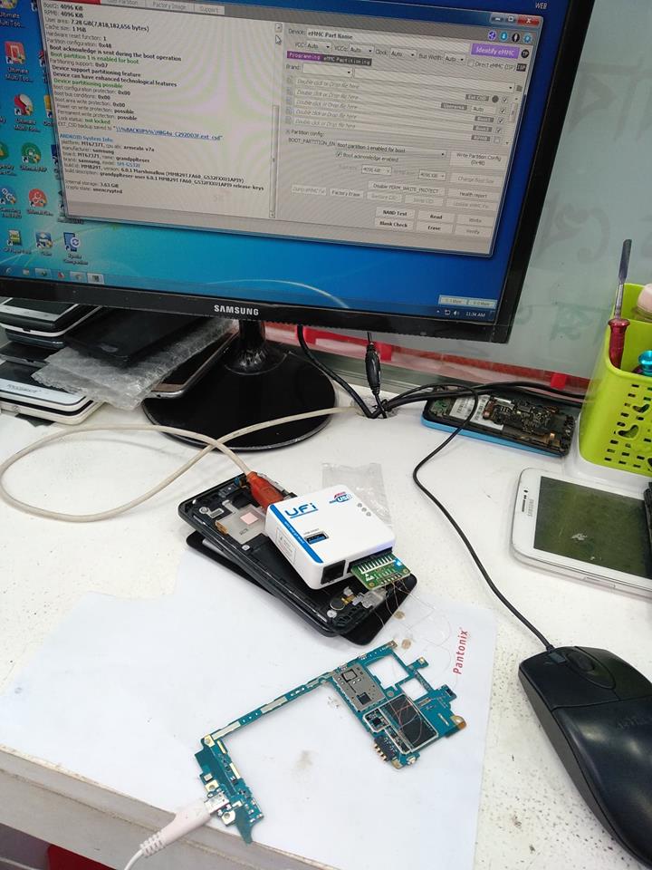

SM-G531H SUCCESFULLY REPAIRED EFS AND OTHER FILES BY UFI
Connection status: XHCI:HUB3:USB 2.0 High-Speed
Interface: UFI High-Speed
Serial number: 0011-8840-4224
Boot version: 1.04, FW version: 1.12 (Jun 7 2018 00:06:47)
Insertion test... Done.
Init bus...
VCC: 2.8 V, VCCQ: 1.8 V
Bus: 1 bit (SDR 4MHz)
Access mode: sector mode
Manufacturer ID: 0xFE (Micron)
Product name: P1J95K (0x50314a39354b), rev: 0x13, serial number: 0x7271E1AB
Manufacturing date: Jul 2015
CID: FE014E50 314A3935 4B137271 E1AB7240
CSD: D07F0132 0F5913FF FFFFFFEF 924000A2
EXT_CSD revision: 1.6 (MMC v4.5, v4.51)
Partition info:
Boot1: 4096 KiB
Boot2: 4096 KiB
RPMB: 4096 KiB
User area: 7.28 GiB(7,818,182,656 bytes)
Cache size: 256 KiB
Partition configuration: 0x08
No boot acknowledge is sent (default)
Boot partition 1 is enabled for boot
Partitioning support: 0x07
Device support partitioning feature
Device can have enhanced technological features
Device partitioning possible
Boot configuration protection: 0x00
Boot bus conditions: 0x00
Boot area write protection: 0x00
Power-on write protection: possible
Permanent write protection: possible
Lock status: not locked
ANDROID System Info:
platform: sc8830, cpu abi: armeabi-v7a
manufacturer: samsung
board: SC7730SE, name: grandprimeve3gxx
brand: samsung, model: SM-G531H
build id: LMY48B, version: 5.1.1 Lollipop (LMY48B.FA51_G531HXXU0APB2)
build description: grandprimeve3gxx-user 5.1.1 LMY48B FA51_G531HXXU0APB2 release-keys
Internal storage: 5.47 GiB
crypto state: unencrypted
Selected: [Micron] (JWA60)MT29TZZZ8D5BKFAH-125W/8GB (BGA221)
Init bus...
VCC: 3.3 V, VCCQ: 1.8 V
Partition info:
Boot1: 4096 KiB
Boot2: 4096 KiB
RPMB: 4096 KiB
Re-partitioning... Done.
Writing MBR, GPT at 0x00000000-0x000043FF (34 sectors)... Done in 0.057 s
Processing file: "BL_G531HDXS0AQC1_CL1143454_QB12737076_REV01_user_low_ship.tar.md5\spl.img", size: 32 KiB...
Extracting tar spl.img... Done.
Current partition access:
Access to boot partition 1
Writing BOOT at 0x00000000-0x0007FFFF (1024 sectors)... Done in 2.173 s
Processing file: "GRANDPRIMEVE3G_EUR_OPEN.pit\GRANDPRIMEVE3G.pit", size: 5.02 KiB...
Access to user area
Writing PIT at 0x00080000-0x000FFFFF (11 sectors)... Done in 0.049 s
Processing file: "BL_G531HDXS0AQC1_CL1143454_QB12737076_REV01_user_low_ship.tar.md5\sboot.bin", size: 1.50 MiB...
Extracting tar sboot.bin... Done.
Writing SBOOT at 0x00400000-0x005FFFFF (4096 sectors)... Done in 4.443 s
Processing file: "BL_G531HDXS0AQC1_CL1143454_QB12737076_REV01_user_low_ship.tar.md5\sboot2.bin", size: 1.50 MiB...
Extracting tar sboot2.bin... Done.
Writing SBOOT2 at 0x00600000-0x007FFFFF (4096 sectors)... Done in 4.441 s
Processing file: "BL_G531HDXS0AQC1_CL1143454_QB12737076_REV01_user_low_ship.tar.md5\param.lfs", size: 560 KiB...
Extracting tar param.lfs... Done.
Writing PARAM at 0x02900000-0x02AFFFFF (4096 sectors)... Done in 4.440 s
Writing boot partition config to 0x08... Done.

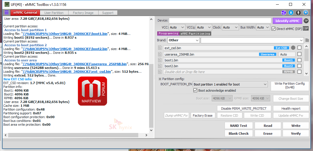

SAMSUNG SM-G532F DEAD RECOVER DONE BY UFi BOX

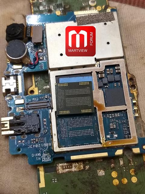

change emmc asus t00f a500cg.
programing emmc and flash eng frimware and repair imei with ufi done.

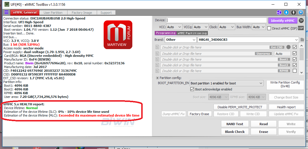

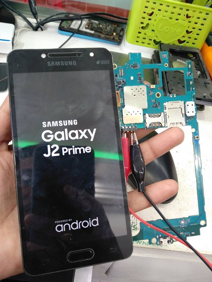

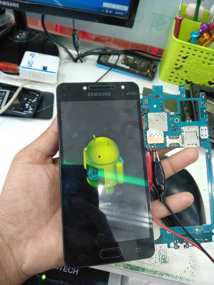

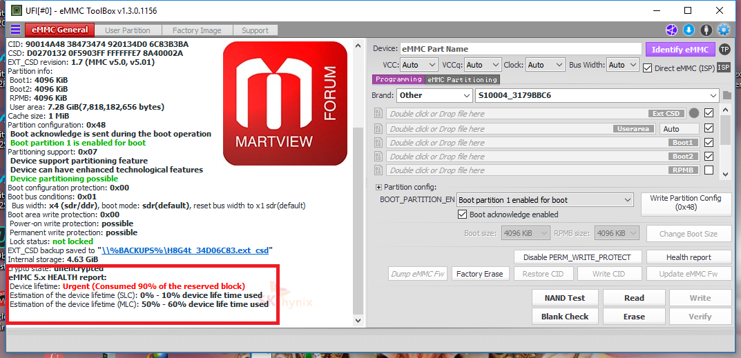

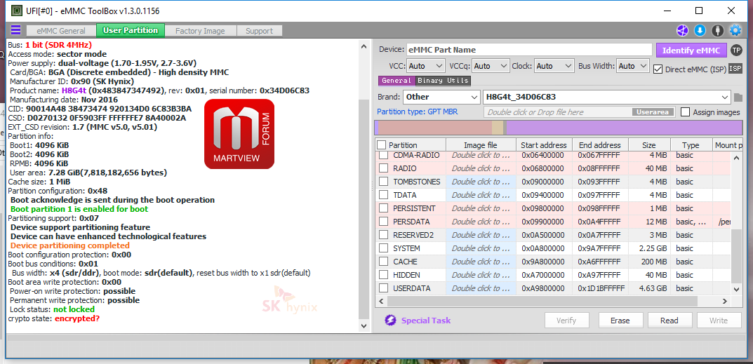

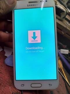

Samsung J2(J200G) Always Goes In Download Mode Try All Trick But Not Solved Last Reprogram
With
Ufi-Box Job Done(Full Explained Image Tutor)
Always Start With Download Mode

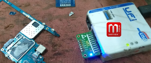

Isp Connection With Ufi-Box
Log Before Repair Emmc(Device Life-Time Error)
Repair Emmc Restore Security Backup(Phone Backup 256Mb)

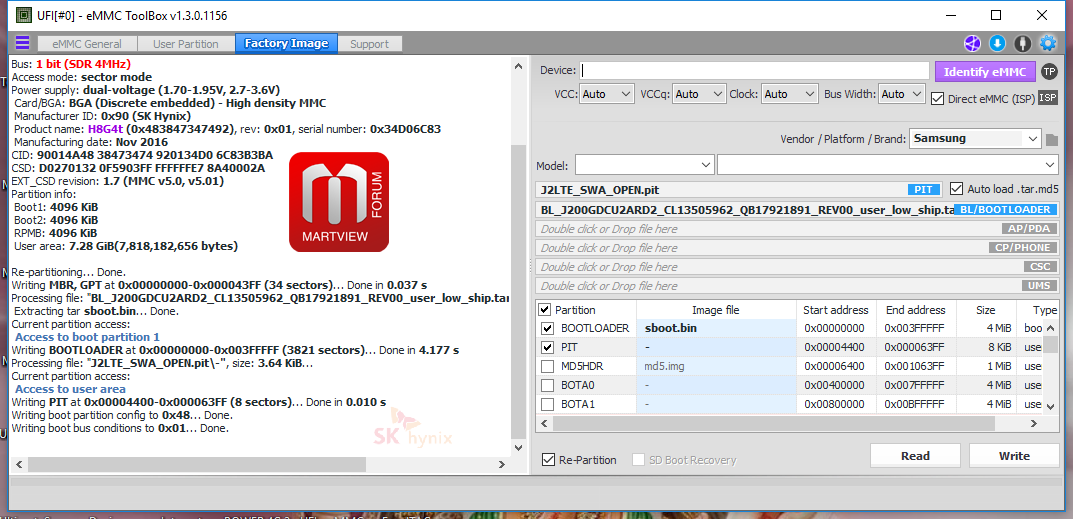

Write Pit And Bl File
After Complete Repair Log All Ok

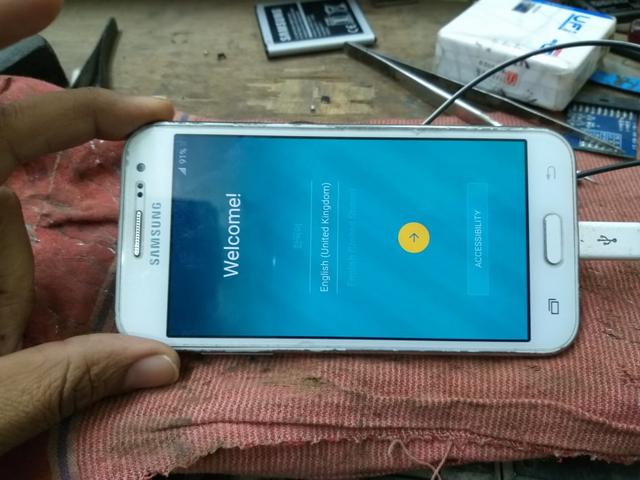

Finally Set Alive
