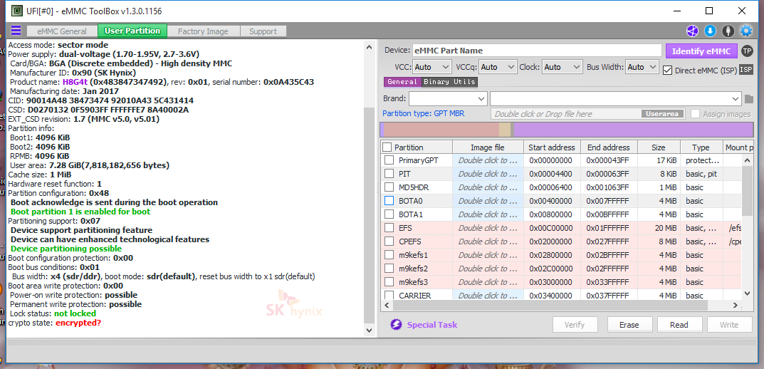

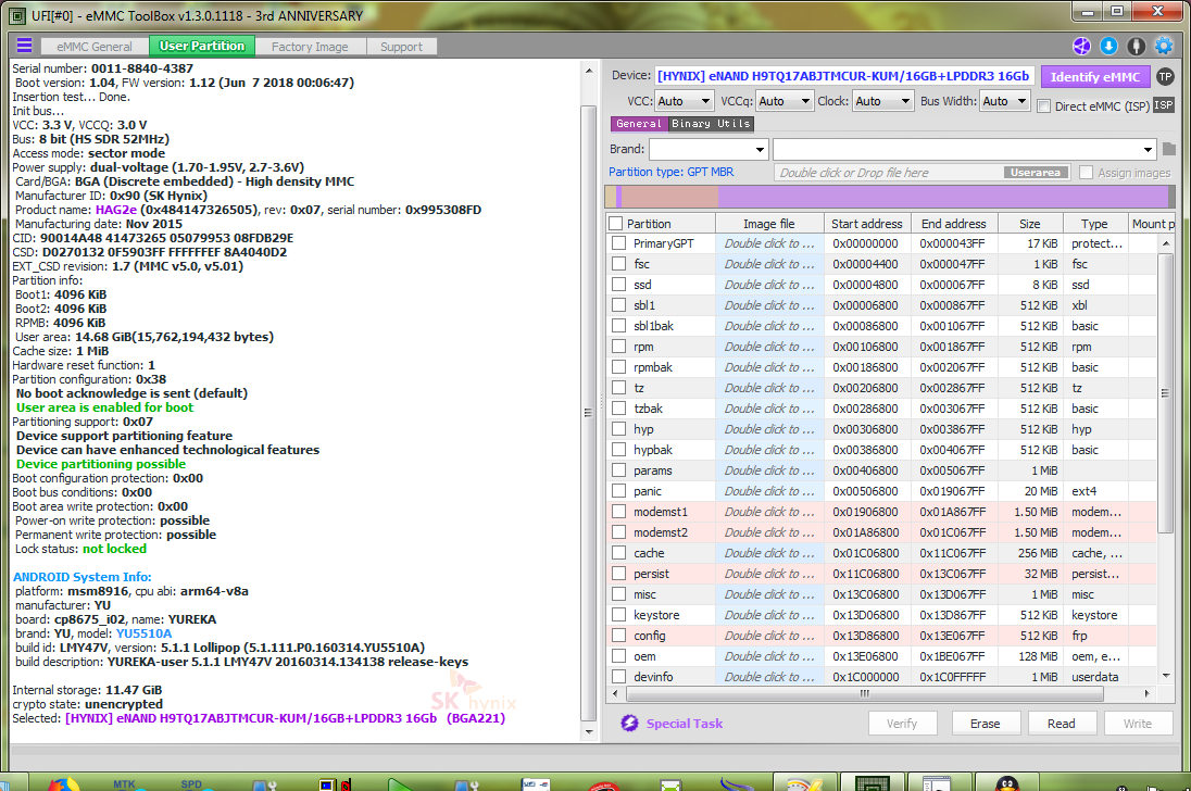

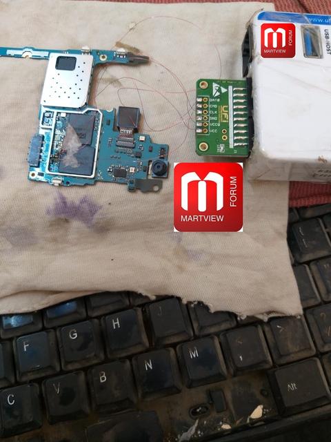

Protect eMMC Replace And Repair Ufi Box
Here Is eMMC Test
Build New eMMC With Ufi Box
Then Remove Old eMMC From Phone And Change it With New eMMC Then Flash With Any Tool
I am Using NCK Dongle Here For Flashing
Result

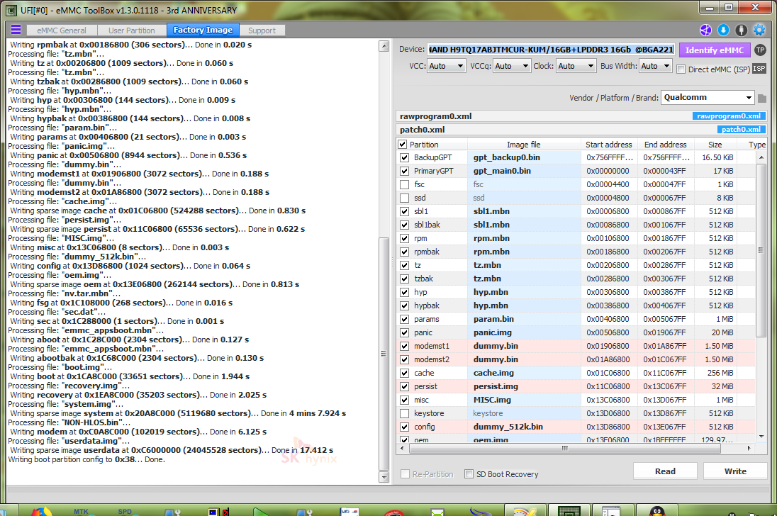

Oppo A83 Write Flash Done
AUTH info: MTK, version: 1
BROM version[1]: 7.1817.3.0
Loading DA: MTK_AllInOne_DAA[0].bin (514.33 KiB)
 version: 3.3001.2017/09/22018/11/05 21:28:46, start addr: 0x40000800
Connecting to BootROM...
 Power off the phone, disconnect and reconnect the battery(if possible) and connect USB cable...
 Hold the VOL UP to force MediaTek BootROM.
 Scanning BootROM or Preloader port... Done.
 Detected MediaTek USB VCOM (Android) (COM1028)
 Connection status: NUSB3HUB:USB 1.16 High-Speed
 USB Driver: [MediaTek Inc.] usbser, version: 5.1.2600.0, date: 11-15-2007
Connecting Bootrom... Done.
Sending Download Agent... Done.
Platform: MT6763, Hw ver: 0xCA01, Sw ver: 0x0001
 Secure ver: 0x00, BL ver: 0x00
 Secure config: 0x00
 SRAM size: 256 KiB
DRAM size: 3 GiB
SOC ID: ec3c331c4a9097be55c19e1024f58230bef929ccd0daab3e6b7a2243589dc7c9
ME ID: 471afe4d0c027db9ac8b7bc6a0c1dda2
Storage type: eMMC
Card/BGA: BGA (Discrete embedded)
Product name: GD6BMB (0x474436424d42), rev: 0x01, serial number: 0xB8CBA80D
Manufacturing date: Jan 2018
CID: 15010047 4436424D 4201B8CB A80D15C1
Capacity: 29.13 GiB(31,281,119,232 bytes)
 Boot1: 4096 KiB
 Boot2: 4096 KiB
 RPMB: 4096 KiB
 User area: 29.12 GiB(31,268,536,320 bytes)
USB speed: High-Speed
Verifying SoC: passed
Verifying CID: passed
Writing preloader, size: 250.88 KiB
Writing recovery, size: 16.80 MiB
Writing md1img, size: 33.36 MiB
Writing md1dsp, size: 6 MiB
Writing spmfw, size: 39.31 KiB
Writing sspm_1, size: 348.08 KiB
Writing sspm_2, size: 348.08 KiB
Writing lk, size: 647.48 KiB
Writing lk2, size: 647.48 KiB
Writing boot, size: 9.83 MiB
Writing logo, size: 7.29 MiB
Writing tee1, size: 441.83 KiB
Writing tee2, size: 441.83 KiB
Writing system, size: 3.87 GiB
Writing cache, size: 6.10 MiB
Writing userdata, size:
Completed in 4 mins 37.764 s

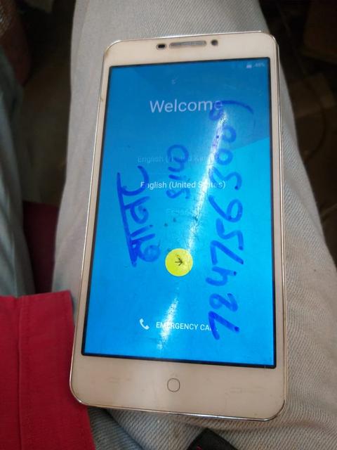

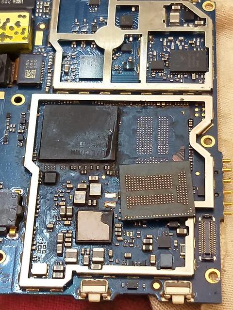

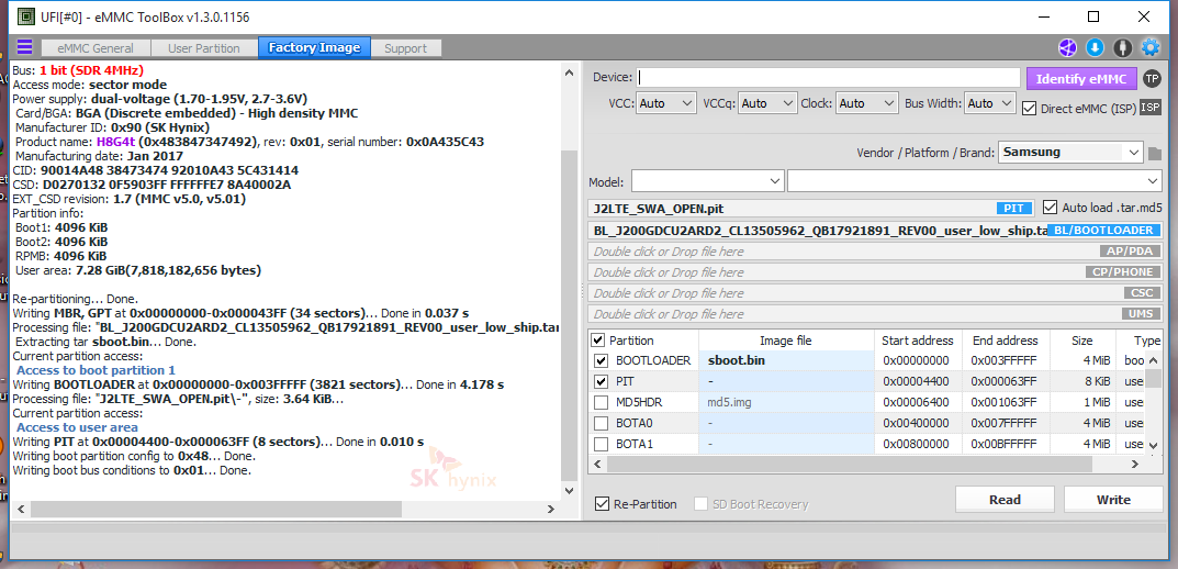

micromax qa106 dead recover done

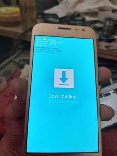

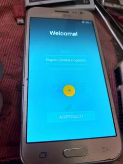

samsung i 9060 dead recover done
