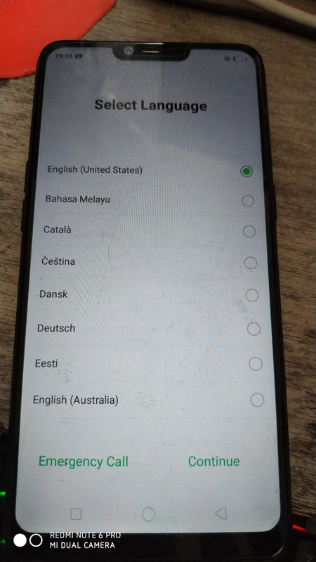

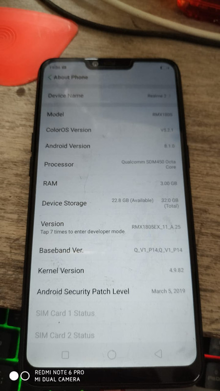

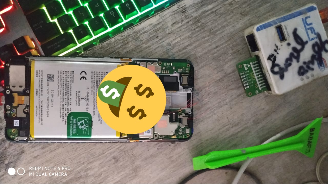

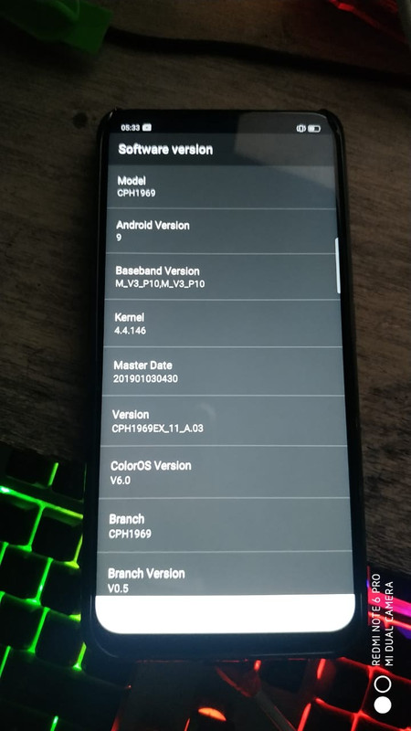

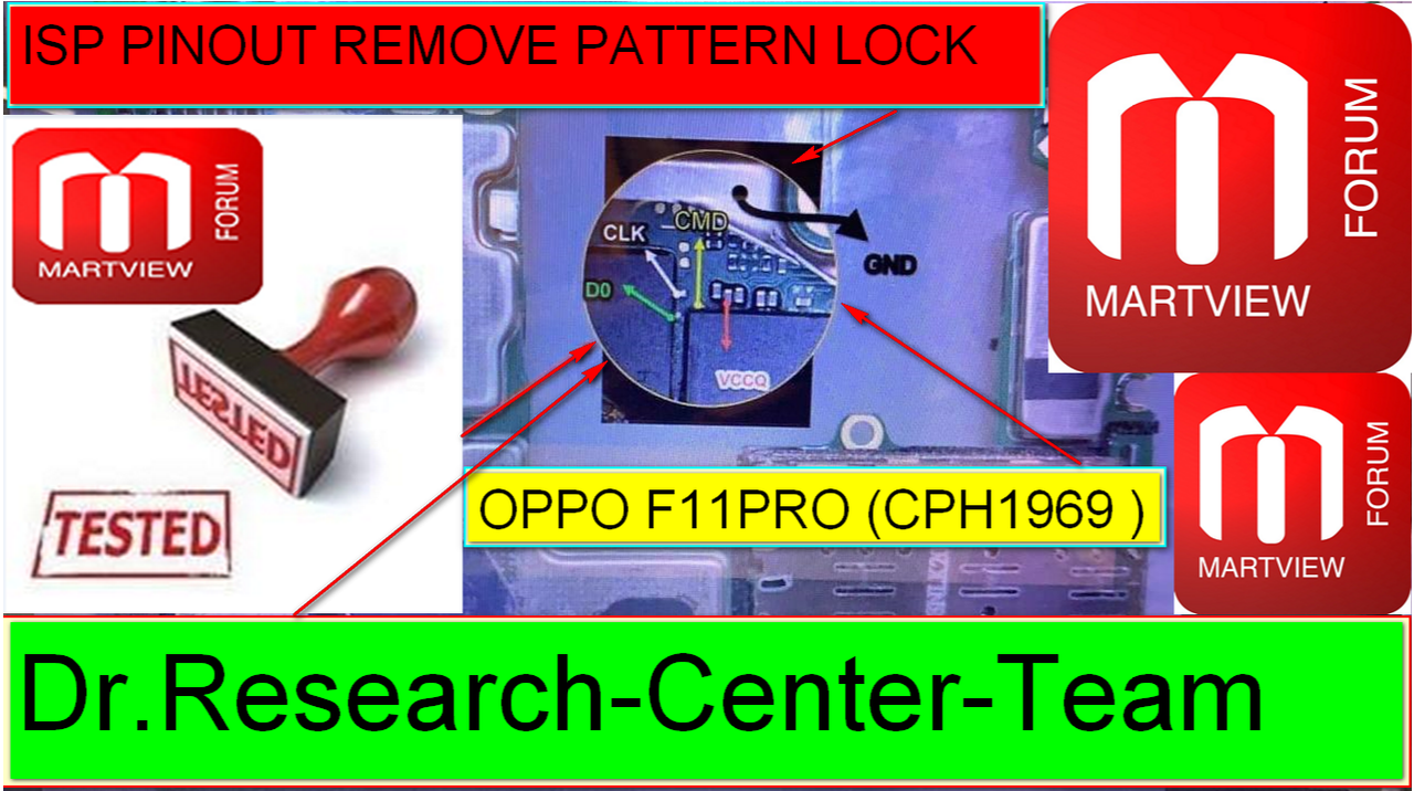

OPPO F11 PRO ( CPH1969 ) Remove Userlocks+Frp Lock Done Without Any Risk Of Stuck On Logo All Job Successfully Done Ufi-Box Only
:Y:
OPPO F11 PRO ( CPH1969 ) ISP PINOUT
User lock Full Info....
Remove User lock Full Info....
:S: Successfully Remove All Lock Handset Working Fine With Out Any Risk :Y:

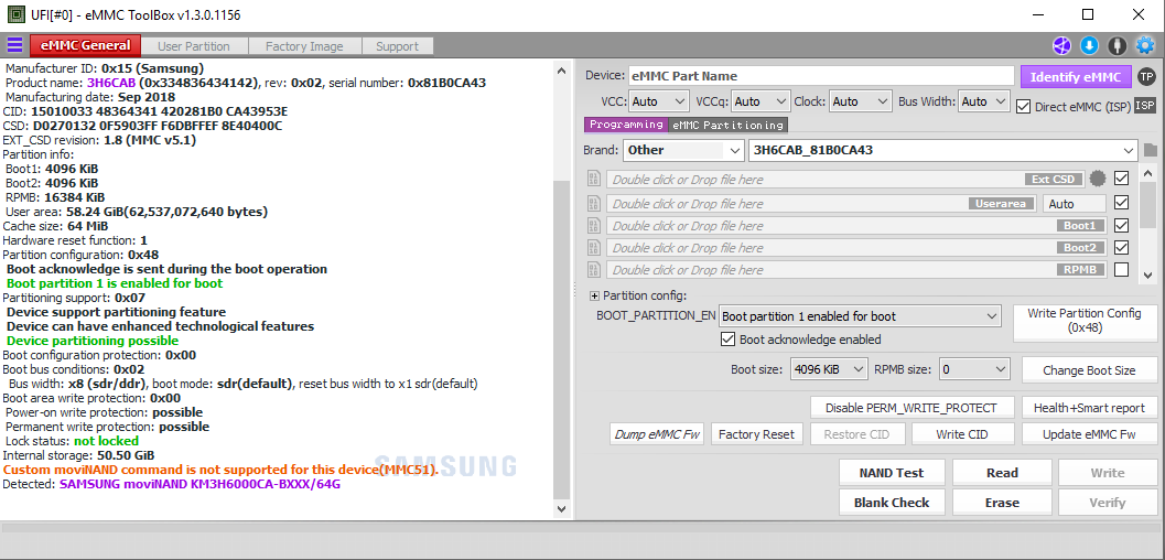

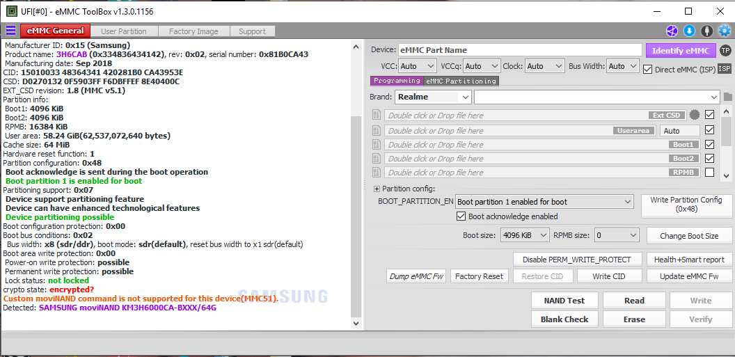

ferouzkassim
Oct 11, 2018
51
34
Uganda
ferouz_kassim
oppo r15 chinese model password remove done(ufi emmc) with no risk
Connection status: EHCI:HUB:HUB:USB 2.0 High-Speed
Interface: UFI High-Speed
Serial number: 0011-8840-4224
Boot version: 1.04, FW version: 1.12 (Jun 7 2018 00:06:47)
Insertion test... CLK not properly connected
Init bus...
VCC: 3.3 V, VCCQ: 1.8 V
Bus: 1 bit (SDR 4MHz)
Access mode: sector mode
Product name: 3V6CMB (0x335636434d42), rev: 0x02, serial number: 0xD31CC817
Manufacturing date: Mar 2018
CID: 15010033 5636434D 4202D31C C81735B8
CSD: D0270132 0F5903FF F6DBFFEF 8E40400C
EXT_CSD revision: 1.8 (MMC v5.1)
Partition info:
Boot1: 4096 KiB
Boot2: 4096 KiB
RPMB: 16384 KiB
User area: 116.48 GiB(125,069,950,976 bytes)
Cache size: 64 MiB
Hardware reset function: 1
Partition configuration: 0x38
No boot acknowledge is sent (default)
User area is enabled for boot
Partitioning support: 0x07
Device support partitioning feature
Device can have enhanced technological features
Device partitioning possible
Boot configuration protection: 0x00
Boot bus conditions: 0x00
Boot area write protection: 0x00
Power-on write protection: possible
Permanent write protection: possible
Lock status: not locked
EXT_CSD backup saved to "\\%BACKUPS%\3V6CMB_D31CC817.ext_csd"
ANDROID System Info:
platform: sdm660, cpu abi: arm64-v8a
manufacturer: OPPO
board: sdm660, name: PAAM00
brand: OPPO, model: OPPO PAAM00(OPPO R15 梦镜版)
build id: OPM1.171019.011, version: 8.1.0 Oreo (PAAM00_11_A.21_181205)
build description: sdm660_64-user 8.1.0 OPM1.171019.011 eng.root.20181205.154632 dev-keys
crypto state: encrypted?
Custom moviNAND command is not supported for this device(MMC51).
Detected: SAMSUNG moviNAND KM3V6000CM-BXXX/128G
Init bus...
Partition info:
Boot1: 4096 KiB
Boot2: 4096 KiB
RPMB: 16384 KiB
Factory Reset...
Creating filesystem... Done.
Writing cache... Done.
Writing userdata... Done.
Done.

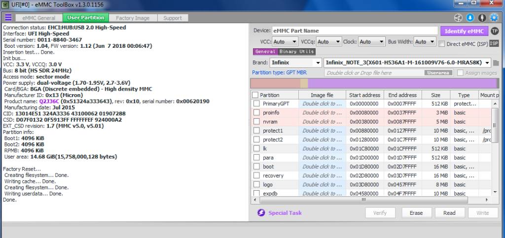

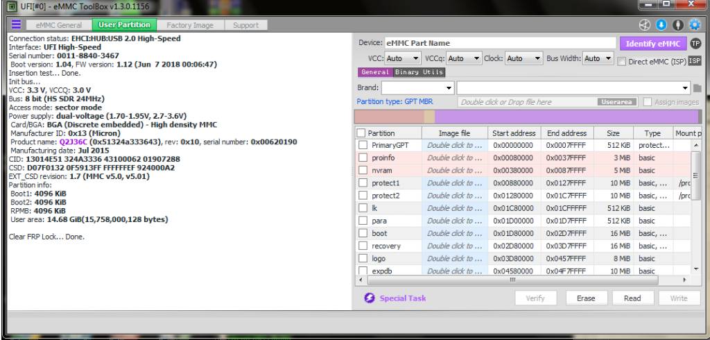

OPPO (cph1911)F11 pattern unlock and isp pinout by ufi box ⬇️ oppo cph1911 f11 test point by #ssm
Reactions: Deepesh Sharma
msibashankar
Sep 27, 2017
349
1,597
india
Realme C2 , Oppo A1k isp pinout lock remove by ufi box this isp pinout support oppo a1k
