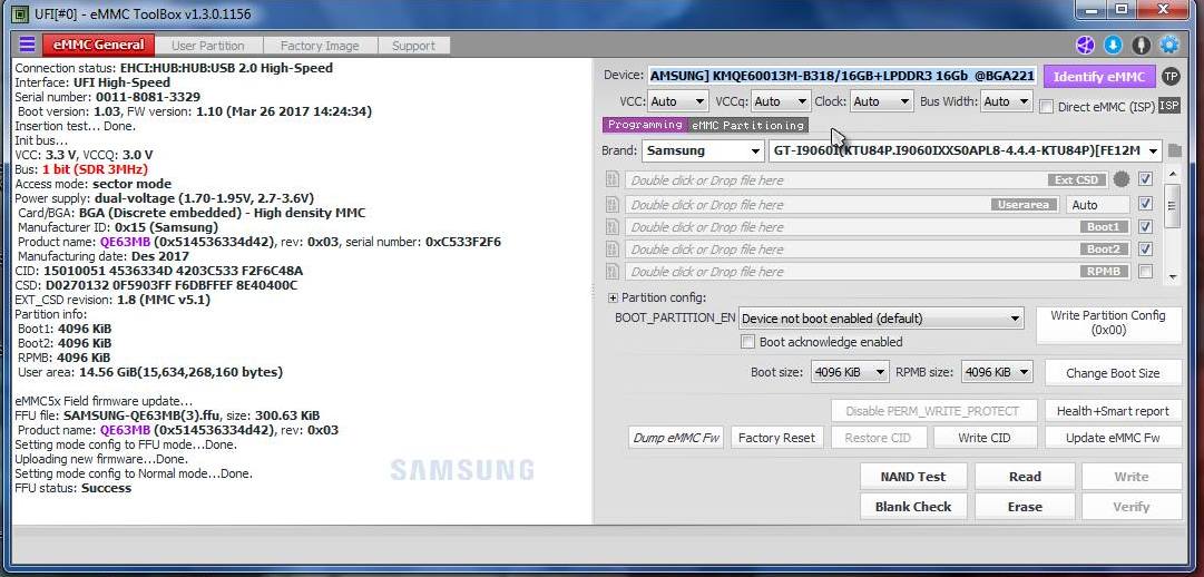

eMMC ToolBox changes:
ADD: eMMC5x Field Firmware Update support
This Field Firmware Update (FFU) is a standard feature introduced to eMMC 5.0 or later
FFU on eMMC5x is slightly different compared to movinand custom ffu, it will not erase data or reset eMMC config.
FFU available via sync:
HYNIX-hB8aP(3).ffu
HYNIX-hDEaP3(2).ffu
MICRON-S0J9D8(167).ffu
MICRON-S0J9F8(16).ffu
SAMSUNG-QE63MB(3).ffu

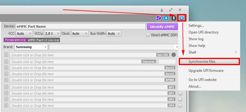

then i open UFI EMMC Tools click Upgrade Firmware
after done upgradieng
then reopen UFI EMMC tools proceed sychronize files
now i can open Android EMMC Tools and access support Download Page
