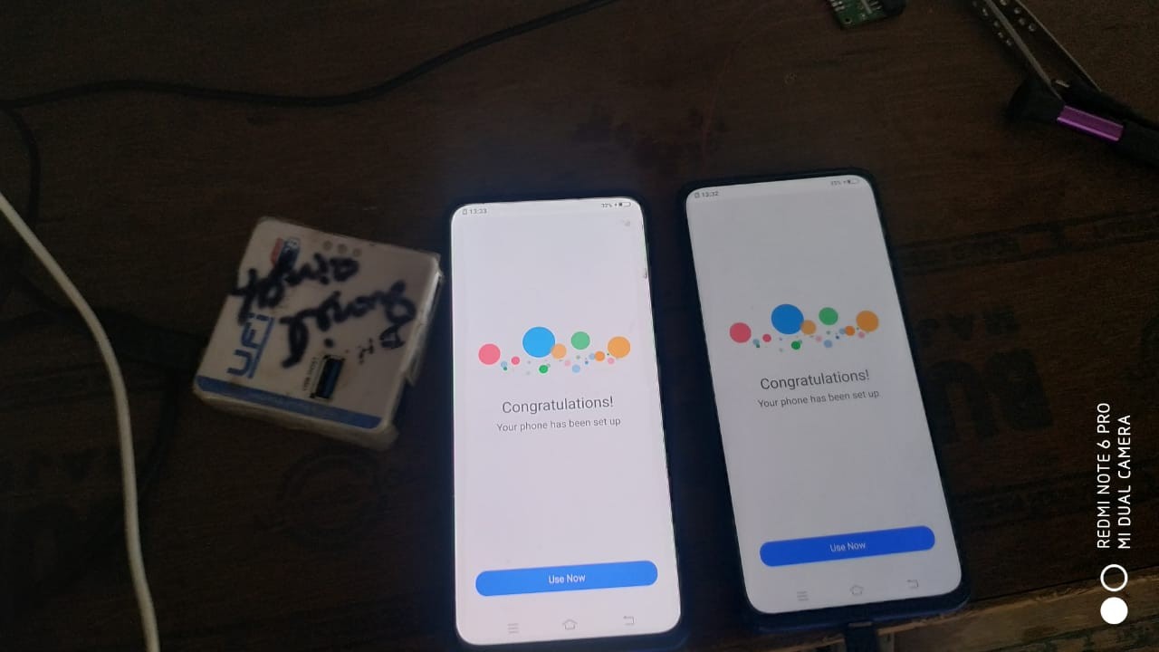

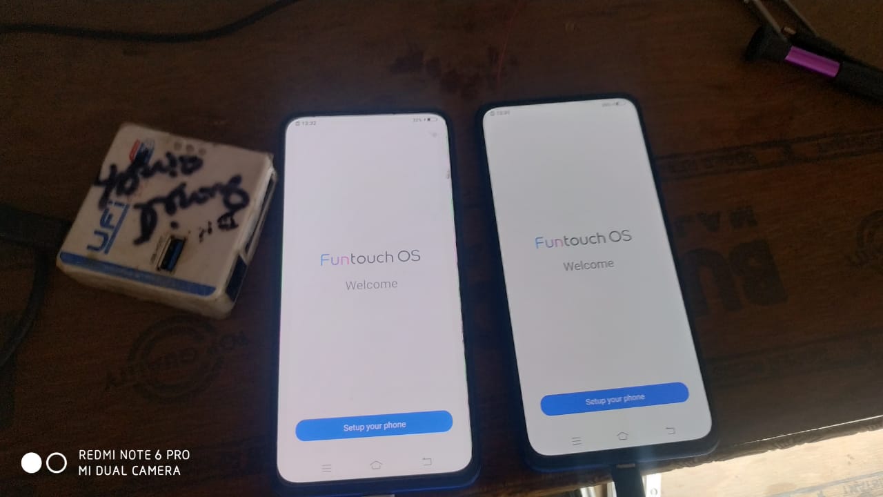

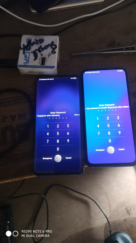

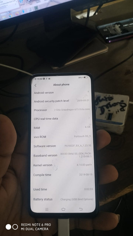

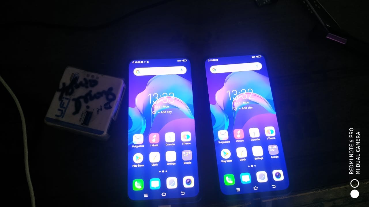

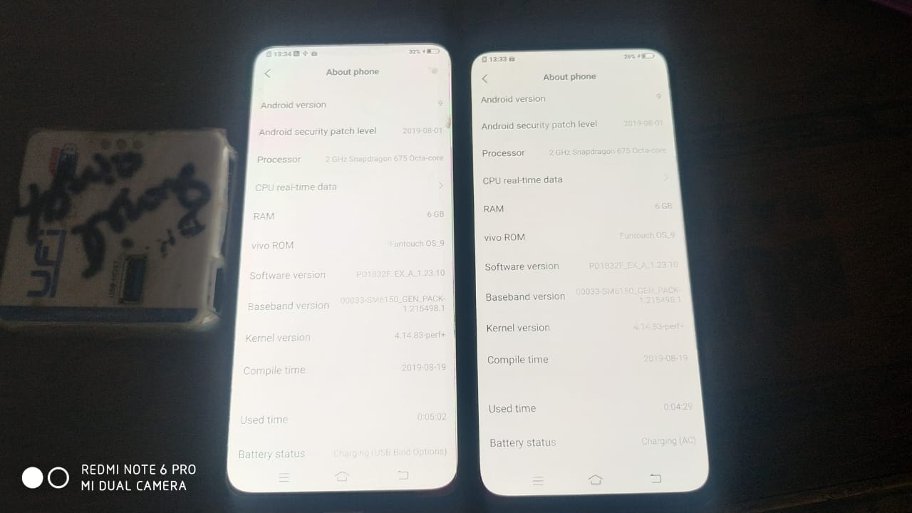

VIVO V15 PRO ( VIVO-1818 ) PD1832F_EX_A_1.23.10___ ANDROID Version : 9 Pie __ RAM - 6GB __Remove Userlocks+Frp
Lock Done Without Any Risk Of Stuck On Logo All Job Successfully Done Ufi-Box Dr.Research-Center-Team
2 piss Userlocks+Frp
1 piss Dead
Userlocks+Frp

ANDROID System Info:
platform: sm6150, cpu abi: arm64-v8a
manufacturer: vivo
board: sm6150, name: sm6150
brand: vivo, model: vivo 1818
build model list: vivo 1818
build id: PKQ1.190302.001, version: 9 Pie (PKQ1.190302.001 release-keys)
build description: sm6150-user 9 PKQ1.190302.001 compiler08192053 release-keys
Internal storage: 108.95 GiB
crypto state: unencrypted
