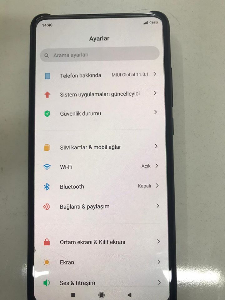

Xiaomi Redmi Note 8 IMEI Repair by Hydra Tool
