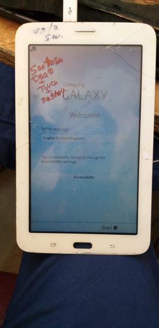

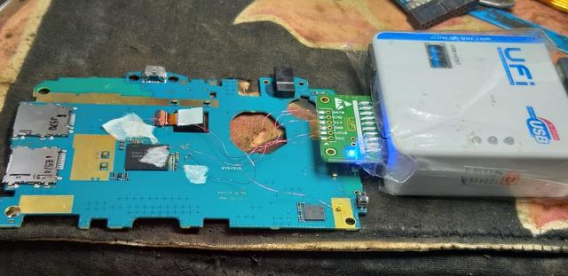

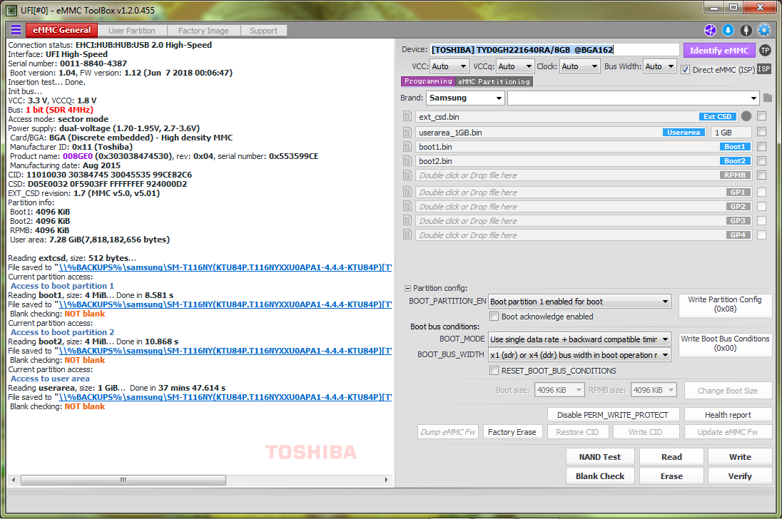

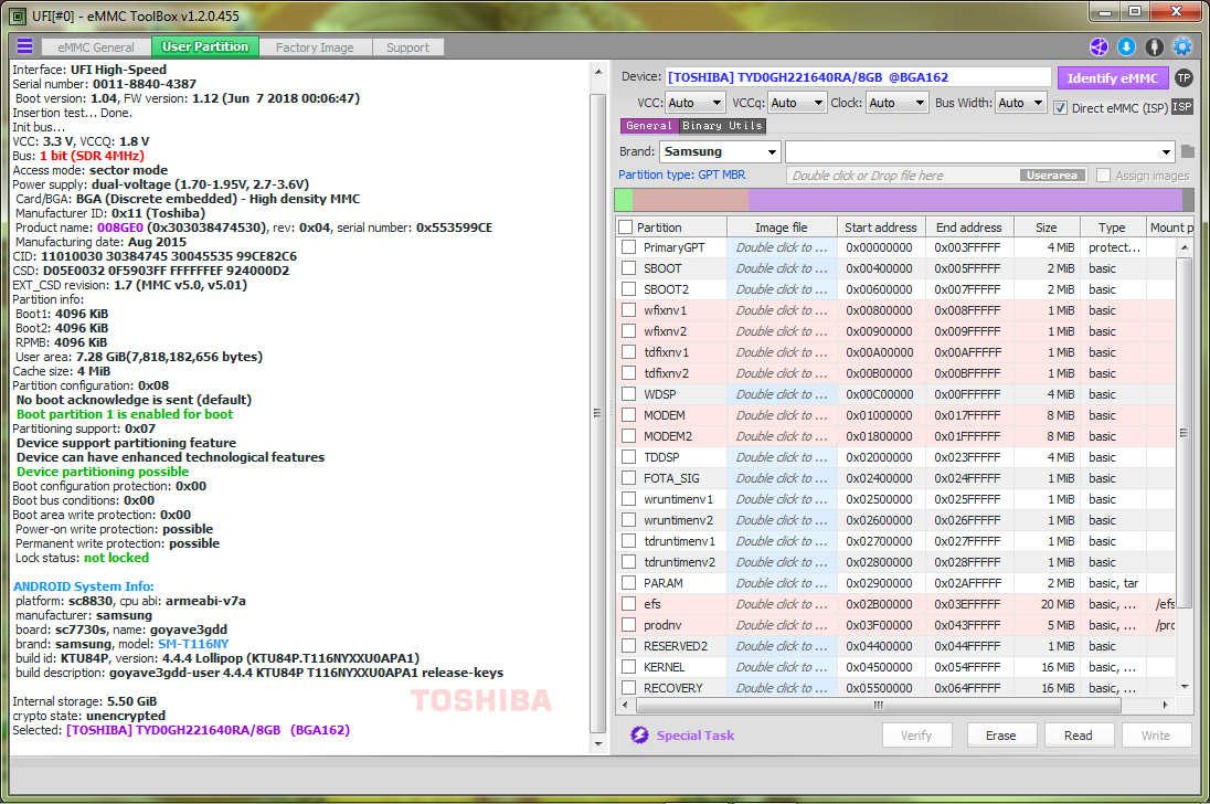

Samsung galaxy Tab-3 Dead Recover Repair Emmc/Read Dump
Samsung Tab-3 T116Ny Dead Recover With Emmc Repair Connect Isp Pinout And Read Dump File For Ufi-Box User
Image-1
Emmc Repair
Sucessfully Alive Handset
Read Dump
samsung t116ny ips pinout not find

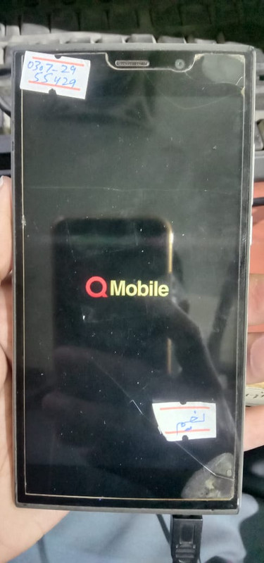

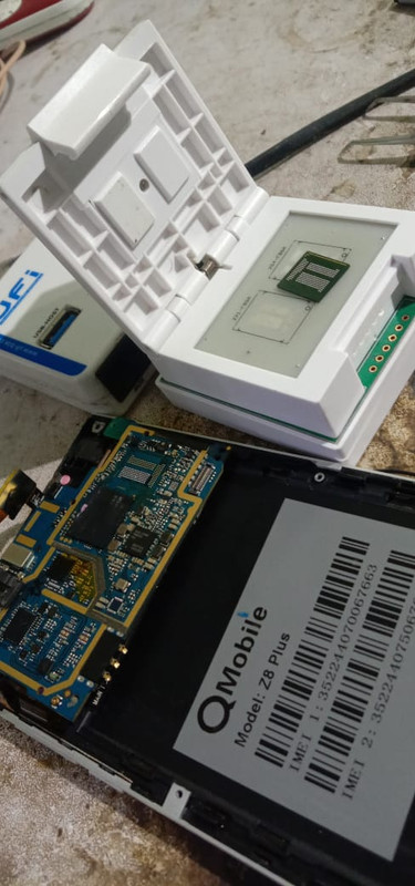

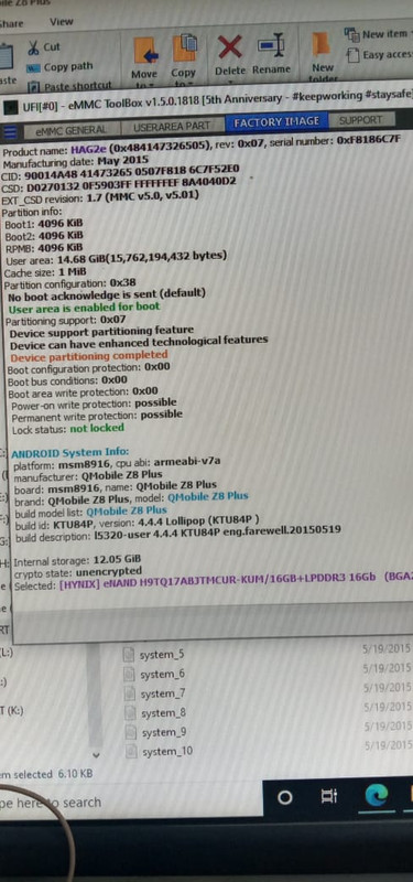

Sucessfully Repaired Phone/Emmc Reprogramming By ufi BOx
QMOBILE Z8 DEAD RECOVER BY UFI DIRECT EMMC​
Qmobile z8 dead boot recover don by ufi direct emmc
and flash direct ufi box with emmc adaptor and read
dump file and uniqe file soo finly qmobile z8 alive
one again dump file shair my all ufi users for free.
