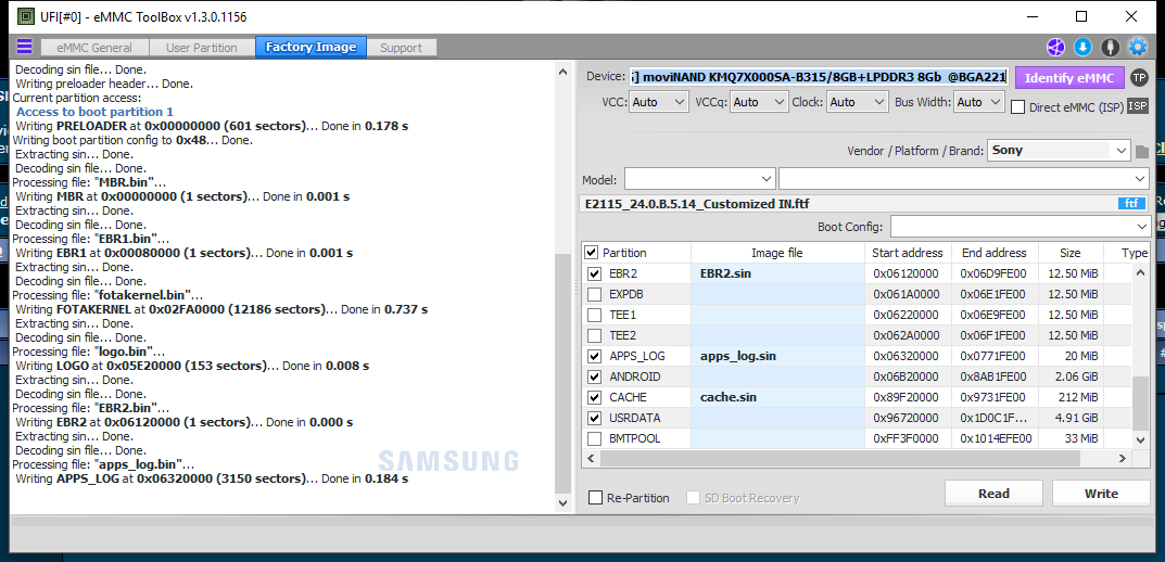

Sony Xperia E4 Daul (E2115) Stuck On Andriod Solved Reprogram Emmc With Ufi Box

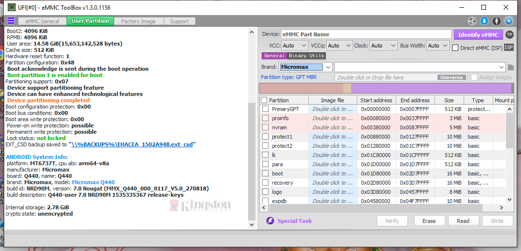

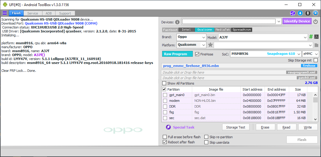

OPPO A37f PINLOCK REMOVED
Connection status: EHCI:HUB:USB 2.0 High-Speed
Interface: UFI High-Speed
Serial number: 0011-8840-7863
 Boot version: 1.04, FW version: 1.10 (Mar 26 2017 14:24:34)
Insertion test... Done.
Init bus...
VCC: 3.3 V, VCCQ: 1.8 V
Bus: 1 bit (SDR 4MHz)
Access mode: sector mode
 Manufacturer ID: 0x13 (Micron)
 Product name: Q2J96R (0x51324a393652), rev: 0x10, serial number: 0x03C78262
 Manufacturing date: Dec 2016
CID: 13014E51 324A3936 521003C7 8262C3D2
CSD: D07F0132 0F5913FF FFFFFFEF 924000A2
EXT_CSD revision: 1.7 (MMC v5.0, v5.01)
Partition info:
 Boot1: 4096 KiB
 Boot2: 4096 KiB
 RPMB: 4096 KiB
 User area: 14.68 GiB(15,758,000,128 bytes)
Cache size: 512 KiB
Hardware reset function: 1
Partition configuration: 0x38
 No boot acknowledge is sent (default)
 User area is enabled for boot
Partitioning support: 0x07
 Device support partitioning feature
 Device can have enhanced technological features
 Device partitioning possible
Boot configuration protection: 0x00
Boot bus conditions: 0x00
Boot area write protection: 0x00
 Power-on write protection: possible
 Permanent write protection: possible
 Lock status: not locked
User area write protection: 0x10
 Password protection features: enabled
 Permanent write protection: not possible
EXT_CSD backup saved to "\\%BACKUPS%\Q2J96R_03C78262.ext_csd"
ANDROID System Info:
 platform: msm8916, cpu abi: arm64-v8a
 manufacturer: OPPO
 board: msm8916, name: A37f
 brand: OPPO, model: A37f()
 build id: LMY47V, version: 5.1.1 Lollipop (A37fEX_11_171209)
 build description: msm8916_64-user 5.1.1 LMY47V eng.root.20171209.165633 release-keys
Internal storage: 11.14 GiB
crypto state: unencrypted
Selected: [Micron] (JY950)MT29TZZZ5D6JKFRL-107/16GB   (BGA221)
VCCQ not properly connected
Init bus...
Partition info:
 Boot1: 4096 KiB
 Boot2: 4096 KiB
 RPMB: 4096 KiB
Scanning "/data" partition... Done.
Clear User Lock... Done.

Oppo A5 pin/password/pin/pattern/frp reset
Via ISP connection ufi emmc tool
