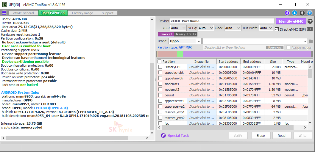

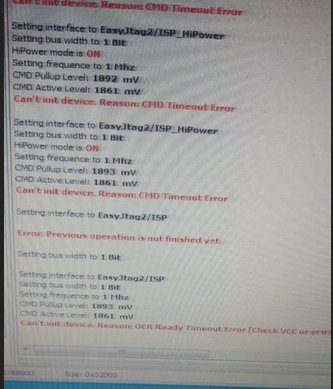

Vivo V11 Pro 6Gb /64Gb After Flash Dead Another Shop return Emmc Black Pasted BGA 254 Easy jtag Plus After Formate Emmc Dead Recovery by Ufi-Box Emmc Update firmware, finally Job Done.
Easy-Jtag Error Image Dead Emmc Show
Ufi-Box Log
Successfully Recovered Handset

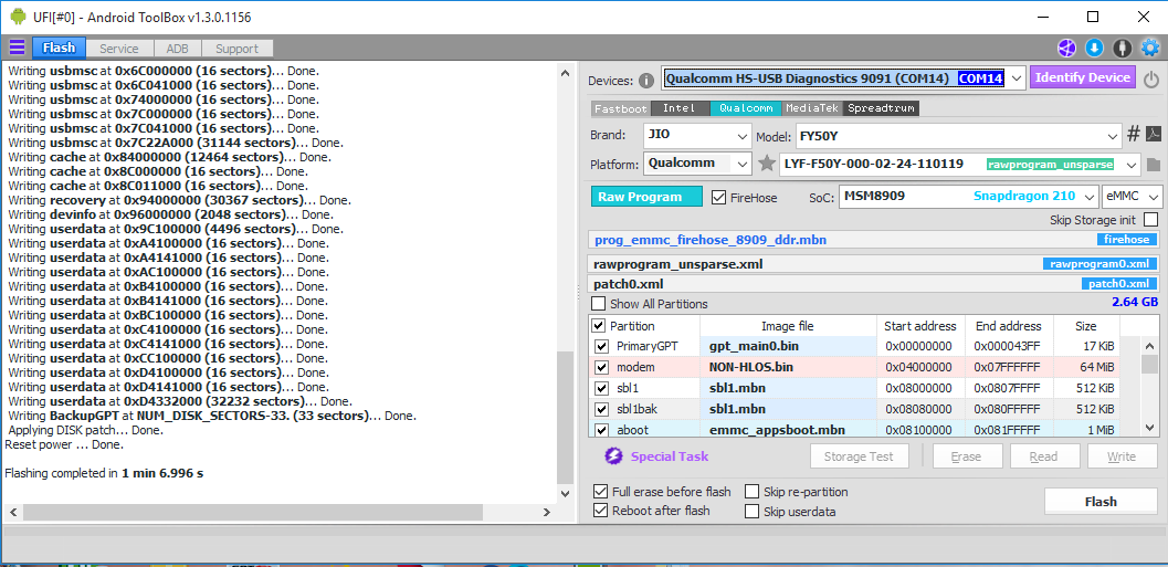

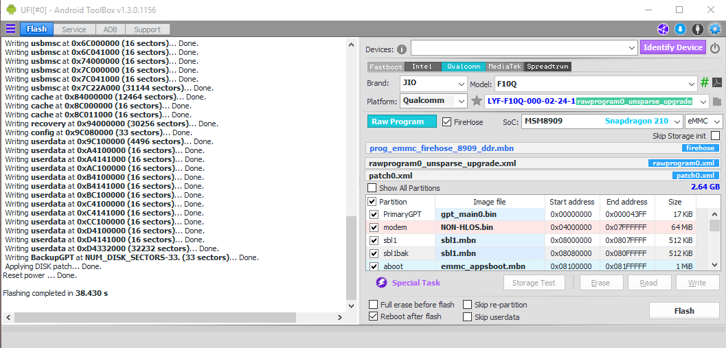

LYF F50Y No network repair done with flash.
Scanning for Qualcomm HS-USB QDLoader 9008 device...
Download Port: Qualcomm HS-USB QDLoader 9008 (COM16)
Connection status: EHCI:HUB:HUB:USB 2.0 High-Speed
USB Driver: [HS Corporation] ghsser, version: 10.2104.1.2, date: 3-17-2014
Initializing...
MSM Serial number: 0x13a48c5f
MSM HW ID: 0x000940e1
OEM Public Key Hash: 0xe59c064e19c13b2cf557da46b1089e93226f67295f8040d456f14edba2bf4784
SBL SW version: 0
Firehose: prog_emmc_firehose_8909_ddr.mbn
sha1: 3e35938446eb14038d72abb218595fe633abeb45, size: 279.73 KiB
QC_IMAGE_VERSION: BOOT.BF.3.1.2.C2.2-00014
IMAGE_VARIANT: DAADANAZA
OEM_IMAGE_VERSION: sw-PC
Sending firehose loader... Done.
Handshaking...
Sending ping... Done.
Sending configurations...
TargetName: 8909
MemoryName: eMMC
Version: 1
Firehose configured.
Storage type: eMMC
Capacity: 3.54 GiB(3,797,942,272 bytes)
Boot1: 2048 KiB
Boot2: 2048 KiB
RPMB: 2048 KiB
User area: 3.53 GiB(3,791,650,816 bytes)
Processing rawprogram_unsparse.xml
Writing PrimaryGPT at 0x00000000 (34 sectors)... Done.
Writing modem at 0x04000000 (102371 sectors)... Done.
Writing sbl1 at 0x08000000 (487 sectors)... Done.
Writing sbl1bak at 0x08080000 (487 sectors)... Done.
Writing aboot at 0x08100000 (1288 sectors)... Done.
Writing abootbak at 0x08200000 (1288 sectors)... Done.
Writing rpm at 0x08300000 (317 sectors)... Done.
Writing rpmbak at 0x08380000 (317 sectors)... Done.
Writing tz at 0x08400000 (1031 sectors)... Done.
Writing tzbak at 0x084C0000 (1031 sectors)... Done.
Writing sec at 0x0C188000 (1 sectors)... Done.
Writing boot at 0x0C18C000 (28775 sectors)... Done.
Writing system at 0x0E18C000 (262160 sectors)... Done.
Writing system at 0x161C5000 (16 sectors)... Done.
Writing system at 0x1638D000 (258056 sectors)... Done.
Writing system at 0x2618C000 (16 sectors)... Done.
Writing system at 0x261C5000 (16 sectors)... Done.
Writing system at 0x2638D000 (184744 sectors)... Done.
Writing system at 0x2E18C000 (16 sectors)... Done.
Writing system at 0x3618C000 (16 sectors)... Done.
Writing system at 0x361C5000 (16 sectors)... Done.
Writing system at 0x3E18C000 (16 sectors)... Done.
Writing system at 0x3E354000 (61792 sectors)... Done.
Writing persist at 0x4018C000 (9416 sectors)... Done.
Writing usbmsc at 0x44000000 (4432 sectors)... Done.
Writing usbmsc at 0x4C000000 (16 sectors)... Done.
Writing usbmsc at 0x4C041000 (16 sectors)... Done.
Writing usbmsc at 0x54000000 (16 sectors)... Done.
Writing usbmsc at 0x5C000000 (16 sectors)... Done.
Writing usbmsc at 0x5C041000 (16 sectors)... Done.
Writing usbmsc at 0x64000000 (16 sectors)... Done.
Writing usbmsc at 0x6C000000 (16 sectors)... Done.
Writing usbmsc at 0x6C041000 (16 sectors)... Done.
Writing usbmsc at 0x74000000 (16 sectors)... Done.
Writing usbmsc at 0x7C000000 (16 sectors)... Done.
Writing usbmsc at 0x7C041000 (16 sectors)... Done.
Writing usbmsc at 0x7C22A000 (31144 sectors)... Done.
Writing cache at 0x84000000 (12464 sectors)... Done.
Writing cache at 0x8C000000 (16 sectors)... Done.
Writing cache at 0x8C011000 (16 sectors)... Done.
Writing recovery at 0x94000000 (30367 sectors)... Done.
Writing devinfo at 0x96000000 (2048 sectors)... Done.
Writing userdata at 0x9C100000 (4496 sectors)... Done.
Writing userdata at 0xA4100000 (16 sectors)... Done.
Writing userdata at 0xA4141000 (16 sectors)... Done.
Writing userdata at 0xAC100000 (16 sectors)... Done.
Writing userdata at 0xB4100000 (16 sectors)... Done.
Writing userdata at 0xB4141000 (16 sectors)... Done.
Writing userdata at 0xBC100000 (16 sectors)... Done.
Writing userdata at 0xC4100000 (16 sectors)... Done.
Writing userdata at 0xC4141000 (16 sectors)... Done.
Writing userdata at 0xCC100000 (16 sectors)... Done.
Writing userdata at 0xD4100000 (16 sectors)... Done.
Writing userdata at 0xD4141000 (16 sectors)... Done.
Writing userdata at 0xD4332000 (32232 sectors)... Done.
Writing BackupGPT at NUM_DISK_SECTORS-33. (33 sectors)... Done.
Applying DISK patch... Done.
Flashing completed in 41.068 s

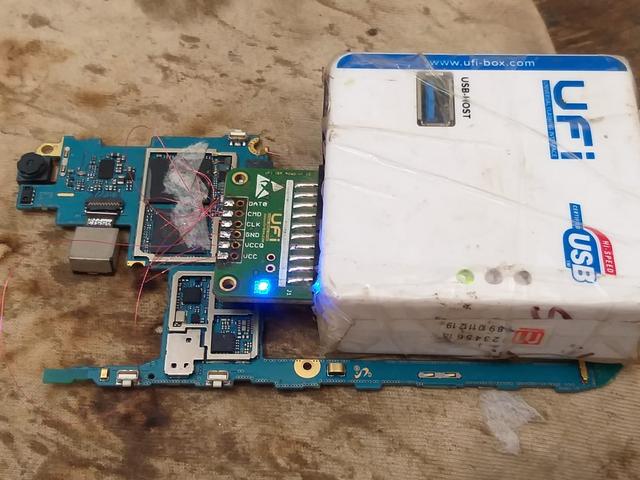

Samsung J7 Next(J701F) Dead Recover With Repair Emmc Job Sucessfully Done Thanks To Ufi-BOx
Got Dead Set Not Connect With Isp Pinout Now JOb Done
Ufi-Log
Set Alive NOW
Ufi-Log
Set Alive NOW

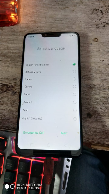

Oppo F9 pro frp reset failed ufi
Sent From SM-A505F Using Martview Forum App
Frp reset failed

Oppo F9 pro Unlock &factory reset done UFI
Sent From SM-A505F Using Martview Forum App[/QUOTE]
Factory reset & unlock password/pin/pattern
Model: Oppo CPH1823_11_A.12_190101_c0c9d675 AUTH info: MTK, version: 1 BROM version[1]: 7.1817.3.0 Loading DA: MTK_AllInOne_DAA[0].bin (790.91 KiB) version: 3.3001.00.00, start addr: 0x40000800 Connecting to BootROM... Power off the phone, disconnect and reconnect the battery(if possible) and connect USB cable... Hold the VOL UP to force MediaTek BootROM. Scanning BootROM or Preloader port(30 s)... Done. Detected MediaTek USB Port_V1632 (COM55) Connection status: EHCI:HUB:USB 1.16 High-Speed USB Driver: [MediaTek Inc.] wdm_usb, version: 3.0.1504.0, date: 1-22-2015 Connecting Bootrom... Done. Sending Download Agent... Done. Platform: MT6771, Hw ver: 0xCA00, Sw ver: 0x0000 Secure ver: 0x00, BL ver: 0x00 Secure config: 0x00 SRAM size: 256 KiB DRAM size: 3 GiB SOC ID: 5c24d1c0dfbb9b33bcb286eaf3ccccc41dc541061094ebabe7df1017968da6f9 ME ID: 4285fbb5c748124ad1141854dc912371 Storage type: eMMC Card/BGA: BGA (Discrete embedded) Manufacturer ID: 0x90 (SK Hynix) Product name: HCG8a4 (0x484347386134), rev: 0xA2, serial number: 0x1C50B801 Manufacturing date: Jul 2018 CID: 90014A48 43473861 34A21C50 B80175E3 Capacity: 58.25 GiB(62,549,655,552 bytes) Boot1: 4096 KiB Boot2: 4096 KiB RPMB: 4096 KiB User area: 58.24 GiB(62,537,072,640 bytes) USB speed: High-Speed Clear FRP Lock... +DlgError: Failed to write at 0x00000000, error 0xC002000C (STATUS_SEC_WRITE_DATA_NOT_ALLOWED) failed AUTH info: MTK, version: 1 BROM version[1]: 7.1817.3.0 Loading DA: MTK_AllInOne_DAA[0].bin (790.91 KiB) version: 3.3001.00.00, start addr: 0x40000800 Connecting to BootROM... Power off the phone, disconnect and reconnect the battery(if possible) and connect USB cable... Hold the VOL UP to force MediaTek BootROM. Scanning BootROM or Preloader port(30 s)... Done. Detected MediaTek USB Port_V1632 (COM55) Connection status: EHCI:HUB:USB 1.16 High-Speed USB Driver: [MediaTek Inc.] wdm_usb, version: 3.0.1504.0, date: 1-22-2015 Connecting Bootrom... Done. Sending Download Agent... Done. Platform: MT6771, Hw ver: 0xCA00, Sw ver: 0x0000 Secure ver: 0x00, BL ver: 0x00 Secure config: 0x00 SRAM size: 256 KiB DRAM size: 3 GiB SOC ID: 5c24d1c0dfbb9b33bcb286eaf3ccccc41dc541061094ebabe7df1017968da6f9 ME ID: 4285fbb5c748124ad1141854dc912371 Storage type: eMMC Card/BGA: BGA (Discrete embedded) Manufacturer ID: 0x90 (SK Hynix) Product name: HCG8a4 (0x484347386134), rev: 0xA2, serial number: 0x1C50B801 Manufacturing date: Jul 2018 CID: 90014A48 43473861 34A21C50 B80175E3 Capacity: 58.25 GiB(62,549,655,552 bytes) Boot1: 4096 KiB Boot2: 4096 KiB RPMB: 4096 KiB User area: 58.24 GiB(62,537,072,640 bytes) USB speed: High-Speed Factory reset... Creating filesystem... Done. Writing cache... Done. Creating filesystem... Done. Writing userdata... Done.

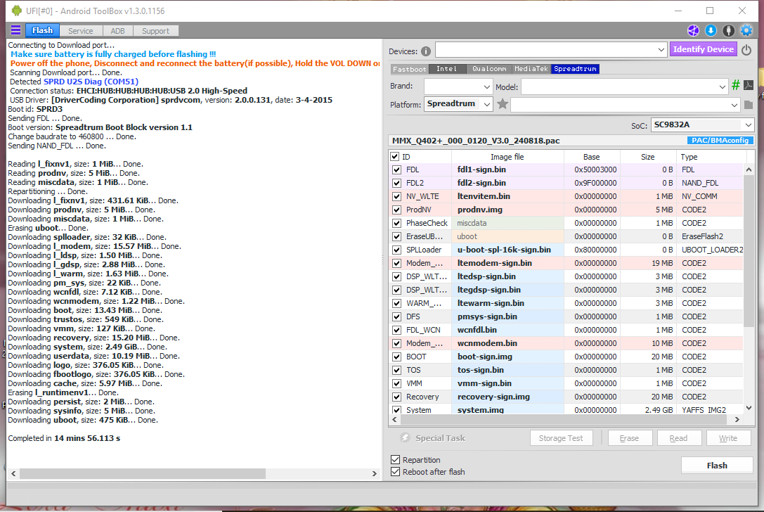

Jio f61f Hang on logo.
Spreadtrum CPU.. pac file
Successfully flashed in UFI ANDROID TOOL

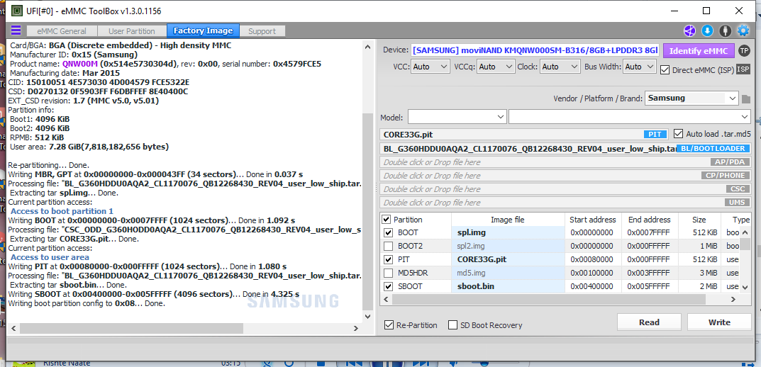

100.1675677
J200h dead boot repaired Boot version: 1.04, FW version: 1.12 (Jun 7 2018 00:06:47)
Insertion test... Done.
Init bus...
VCC: 3.3 V, VCCQ: 1.8 V
Bus: 1 bit (SDR 4MHz)
Access mode: sector mode
Product name: H8G4t (0x483847347421), rev: 0x01, serial number: 0x0486A8EF
Manufacturing date: Jul 2016
CID: 90014A48 38473474 21010486 A8EF7384
CSD: D07F0132 0F5903FF FFFFFFEF 8A400012
EXT_CSD revision: 1.7 (MMC v5.0, v5.01)
Partition info:
Boot1: 4096 KiB
Boot2: 4096 KiB
RPMB: 4096 KiB
User area: 7.28 GiB(7,818,182,656 bytes)
Re-partitioning... Done.
Writing MBR, GPT at 0x00000000-0x000043FF (34 sectors)... Done in 0.040 s
Processing file: "BL_J200HXXS0ARI1_CL1247614_QB19655155_REV00_user_low_ship.tar.md5\spl.img", size: 32 KiB...
Extracting tar spl.img... Done.
Current partition access:
Access to boot partition 1
Writing BOOT at 0x00000000-0x0007FFFF (1024 sectors)... Done in 1.121 s
Processing file: "J23G_EUR_OPEN.pit\J23G.pit", size: 5.02 KiB...
Access to user area
Writing PIT at 0x00080000-0x000FFFFF (11 sectors)... Done in 0.014 s
Processing file: "BL_J200HXXS0ARI1_CL1247614_QB19655155_REV00_user_low_ship.tar.md5\sboot.bin", size: 1.50 MiB...
Extracting tar sboot.bin... Done.
Writing SBOOT at 0x00400000-0x005FFFFF (4096 sectors)... Done in 4.339 s
Processing file: "BL_J200HXXS0ARI1_CL1247614_QB19655155_REV00_user_low_ship.tar.md5\sboot2.bin", size: 1.50 MiB...
Extracting tar sboot2.bin... Done.
Writing SBOOT2 at 0x00600000-0x007FFFFF (4096 sectors)... Done in 4.341 s
Processing file: "BL_J200HXXS0ARI1_CL1247614_QB19655155_REV00_user_low_ship.tar.md5\param.lfs", size: 560 KiB...
Extracting tar param.lfs... Done.
Writing PARAM at 0x02900000-0x02AFFFFF (4096 sectors)... Done in 4.338 s
Writing boot partition config to 0x08... Done.
