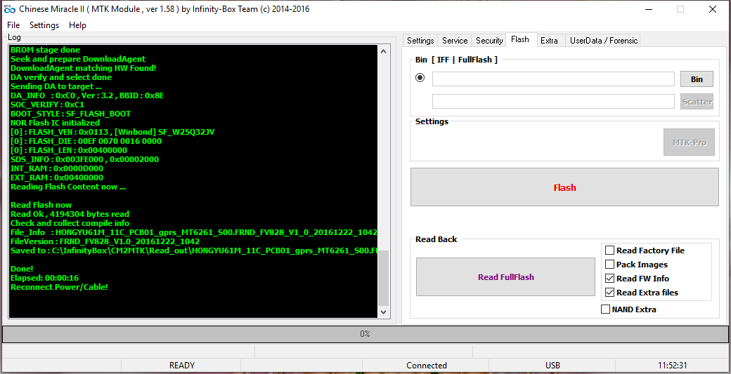

Samsung GT-E1200y Dead Recovery done
Card found: S/N : CDAA878B , v0137
Chinese Miracle II [SPD module] v 1.27
Set mode to : SPD6530_SAMSUNG
Operation : Read FullFlash [ v1.27 ]
  1. Remove battery. Insert USB cable
  2. Press and hold BootKey ( Skip, if use BootCable )
  3. Insert battery
==== Wait for phone...
Phone found! [ 7 ]
Port Opened
Sync...
Sync...
Sending boot ...
Boot Sent , starting...
Boot Ver : Spreadtrum Boot Block version 1.2
Boot Ok
CPU ID : 6530 , FDLStat : 00C0
[0] Flash DIE : 00C8 0060 0017 0000
[0] Flash VEN : GigaDevice , GD25LQ64
[0] Flash CAP : 00800000
Read Flash Content
Read Ok , collect info
Platform : MOCOR_W13.09_FP_R5.0.2_Debug
sc6500_samsung_EiderVESS_E1200Y_SWA
ExtInfo : LevelofLock 00000000 00000000
Project : SC6500_SAMSUNG
HWInfo : SC6500_EiderVESS
Compile : 06-01-2018 11:18:18
Saved to : C:\InfinityBox\CM2SPD\Read_out\SPD6530_SAMSUNG_00800000_MOCOR_W13.09_FP_R5.0.2_Debug_sc6500_samsung_EiderVESS_E1200Y_SWA_06012018111818.bin
Done!
Elapsed: 00:00:50
Reconnect Power/Cable!
FastCheck : SPD65xx
Load file...
Load Ok
Operation : Flash [ v1.27 ]
======= Flash
Files set for flashing :
[ MCU ] : SPD6530_SAMSUNG_00800000_MOCOR_W13.09_FP_R5.0.2_Debug_sc6500_samsung_EiderVESS_E1200Y_SWA_06012018111818.bin
  3. Insert battery
Phone found! [ 7 ]
Port Opened
Sync...
Sync...
Sending boot ...
Boot Ok
======= Flashing MCU
Mapping file ...
Mapping done
Processing file : SPD6530_SAMSUNG_00800000_MOCOR_W13.09_FP_R5.0.2_Debug_sc6500_samsung_EiderVESS_E1200Y_SWA_06012018111818.bin
Init ok, send data
Flashing Done!
Info : In some cases after flash required make "Format Fs / Reset Phone"
Done!
Elapsed: 00:01:43

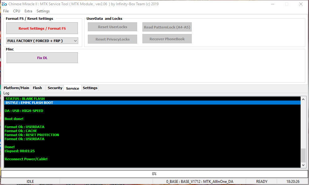

Qmobile i6i Format Done
Operation : Reset Settings/Format FS [ v2.06 ]
  1. Make sure device is powered off. Power off, if need. Wait 20 seconds after
  2. Insert USB cable in phone
Waiting for device connection ...
PTFN : MediaTek PreLoader USB VCOM (Android) (COM264)
MODE : PRELOADER PORT
PORT : 264
Waiting BOOT ack ...
PRELOADER : ACK confirmed!
BROM : Init BROM
BROM init passed!
CHIP : MT6580 , SBID : 0x8A00 , HWVR : 0xCA00 , SWVR : 0x0000
TYPE : LEGACY MTK
BROM : SecLevel : 0x00000000
BROM : SecMode : PLAIN [+PRL]
BROM : PRELOADER PORT
MODE : 0_base : BASE_v1712 | Manual : Disabled
AGENT : Look for suitable BootChain in DA ...
AGENT : MTK_AllInOne_DA.bin
AGENT : Found MT6580
AGENT : MTK_DOWNLOAD_AGENT
BROM : Sending 1st DA ...
BROM : DA sent
BROM :Transfer control to DA ...
DA : AGENT started!
NAND : DEVICE NOT FOUND
NAND : 000000000000000000000000
eMMC : OK
eMMC : 460001154D37324A6DE00242A933B3C2
DAInf: 4 : 2 : 156
DA : DRAM ready!
DA : BOOT to 2nd DA ...
DA : Receiving HW info
EMMC: 150100464A32374D4202E06DC2B333A9
EMMC: VEN : SAMSUNG | OEM : 01 | DEV : FJ27MB
EMMC:
BOOT1 : 0x00400000 [ 4.00 MB ]
BOOT2 : 0x00400000 [ 4.00 MB ]
RPMB : 0x00080000 [ 512.00 KB ]
USER : 0xE9000000 [ 3.64 GB ]
SRAM: 0x00020000 [ 128.00 KB ]
DRAM: 0x30000000 [ 768.00 MB ]
CHIP : MT6580 , SBID : 0x8A00 , HWVR : 0xCA00 , SWVR : 0x0000 , EVOL : 0x0000
RNID : 4CEB5FEC14458801E2B1DA5A2B93706F
STATUS : BLANK FLASH
BSTYLE : EMMC FLASH BOOT
DA : USB : HIGH-SPEED
Boot done!
Format Ok : USERDATA
Format Ok : CACHE
Format Ok : RESET PROTECTION
Done!
Elapsed: 00:00:22

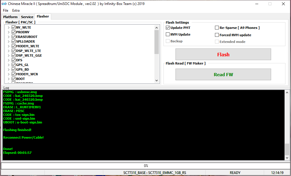

  1. Power off device, wait 10-15 seconds
  2. Press and hold BooKey ( 1 : BOTH VOL , 2 : VOL+ , 3 : VOL- )
  3. Insert cable in device!
Wait for device ...
Device Connected!
BootVersion : SPRD3
Boot : PAC : I6_METAL_ONE_i6_Metal_ONE_new_6.0_MRA58K_release-keys_QMobile_i6_Metal_ONE V4.0_14_12.pac
Sending Init Boot ...
Boot sent!
Kick FDL ...
BootVersion : Spreadtrum Boot Block version 1.1
Protocol setup ...
Port speed : 921600
Sending Flash Boot ...
Boot sent!
Kick FLASH FDL ...
ProtoEx : : TRCC not supported!
FDL : Control transfered!
Boot Done!
CODE : prodnv.img
ERASE : UBOOT
ERASE : WRUNTIMENV1
ERASE : WCNRUNTIMENV1
ERASE : MISC
UBOOT : u-boot-spl-16k.bin
CODE : sc7731C_CP0_modem.bin
CODE : DSP_DM_Gx.bin
CODE : sc8830g_modem_CP2_WCN_Trunk_W16.28.5_Release.bin
CODE : logo_480x854.bin
CODE : fblogo_480x854.bin
CODE : boot.img
FSIMG : system.img
CODE : sysinfo.img
FSIMG : cache.img
CODE : recovery.img
FSIMG : userdata.img
UBOOT : u-boot.bin
Flashing finished!
Done!
Elapsed: 00:09:31

VgoTel i12 Read User Code Done
Operation : Read UserCode [ v1.58 ]
Wait for phone...
Phone found! [ 10 ]
Sync...
Sync Ok, read regs...
Inital regs read done
Boot Info :
BB_CPU_ID : 6261
BB_CPU_HW : CB01
BB_CPU_SW : 0001
BB_CPU_SB : 8000
BB_CPU_SN : 01A98288F60A70DF2E0BBA262C1B59F1
BROM Protocol Version : 05
Setting...
BROM stage done
DA verify and select done
Sending DA to target ...
DA_INFO : 0xC0 , Ver : 3.2 , BBID : 0x8E
SOC_VERIFY : 0xC1
BOOT_STYLE : SF_FLASH_BOOT
NOR Flash IC initialized
[0] : FLASH_VEN : 0x0112 , [MXIC] MX25L3291FWJI_09
[0] : FLASH_DIE : 00C2 0020 0016 0000
[0] : FLASH_LEN : 0x00400000
SDS_INFO : 0x003FE000 , 0x00002000
INT_RAM : 0x0000D000
EXT_RAM : 0x00400000
Read ExtData
Sorting ExtData
Reading UserCode
Active : Yes , Code : 1199
PLock|MobTrack : Not active
Done!
Elapsed: 00:00:34

Qmobile Dual One Format Done
PORT : 264
BROM : Init BROM
BROM init passed!
TYPE : LEGACY MTK
BROM : DA sent
DA : AGENT started!
eMMC : OK
eMMC : 460001154D32584E34110142253445FC
DAInf: 4 : 2 : 156
DA : DRAM ready!
EMMC: 150100464E58324D42011134FC453425
EMMC: VEN : SAMSUNG | OEM : 01 | DEV : FNX2MB
EMMC:
USER : 0x1D2000000 [ 7.28 GB ]
DRAM: 0x40000000 [ 1.00 GB ]
RNID : C908240A8D4ECEC04480B698B83809DB
Boot done!
Format Ok : CACHE
Done!
Elapsed: 00:02:10
