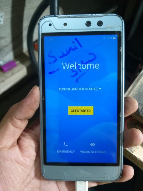

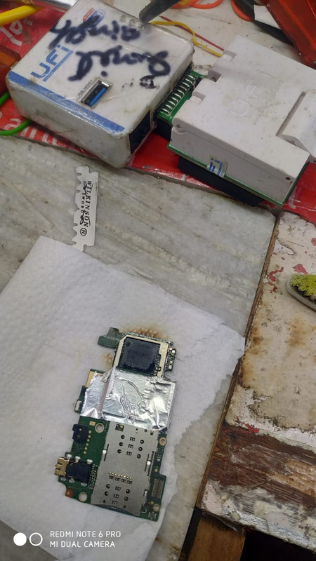

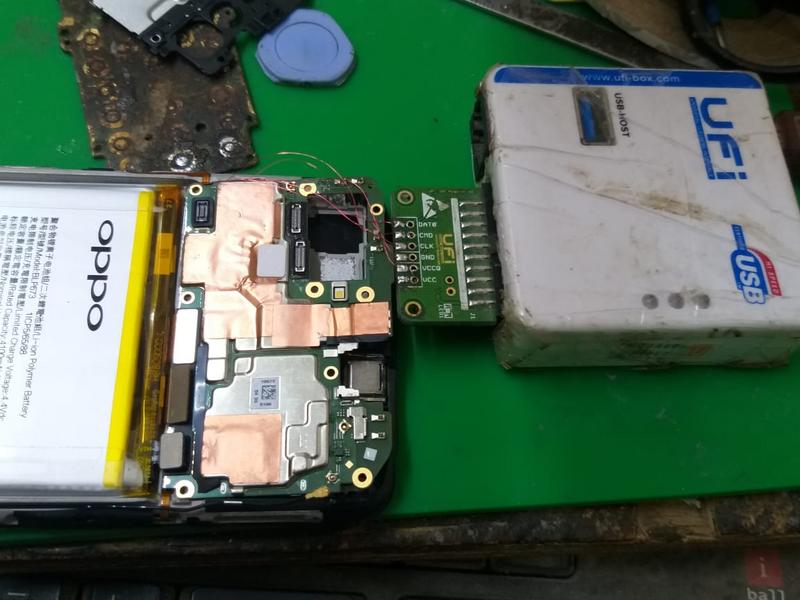

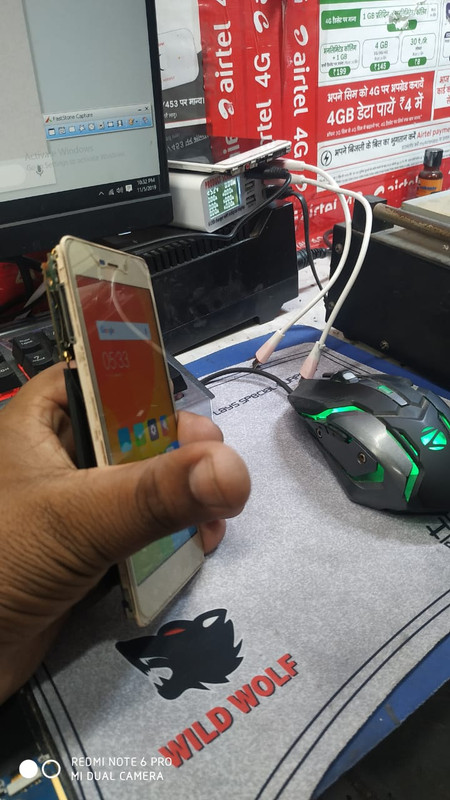

today iam solve oppo a7 other shop keeper remove patterlock via isp method he make jumper phone dead customer not wait and he take phone and come my shop.i check.clk diode short i remove and make master clear in ufi box and remove all.jumper and clk short phone perfect on

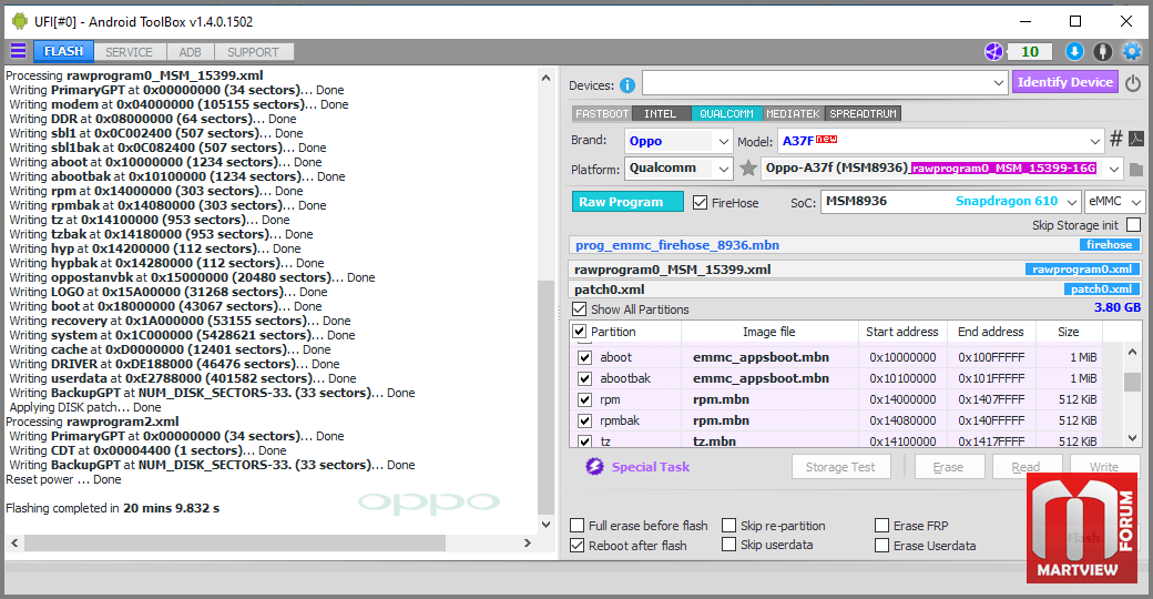

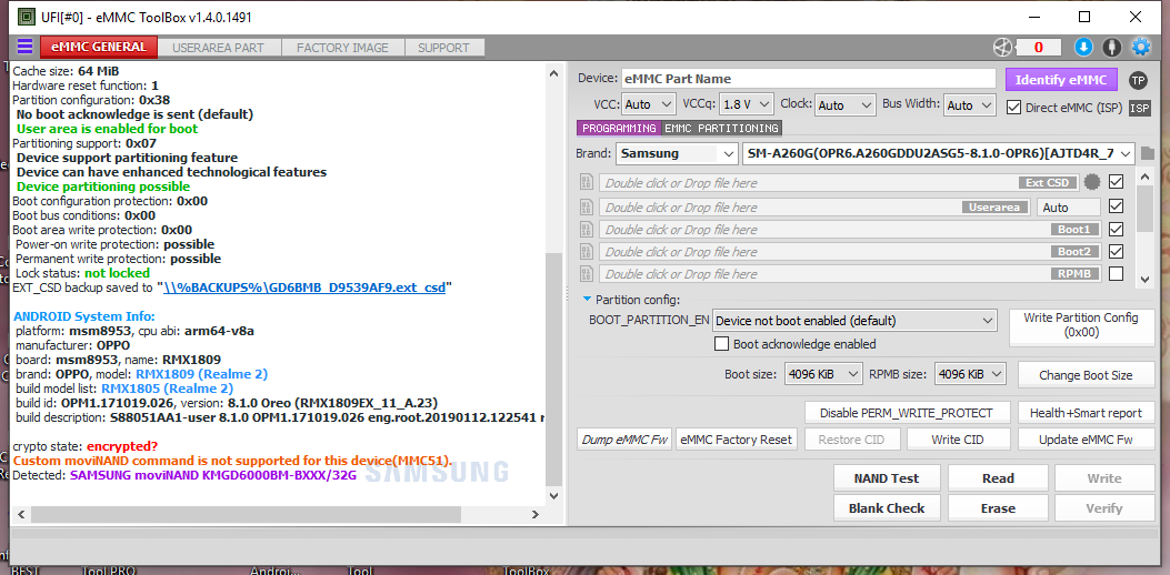

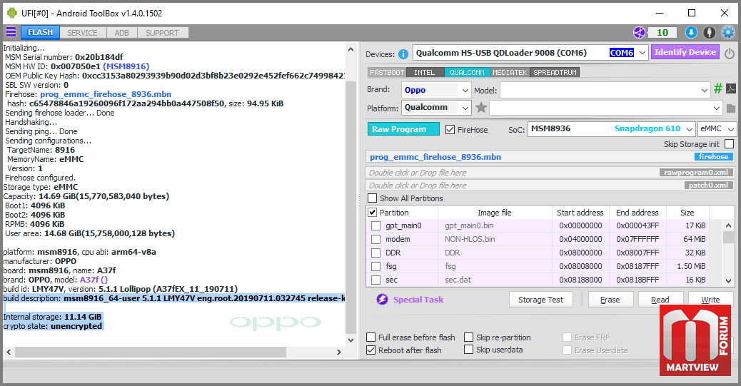

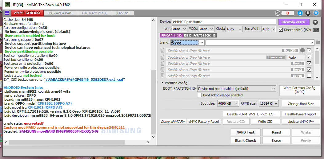

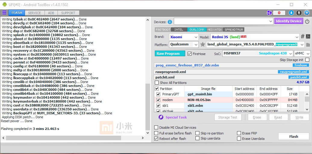

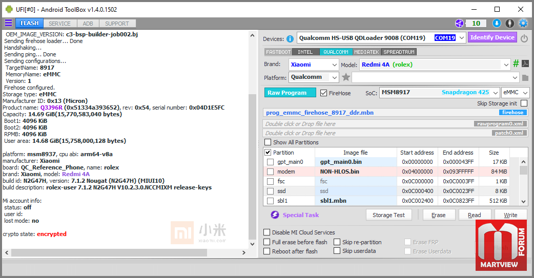

Realme 2 Rmx 1809 Remove User Locks Without Lost Of Any Media Files With Ufi-Box
Remove User Lock
Full Info.
After Remove User Lock All Media Safe Customer So Happy
Specially Thank Ufi-Box

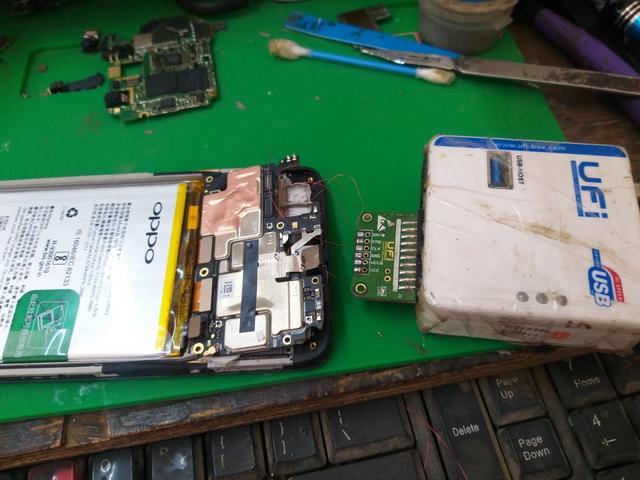

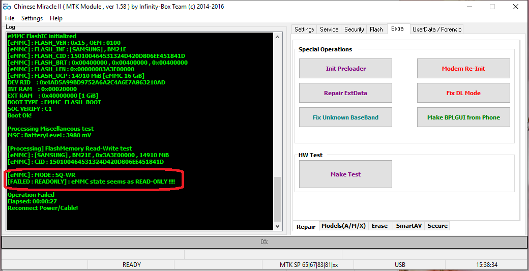

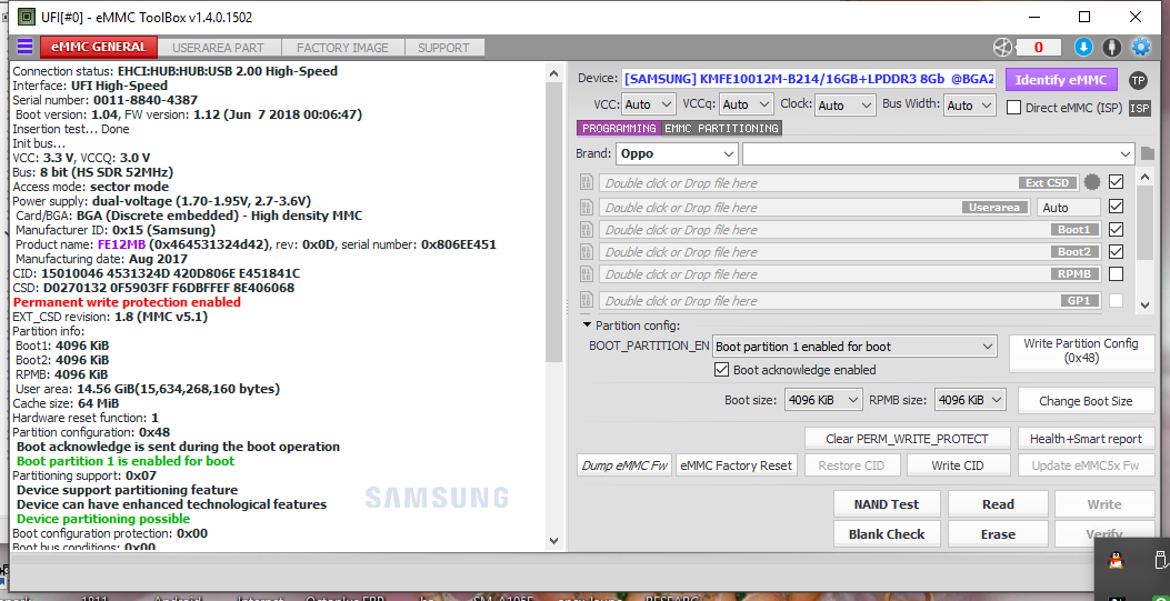

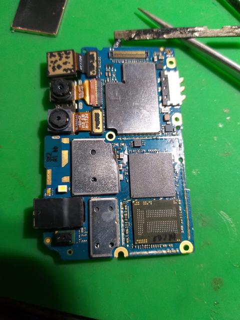

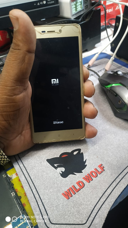

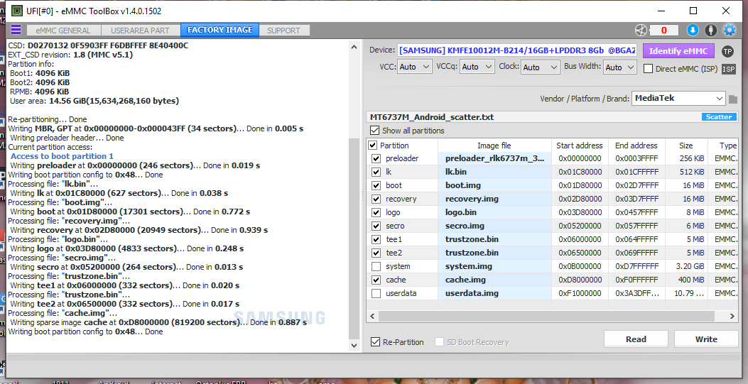

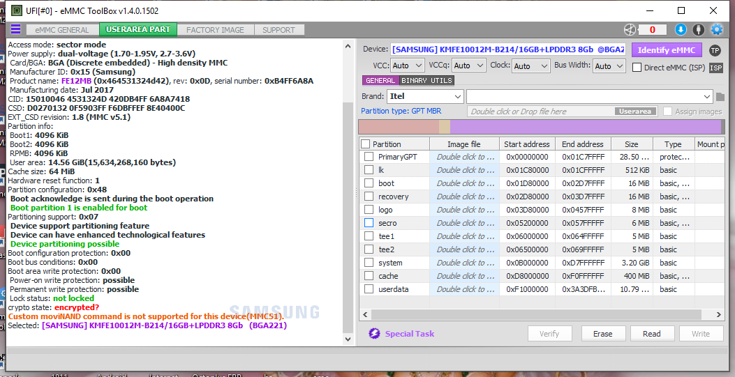

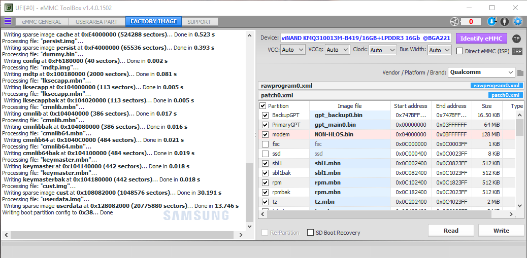

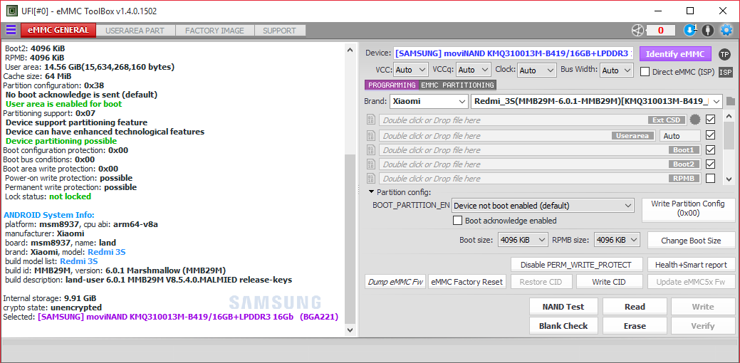

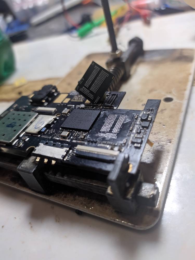

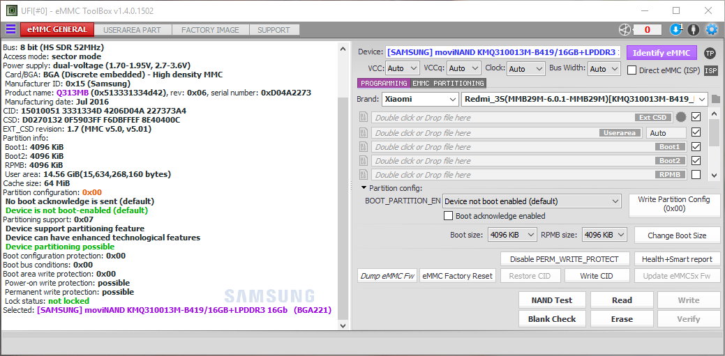

Itel S21 Stuck On Logo Problem Emmc Permanent Write Protection Enable
Handset Successfully
Recover With Replace Emmc Samsung To Samsung +
Emmc Reprogram All Job Successfully Done With
Ufi-Box
Cm2 Report Emmc Read Only(Perfect Report BEfore remove Emmc)
PErmanent Write Protection Enable
Reprograme+Write File
Partition-Info.
Successfully Alive Handset

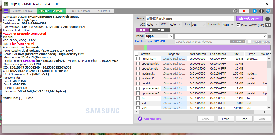

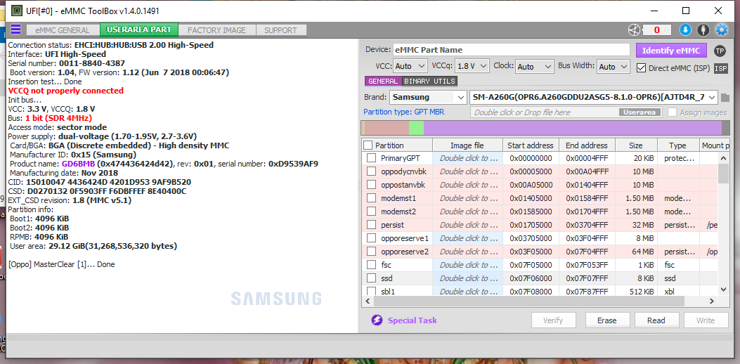

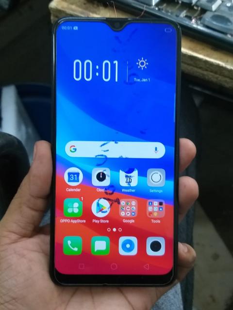

oppo f11 password remove doine
Connection status: EHCI:HUB:HUB:USB 2.00 High-Speed
Interface: UFI High-Speed
Serial number: 0011-8840-4224
Boot version: 1.04, FW version: 1.13 (Aug 19 2019 23:46:09)
Insertion test... Done
VCCQ not properly connected
Init bus...
VCC: 3.3 V, VCCQ: 1.8 V
Bus: 1 bit (SDR 4MHz)
Access mode: sector mode
Manufacturer ID: 0x90 (SK Hynix)
Product name: hC8aP (0x68433861503e), rev: 0x03, serial number: 0xCB34C5FD
Manufacturing date: Nov 2018
CID: 90014A68 43386150 3E03CB34 C5FDB5B2
CSD: D0270032 8F5903FF FFFFFFEF 8E400042
EXT_CSD revision: 1.8 (MMC v5.1)
Partition info:
Boot1: 4096 KiB
Boot2: 4096 KiB
RPMB: 16384 KiB
User area: 58.24 GiB(62,537,072,640 bytes)
Cache size: 2 MiB
Hardware reset function: 1
Partition configuration: 0x48
Boot acknowledge is sent during the boot operation
Boot partition 1 is enabled for boot
Partitioning support: 0x07
Device support partitioning feature
Device can have enhanced technological features
Device partitioning possible
Boot configuration protection: 0x00
Boot bus conditions: 0x02
Bus width: x8 (sdr/ddr), boot mode: sdr(default), reset bus width to x1 sdr(default)
Boot area write protection: 0x00
Power-on write protection: possible
Permanent write protection: possible
Lock status: not locked
EXT_CSD backup saved to "\\%BACKUPS%\hC8aP_CB34C5FD.ext_csd"
ANDROID System Info:
platform: MT6771, cpu abi: arm64-v8a
manufacturer: OPPO
board: oppo6771_18531, name: CPH1969
brand: OPPO, model: CPH1969 (OPPO F11 Pro)
build model list: CPH1985 (OPPO R15), CPH1987 (OPPO F11 Pro), CPH1969 (OPPO F11 Pro)
build id: PPR1.180610.011, version: 9 Pie (CPH1969EX_11_A.37)
build description: full_oppo6771_18531-user 9 PPR1.180610.011 eng.root.20190924.215717 release-keys
crypto state: encrypted?
Init bus...
Partition info:
Boot1: 4096 KiB
Boot2: 4096 KiB
RPMB: 16384 KiB
[Oppo] MasterClear [2]... Done
