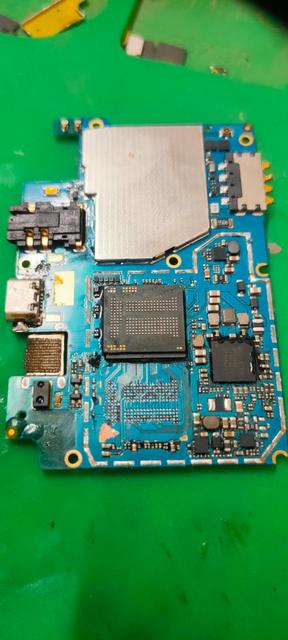

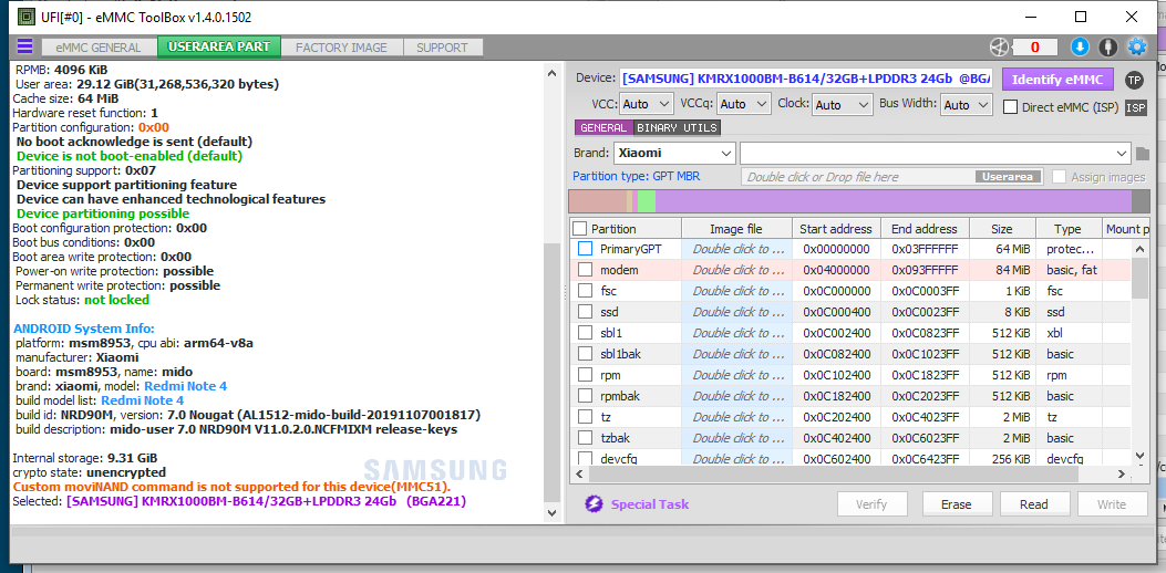

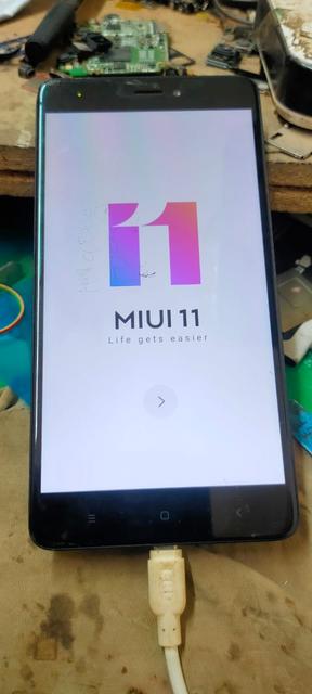

Redmi Note 4 Mido Service Center Return Unable To Repair Handset
Successfully Recovered
Replace
PM Reboll PMI & Cpu And Emmc Successfully Reprogrammed By Ufi-Box
Emmc Reprogram
Successfully Recover Handset
