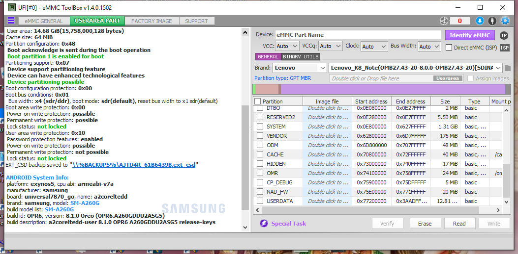

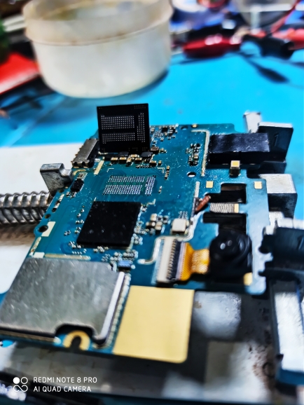

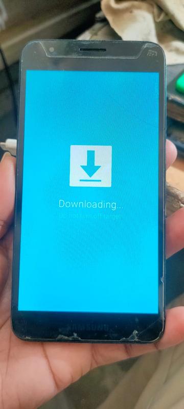

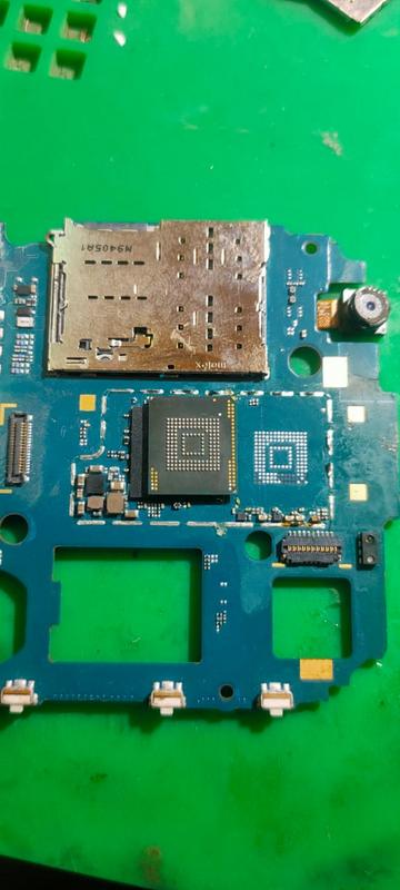

Sm G532f Dead boot Repair Done By #UFI_Box Modify Pin-out socket and High speed

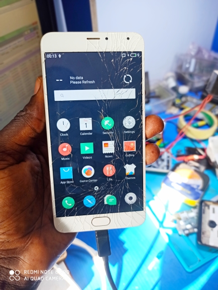

Meizu M1 metal userlock reset done
Software engineer tied up DA bring it to my table

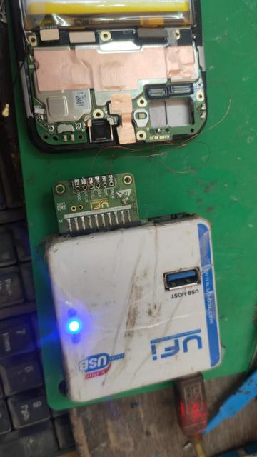

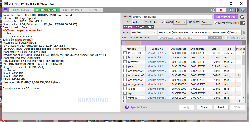

OPPPO F11 PRO PASSWORD REMOVE DONE
Connection status: EHCI:HUB:HUB:USB 2.00 High-Speed
Interface: UFI High-Speed
Serial number: 0011-8840-4224
Boot version: 1.04, FW version: 1.13 (Aug 19 2019 23:46:09)
Insertion test... Done
VCCQ not properly connected
Init bus...
VCC: 3.3 V, VCCQ: 3.0 V
Bus: 1 bit (SDR 48MHz)
Access mode: sector mode
Manufacturer ID: 0x90 (SK Hynix)
Product name: hDEaP3 (0x684445615033), rev: 0x03, serial number: 0x3B67B581
Manufacturing date: Mar 2019
CID: 90014A68 44456150 33033B67 B5813618
CSD: D0270032 8F5903FF FFFFFFEF 8E400042
EXT_CSD revision: 1.8 (MMC v5.1)
Partition info:
Boot1: 4096 KiB
Boot2: 4096 KiB
RPMB: 16384 KiB
User area: 116.48 GiB(125,074,145,280 bytes)
Cache size: 2 MiB
Hardware reset function: 1
Partition configuration: 0x48
Boot acknowledge is sent during the boot operation
Boot partition 1 is enabled for boot
Partitioning support: 0x07
Device support partitioning feature
Device can have enhanced technological features
Device partitioning possible
Boot configuration protection: 0x00
Boot bus conditions: 0x02
Bus width: x8 (sdr/ddr), boot mode: sdr(default), reset bus width to x1 sdr(default)
Boot area write protection: 0x00
Power-on write protection: possible
Permanent write protection: possible
Lock status: not locked
EXT_CSD backup saved to "\\%BACKUPS%\hDEaP3_3B67B581.ext_csd"
ANDROID System Info:
platform: MT6771, cpu abi: arm64-v8a
manufacturer: OPPO
board: oppo6771_18531, name: CPH1969
brand: OPPO, model: CPH1969 (OPPO F11 Pro)
build model list: CPH1985 (OPPO R15), CPH1987 (OPPO F11 Pro), CPH1969 (OPPO F11 Pro)
build id: PPR1.180610.011, version: 9 Pie (CPH1969EX_11_A.38)
build description: full_oppo6771_18531-user 9 PPR1.180610.011 eng.root.20191024.232120 release-keys
crypto state: encrypted?
Init bus...
Partition info:
Boot1: 4096 KiB
Boot2: 4096 KiB
RPMB: 16384 KiB
[Oppo] MasterClear [2]... Done

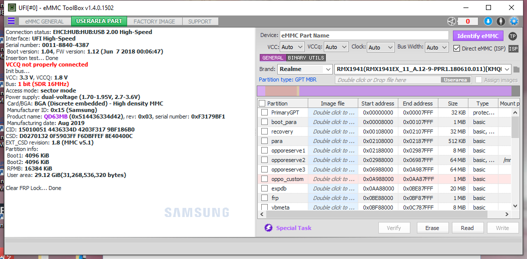

oppo r15 chinese model password remove done(ufi emmc) with no risk
Connection status: EHCI:HUB:HUB:USB 2.0 High-Speed
Boot version: 1.04, FW version: 1.12 (Jun 7 2018 00:06:47)
Insertion test... CLK not properly connected
Init bus...
VCC: 3.3 V, VCCQ: 1.8 V
Bus: 1 bit (SDR 4MHz)
Product name: 3V6CMB (0x335636434d42), rev: 0x02, serial number: 0xD31CC817
Manufacturing date: Mar 2018
CID: 15010033 5636434D 4202D31C C81735B8
CSD: D0270132 0F5903FF F6DBFFEF 8E40400C
Partition info:
Boot1: 4096 KiB
Boot2: 4096 KiB
RPMB: 16384 KiB
User area: 116.48 GiB(125,069,950,976 bytes)
Cache size: 64 MiB
Partition configuration: 0x38
No boot acknowledge is sent (default)
User area is enabled for boot
Boot bus conditions: 0x00
EXT_CSD backup saved to "\\%BACKUPS%\3V6CMB_D31CC817.ext_csd"

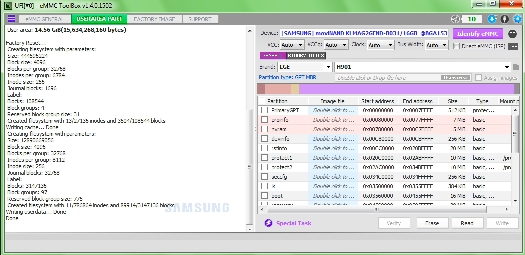

RPMB: 16384 KiB
Factory Reset...
Creating filesystem... Done.
Writing cache... Done.
Writing userdata... Done.
Done.
