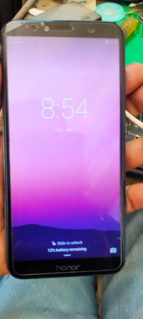

Honor 7A(AUM-L20) Always Fastboot Mode During Frp Remove By Other Technician Flashing Failed
Emmc Successfully Repaired Set Alive Done By Ufi-Box
Emmc Reprogram
Set Sucessfully Alive
Special Thank To My N Jerry'S Friend Mentor Kamal Singla N Dr. Sunil Singh For Help Me find Correct FW. Ver And For His Guide.
