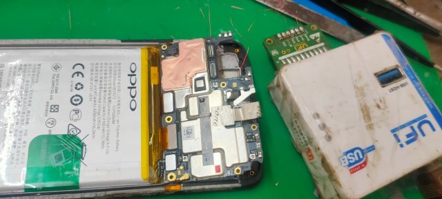

OPPO F7,A7,A1K PATTERN AND FRP DONE
OPPO CPH 1819 PATTERN DONE
Connection status: EHCI:HUB:HUB:USB 2.00 High-Speed
Interface: UFI High-Speed
Serial number: 0011-8841-0169
Boot version: 1.04, FW version: 1.13 (Aug 19 2019 23:46:09)
Insertion test... Done
VCCQ not properly connected
Init bus...
VCC: 3.3 V, VCCQ: 1.8 V
Bus: 1 bit (SDR 4MHz)
Access mode: sector mode
Product name: DH6DMB (0x444836444d42), rev: 0x05, serial number: 0xB8066A03
Manufacturing date: Oct 2017
CID: 15010044 4836444D 4205B806 6A03A46C
CSD: D0270132 0F5903FF F6DBFFEF 8E40400C
EXT_CSD revision: 1.8 (MMC v5.1)
Partition info:
Boot1: 4096 KiB
Boot2: 4096 KiB
RPMB: 4096 KiB
User area: 58.24 GiB(62,537,072,640 bytes)
[Oppo] MasterClear [1]... Done

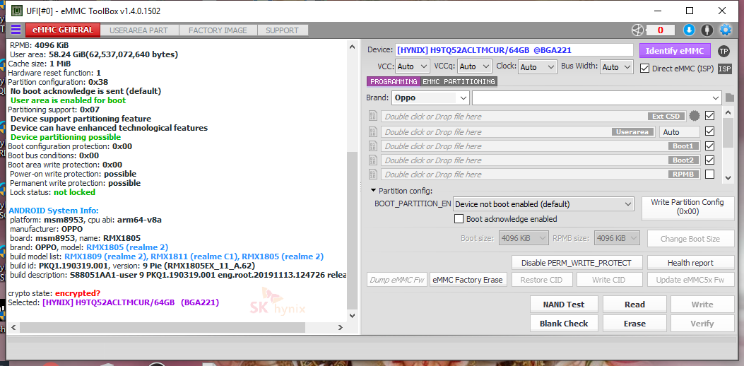

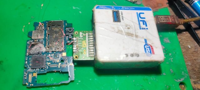

OPPOCPH 1901 PATTERN AND FRP DONE
Init bus...
Product name: RH64AB (0x524836344142), rev: 0x05, serial number: 0xA12E9B7F
Manufacturing date: Dec 2018
CID: 15010052 48363441 4205A12E 9B7FC5E6
Partition info:
Boot1: 4096 KiB
Boot2: 4096 KiB
RPMB: 4096 KiB
Cache size: 64 MiB
Hardware reset function: 1
Partition configuration: 0x38
No boot acknowledge is sent (default)
User area is enabled for boot
Partitioning support: 0x07
Device support partitioning feature
Device can have enhanced technological features
Device partitioning possible
Boot configuration protection: 0x00
Boot bus conditions: 0x00
Boot area write protection: 0x00
Power-on write protection: possible
Permanent write protection: possible
Lock status: not locked
EXT_CSD backup saved to "\\%BACKUPS%\RH64AB_A12E9B7F.ext_csd"
ANDROID System Info:
platform: msm8953, cpu abi: arm64-v8a
manufacturer: OPPO
board: msm8953, name: CPH1901
brand: OPPO, model: CPH1901 (OPPO A7)
build model list: CPH1901 (OPPO A7)
build id: OPM1.171019.026, version: 9 Pie (CPH1901EX_11_A.10)
build description: msm8953_64-user 8.1.0 OPM1.171019.026 eng.root.20190823.123130 release-keys
crypto state: encrypted?
Custom moviNAND command is not supported for this device(MMC51).
Selected: [SAMSUNG] KMRH60014A-B614/64GB (BGA221)

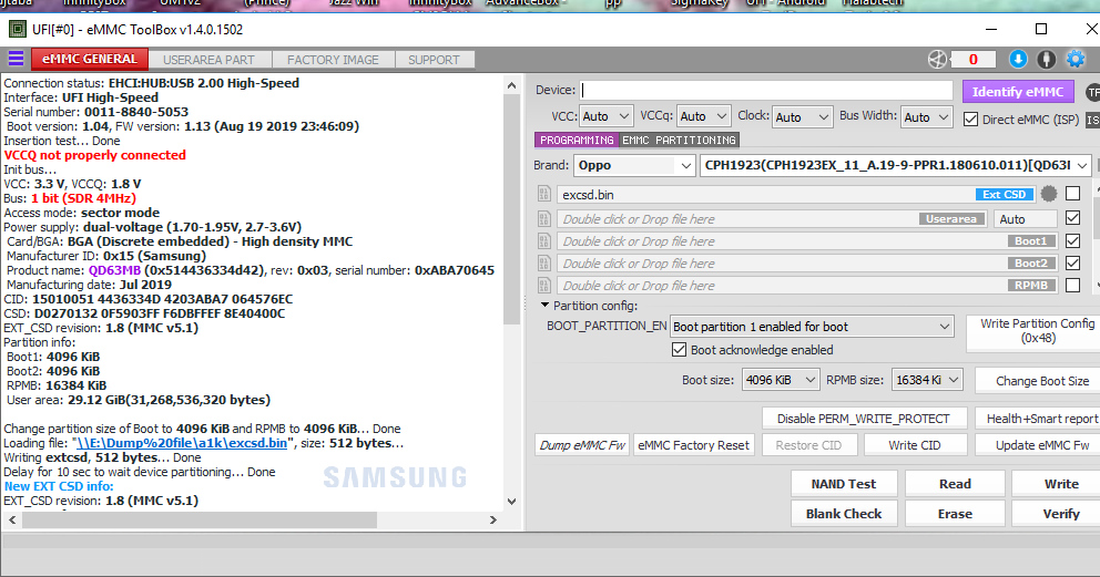

hello team, i have problem with ufi plz help when i connect mtk chipset mobile to ufi android toolbox then it take driver but stuck only on connecting brom plz help and reply its urgent
